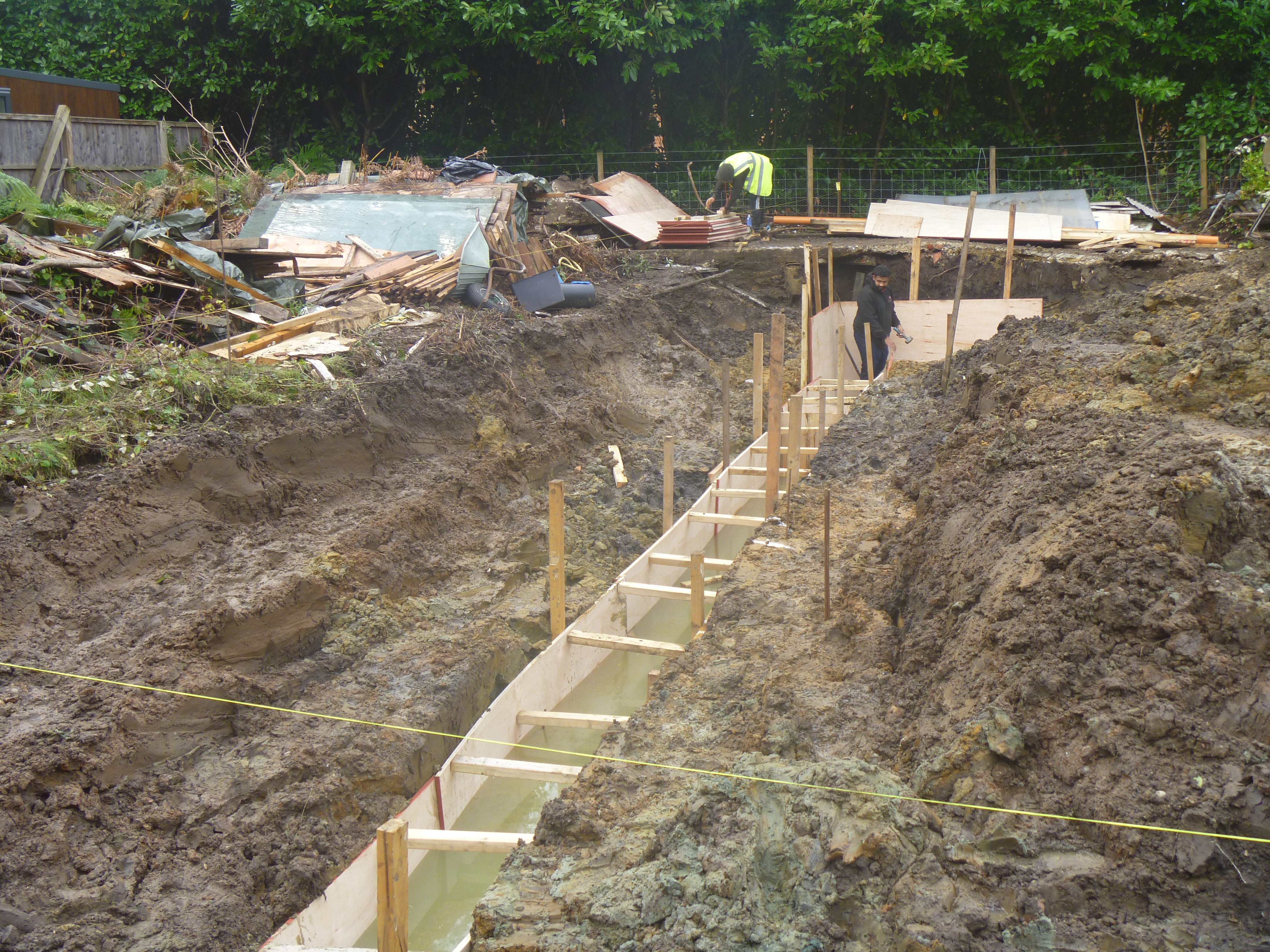

Tony L Posted October 15, 2024 Share Posted October 15, 2024 @Alan Ambrose you asked me to report back when we started to dig the trench foundations. Just to recap, we have a high water table. I did some research - it's usually at its lowest during the first week in October, so I booked the groundworks team. Then we had the wettest September I can remember. We dug some test holes a while back & the BCO came for a look & told us we'd need 1M deep trenches. This is what had been specified on the new build right next door to us. We were expecting to have to shutter the trenches to prevent them collapsing between the dig & the pour. A different BCO came to inspect the trenches once we'd started digging. He told us he wanted to see 2M. Due to the ground conditions, this work has been very much more difficult than digging 1M trenches. As the pictures show, I don't have a nice, neat 60cm wide trench describing the outline of my house. The reclaimed boards I'd collected to deal with the shuttering were deemed too weak to risk using for these ground conditions. OSB (as they used next door) would also be too weak, so the pictures show lots of very expensive plywood, & 2 x 4 braces (these won't be left in). The water you see in the pictures is being pumped - if the pump is off overnight, it's up over the boards the next day. Link to comment Share on other sites More sharing options...

ProDave Posted October 15, 2024 Share Posted October 15, 2024 We have a seasonal high water table, Mid summer perhaps June or July is the driest. I would never have thought of digging in September let alone October. We were about 1.5 metre without shuttering but needed a pump to keep the water out. BCO inspection and pour same day. Link to comment Share on other sites More sharing options...
saveasteading Posted October 16, 2024 Share Posted October 16, 2024 Why did the bco want 2m after the original spec was 1m? Thanks fof the report. Is it going to be OK, or are there any queries? Link to comment Share on other sites More sharing options...
Alan Ambrose Posted October 16, 2024 Share Posted October 16, 2024 @Tony L Thanks for that - that does look a bit tricky - but congrats on handling the problem. How big a pump did you need? I've been talking to some basement guys (Keller) over the past few weeks, and they said they don't mind clay as the inflow of water is normally fairly slow, unlike sand. >>> I did some research - it's usually at its lowest during the first week in October That's interesting - did you find some stats somewhere? Link to comment Share on other sites More sharing options...
Tony L Posted October 16, 2024 Author Share Posted October 16, 2024 4 hours ago, saveasteading said: Why did the bco want 2m after the original spec was 1m? Thanks fof the report. Is it going to be OK, or are there any queries? The BCO who'd inspected our 2M test holes was away, so his colleague came along & he had a different view. One option would have been to stop work & initiate a protracted argument with BC, but my builder decided to do as he was told, & I'm happy with his decision. Our next inspection is due tomorrow - LA BCO wants to check everything immediately before the concrete is poured on Friday. I think it will be OK. The warranty inspector doesn't want to come again until he can see DPC. 1 Link to comment Share on other sites More sharing options...

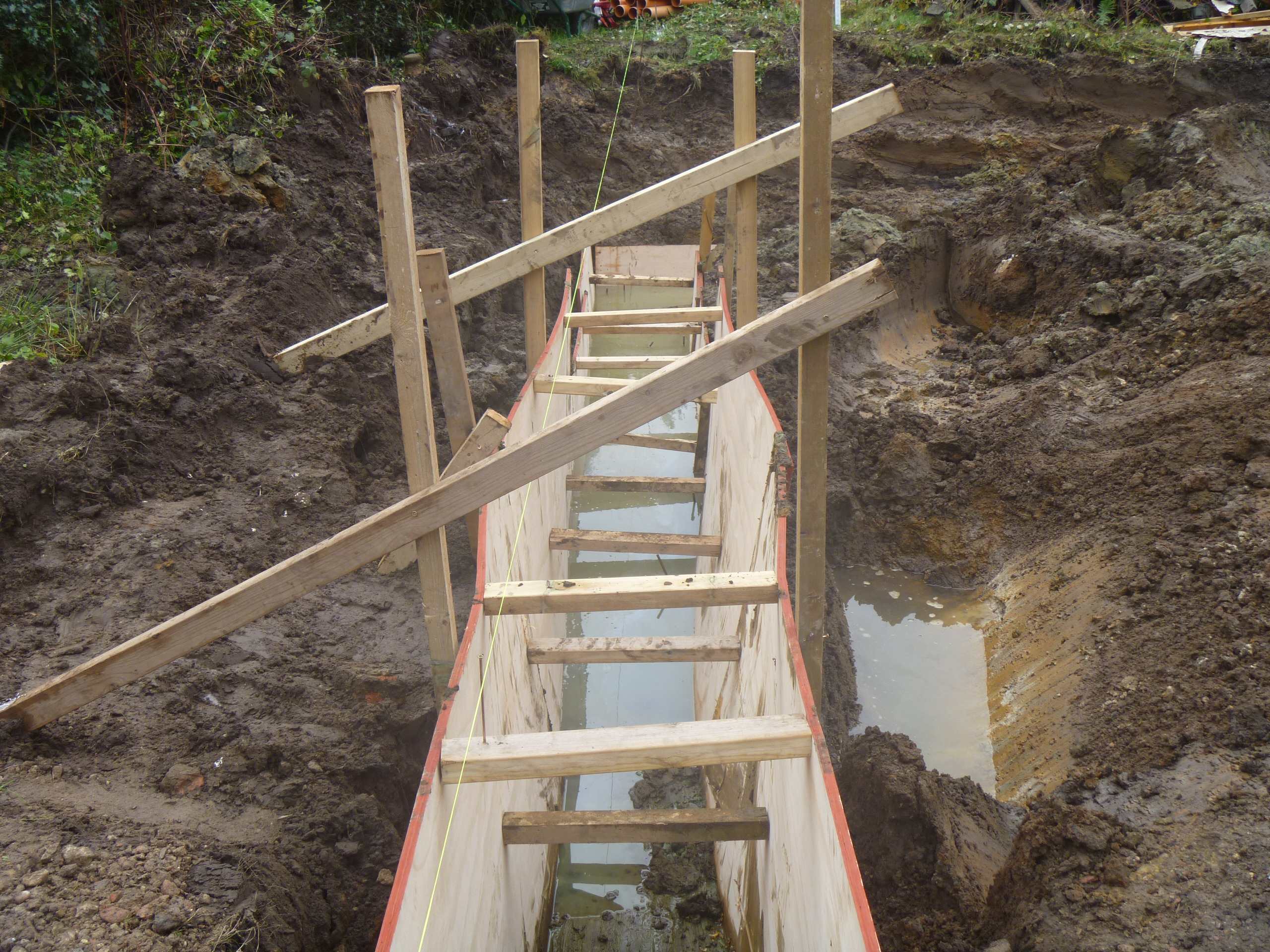

saveasteading Posted October 16, 2024 Share Posted October 16, 2024 It doesn't seem that you need advice. But just in case. It's usually best to dig slightly short as it will get muddy and maybe soft and have to come out. So let bco tell you to take out 50mm more down to 2m. Plus it's OK to pour concrete into a wet trench but it must flow not splash. It will push the remaining water to the end and can be bailed out. Otherwise it mixes and a wet mix is a bad thing. 1 Link to comment Share on other sites More sharing options...
Tony L Posted October 16, 2024 Author Share Posted October 16, 2024 3 hours ago, Alan Ambrose said: @Tony L Thanks for that - that does look a bit tricky - but congrats on handling the problem. How big a pump did you need? I've been talking to some basement guys (Keller) over the past few weeks, and they said they don't mind clay as the inflow of water is normally fairly slow, unlike sand. >>> I did some research - it's usually at its lowest during the first week in October That's interesting - did you find some stats somewhere? I don't know the spec' of the builder's pump that's being used. It's small - it would fit in a regular sized builder's bucket. I bought a similar (slightly smaller) dirty water pump from ebay for about £20, to keep my test holes dry when we dug them - it just sat in a bucket with a few holes drilled in the sides (so it wasn't in the mud). If I'd been managing the dig myself, which was the original plan, I was going to look out for another couple of pumps the same, to be sure I had enough pumping power. If you get them used from ebay you can likely sell them without loss, once the job's done. If you buy a second hand pump, make sure it comes with the hose. Yes, I found stat's & graphs with water table heights for my area. Sorry, I'm too busy to try to find these again now. I should have made an allowance for the recent climate change effect & got organised to start in August. It looks like the warmer, wetter winters that climate change scientists were promising us for the UK 15 or so years ago are with us now. Link to comment Share on other sites More sharing options...
Tony L Posted October 16, 2024 Author Share Posted October 16, 2024 11 minutes ago, saveasteading said: It doesn't seem that you need advice. But just in case. It's usually best to dig slightly short as it will get muddy and maybe soft and have to come out. So let bco tell you to take out 50mm more down to 2m. Plus it's OK to pour concrete into a wet trench but it must flow not splash. It will push the remaining water to the end and can be bailed out. Otherwise it mixes and a wet mix is a bad thing. Thanks for this. I need as much advice as I can get really - I'm a total novice. Fortunately, I have full confidence in my builder & his team. I wish I could say they same about the Arch Tech, who's turning my design into proper drawings. I think they're going to pump the trenches as dry as possible before they pour so they can get all the battens out - some of these are below the level of where the concrete's going. I didn't ask, but I guess the builder decided that on some sections, the pegs that are holding the bottom of the plywood in place aren't strong enough to last several days on their own. 1 Link to comment Share on other sites More sharing options...
saveasteading Posted October 16, 2024 Share Posted October 16, 2024 2 hours ago, Tony L said: have full confidence in my builder & his team. Great to hear. Who pays for the extra work and concrete? Ask away. 1 Link to comment Share on other sites More sharing options...
Tony L Posted October 16, 2024 Author Share Posted October 16, 2024 I pay, because the quote I accepted was based on 1M trenches & me supplying all the wood for the shuttering (which I did, but the builder said it was too risky to use my old reclaimed ply & OSB). Fortunately, the spec' on the poured concrete hasn't changed - it's still 600 wide & 600 deep, but there's an extra metre of block work to go on top now, & a lot of extra muck away. I'll report back once I have the bill for the additional work. 1 Link to comment Share on other sites More sharing options...

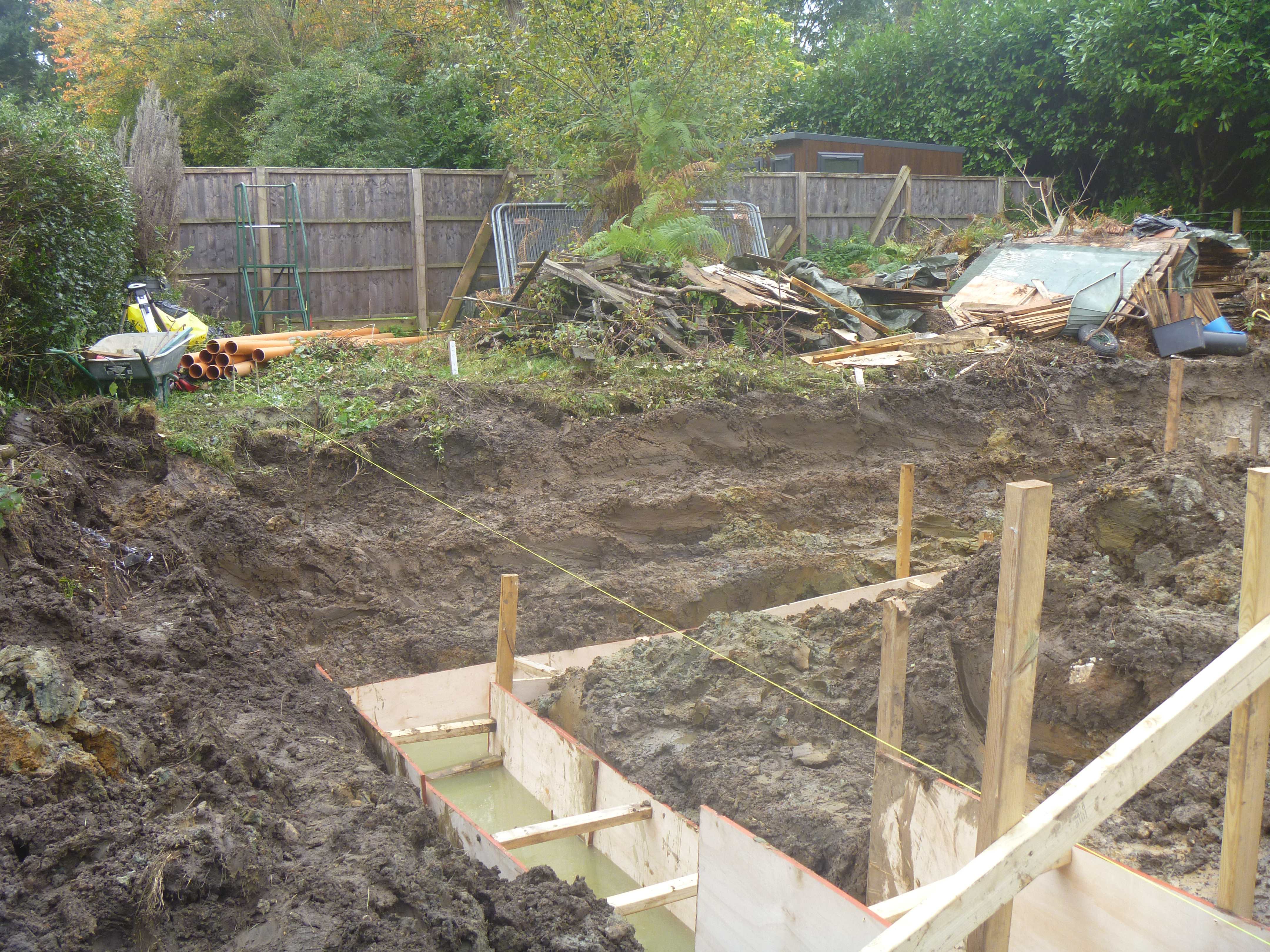

Iceverge Posted November 18, 2024 Share Posted November 18, 2024 (edited) I looked at the first picture you posted and held my head in my hands. In a different world you might be able to just lock the site gate and come back in 6 months,or a year, or two years when conditions were favourable. Alas impractical with all the paperwork following building . Another option would be to park the shovels and design some easier to build foundations like piles with a ringbeam or such. However we are where we are etc..... Before trying to pin your builder to the wall with emails maybe try to climb into his boots for a second. Take him to a nice cafe somewhere, on the clock, buy some buns, and have a grown up discussion. Importantly, listen to him. I know it's frustrating to see the budget and schedule slipping but I think it's the ground eating it. Not your builder. Resist for now the temptation to bolster the moral of men, up to their knees in sh*t, with dictatorial emails. Edited November 18, 2024 by Iceverge 2 1 Link to comment Share on other sites More sharing options...
