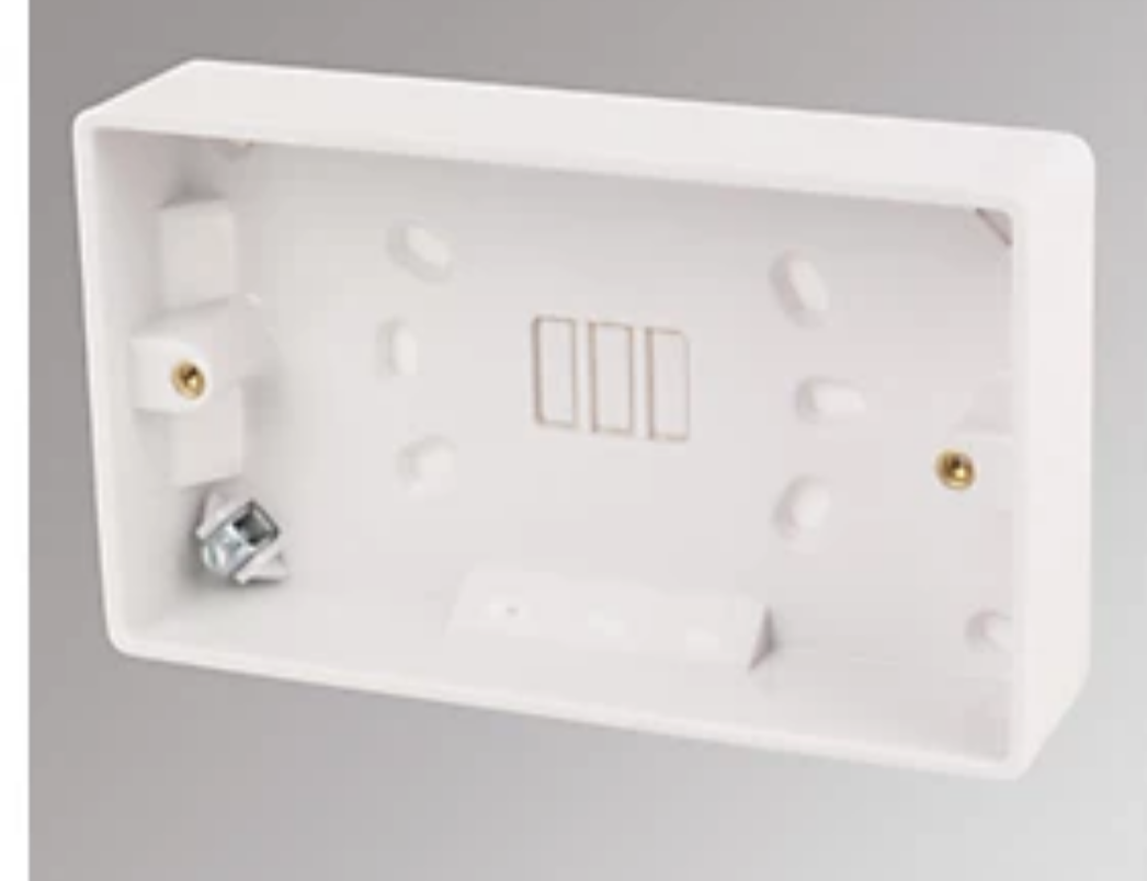

I'm using some Screwfix surface mounted pattress boxes to add some sockets to a ring main in the garage.  These are they.
The manufacturer data that came with them says to use rubber grommets for the knockouts. But LAP don't make any such grommets and I've not idea how they would fit to the knockouts for flat cable.
Any thoughts on these?  Are they a regs requirement?  Could I just fill the 1mm gaps around the cable with silicon or another filler?  I think the plastic is far weaker than outer insulation on 2.5 t&e so I can't see abrasion being a big
issue.
I've never fitted grommets to that type. Just knock out and file down any sharp edges.
If they are round knockouts, you could use a stuffing gland for cable entry.
Far cleaner looking, and at least helps the ip rating

They're these:
Hilarious that the LAP instructions say to use rubber grommets. LAP btw are a Kingfisher (they own Screwfix), own brand.

Absolutely despise these patresses.
Crumbly sharp cable entry points, the slightest knock and they crack.. Even mounting on an uneven surface and tightening the screws can cause them to implode!

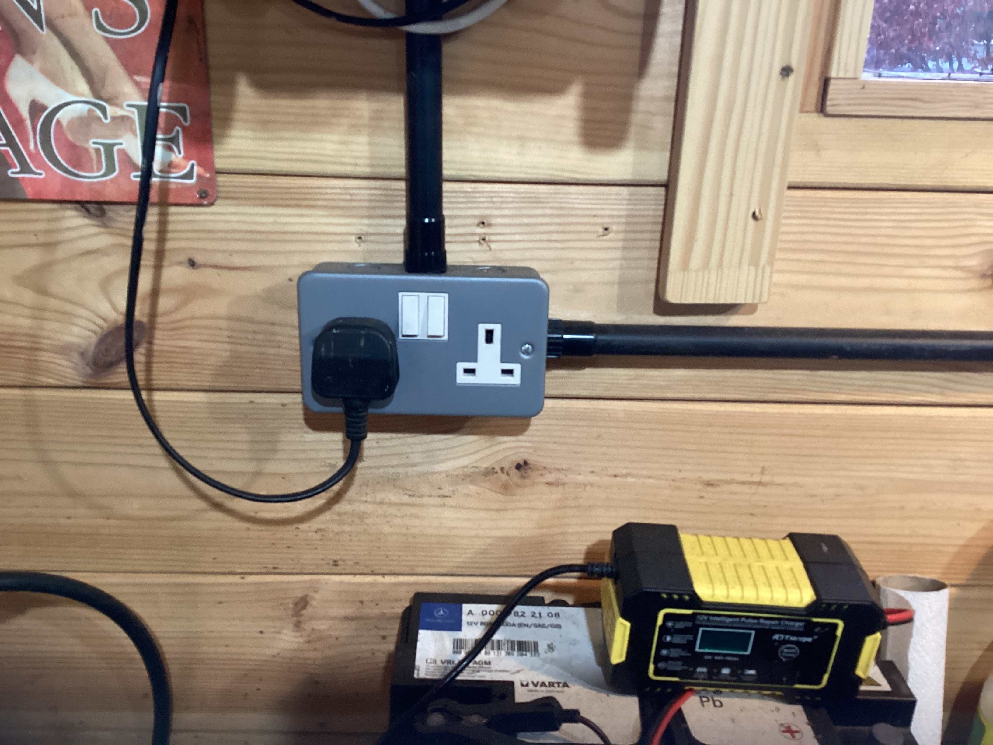

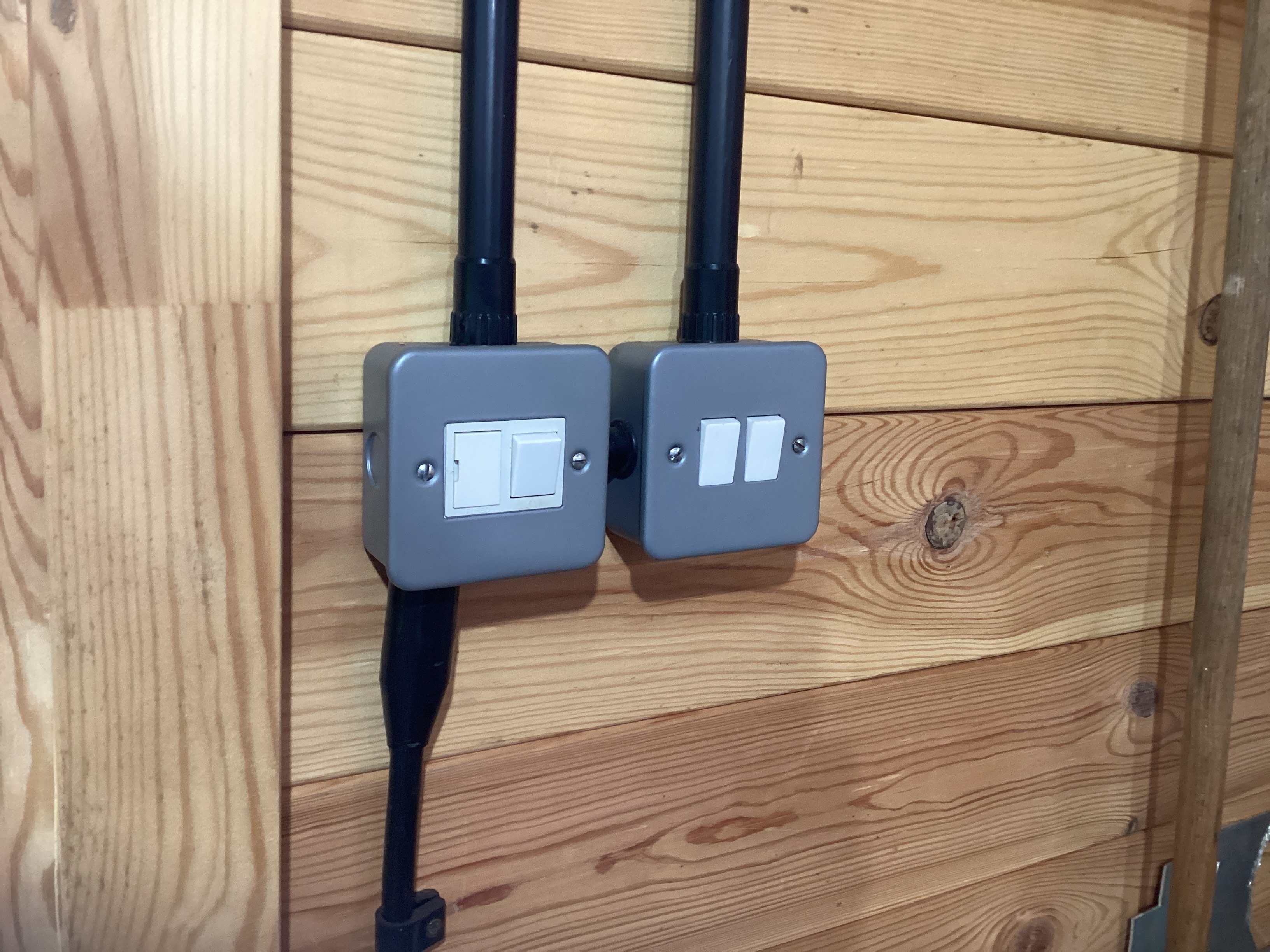

Personally and in my garage I use metal back boxes and plastic conduit to at least head height, some might say it’s OTT but it looks so much neater… 🤷‍♂️
very neat @joe90.
in my garage the sockets are on the roof joists as the walls are all taken up with racking.  wiring is stapled to the joists or through the air (above head height) when traversing.
