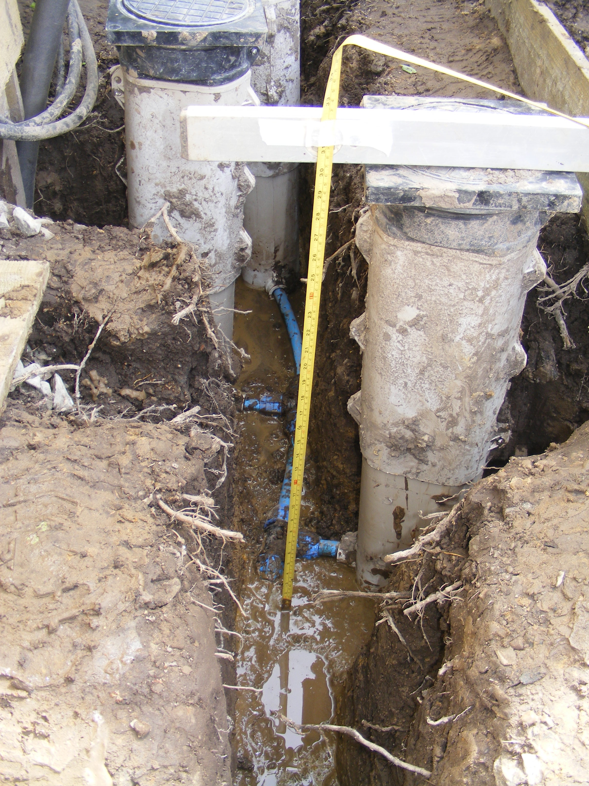

Weebles Posted November 9, 2017 Posted November 9, 2017 Stupid question alert. We have finally located our water supply (without breaking through it with a digger bucket ) and hope to get some advice on how to run a temporary and then permanent supply. We will be living in the current house still for a few months so need to keep a supply to the house. We need a temporary supply directly to our caravan and outside loo for the duration of the build. We will also need to provide access to water for the build (some sort of tap set up?). The meter / stopcock is not at the boundary (over the other side of the road). We have located the pipe at the boundary. Can we turn the meter off, cut the water pipe, install some sort of three way connector in to take the supply in different directions and then, when we knock the main house down, cap off the bit of the pipe that serves the house? Firstly, is this in any way a sensible thought? If not, what do you suggest? If it is, are we allowed to do it or do we have to notify Thames Water and pay them to do it?
ProDave Posted November 9, 2017 Posted November 9, 2017 Buy a boundry box or 3 (known as a Toby up here) Cut into your pipe under your land and use one or more. I used three, one to feed the stand pipe for building water, one to feed the static caravan and one to feed to the house.

PeterW Posted November 9, 2017 Posted November 9, 2017 I’ve just re-read the first post - this pipe only supplies your house ..?? If that is the case then it may be classed as a supply pipe, so it will be your responsibility. I would speak to your insurer to check that its covered under your insurance as that could be very costly to repair. You can install your own boundary boxes, just make sure that the one to the new house has the straightest run and isn’t going off on one of the tees.
Weebles Posted November 9, 2017 Author Posted November 9, 2017 Yes, just supplies our house. Our assumption too is that it is the supply pipe and that it is our responsibility. We don't want to get into a situation where we need to repair it, at least not through building our house. Sounds like boundary boxes on our land are the answer to our temporary and permanent supply issues, connecting them in to the pipework from under the road? That way we don't dig up the road. Now need to check if pipework is lead. If so, I guess we might have to / want to replace the supply pipe back to the boundary box (with the meter in it) and that will involve digging up the road......everything we look at opens up a can of worms, expensive ones.....
Weebles Posted November 9, 2017 Author Posted November 9, 2017 Last question (still probably a daft one, sorry).....if we run the water pipe in blue 32mm MDPE to our new build, can that pipe go under (or in?) the passive slab foundation (we are an MBC client) and come up in the right place or does it have to go around the foundations and into the house through a wall? Thanks
Russell griffiths Posted November 9, 2017 Posted November 9, 2017 It can go up through the slab, but will need putting in a duct to enable it to be replaced if the need arises. I would run it around the house and only under the slab at the point it needs to enter the building. You will probably bring it up in your plant room or whatever room you are having all your water and mechanical wizardry in.
