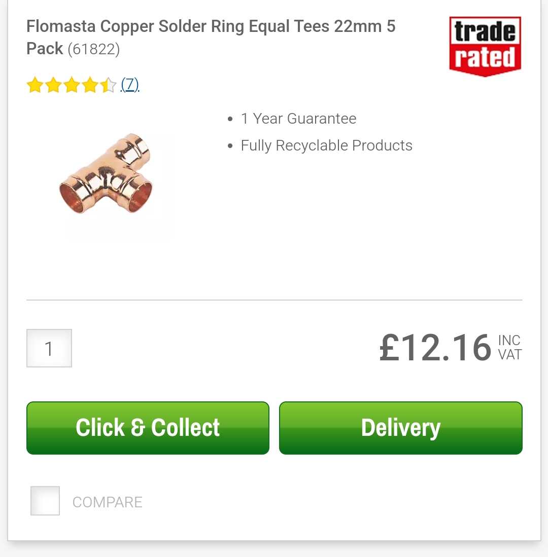

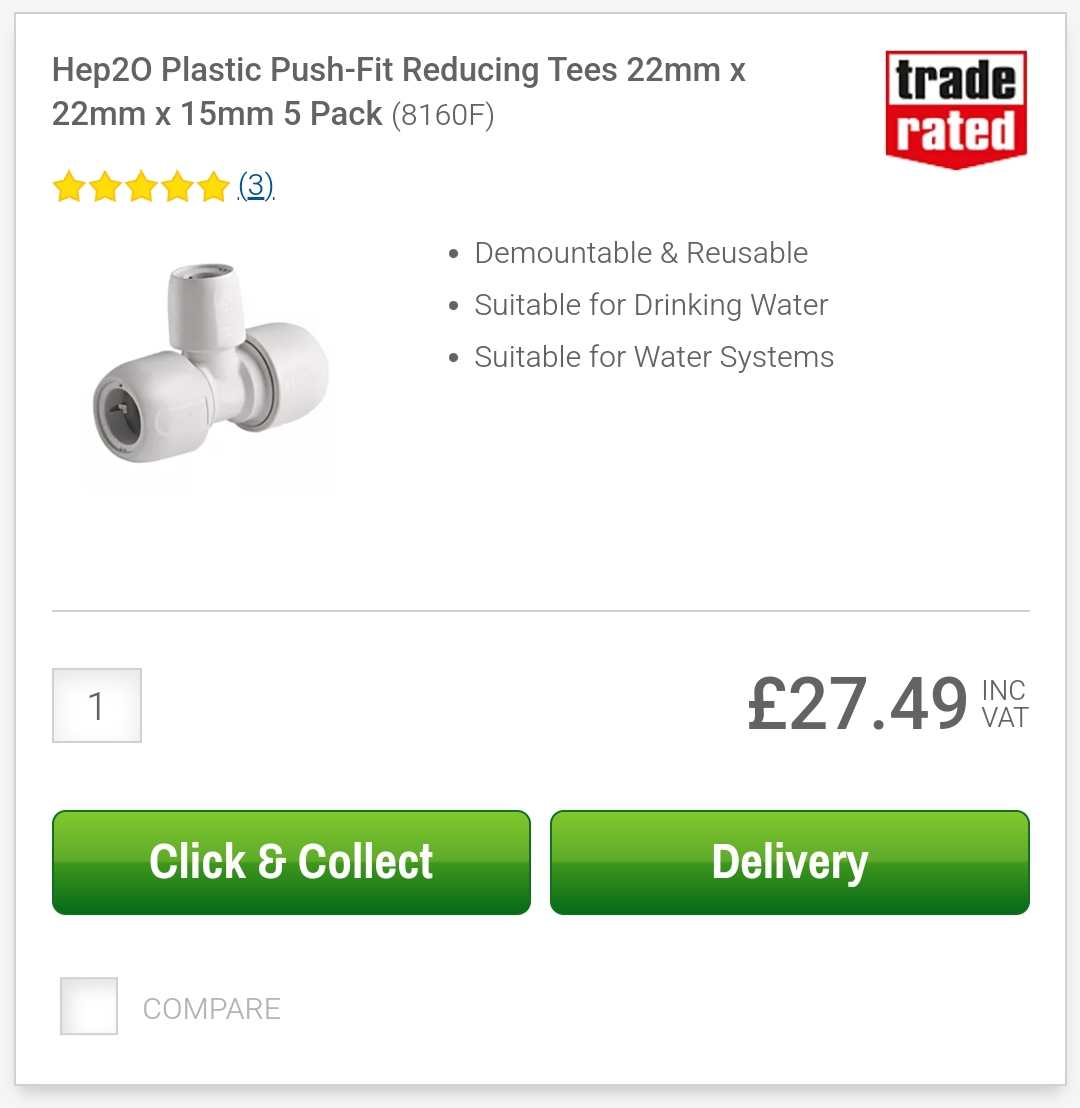

The fact the fittings are double the price would have a lot to do with it.
