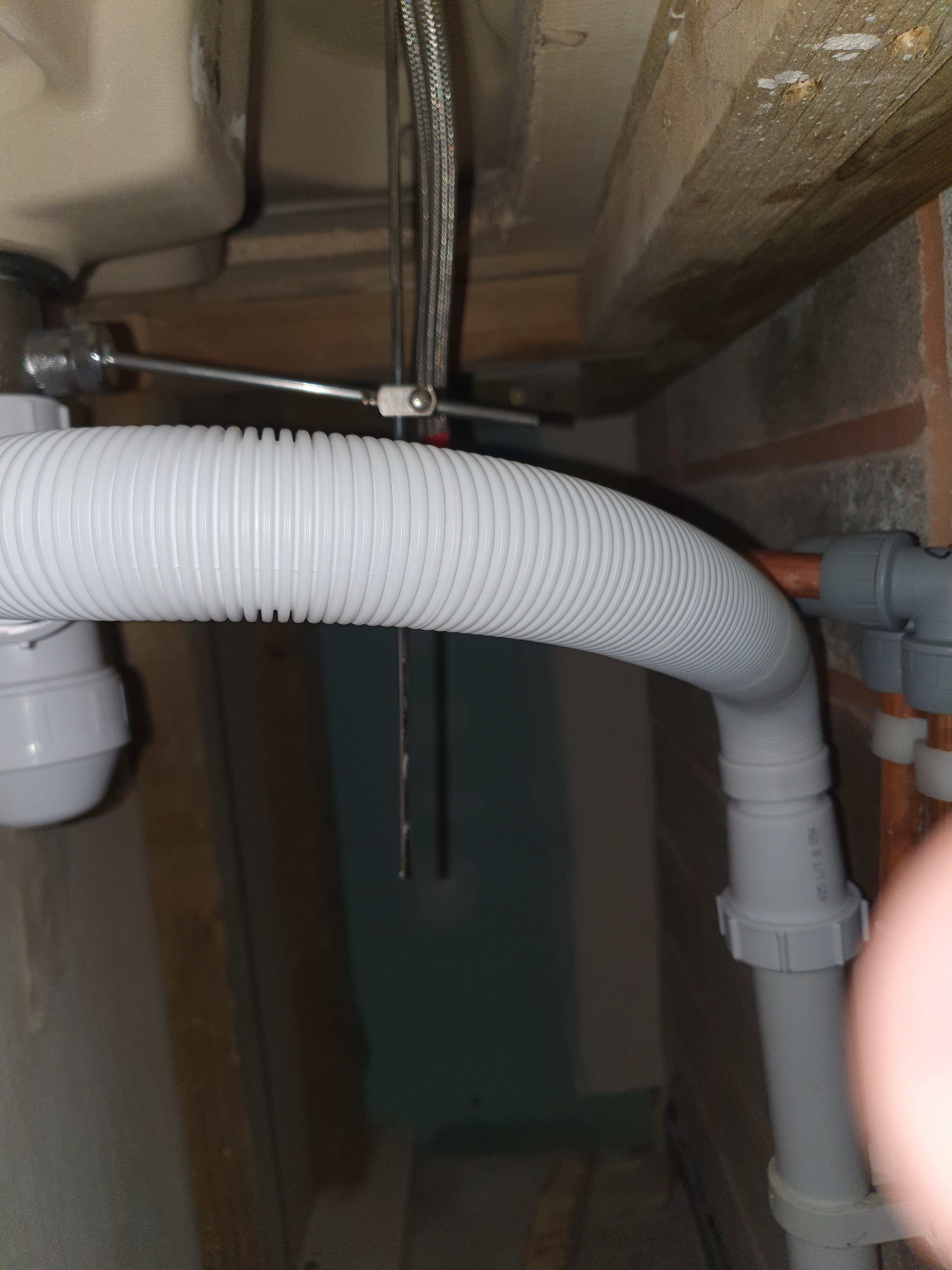

Tom Posted October 1, 2024 Posted October 1, 2024 Our plumber has just about finished now, and was today making the final connections to taps, sink etc. I've just been round to have a look and am disappointed to see he's used flexible connectors for the wastes in the en suite and bathroom. Am I right to think this is a bodge?
ProDave Posted October 1, 2024 Posted October 1, 2024 It would not be my choice, neither would those plastic pipe fittings be. What did you agree with him before hand?
Mike Posted October 1, 2024 Posted October 1, 2024 It's not how I'd do it, but based on my previously mentioned hotel experience, there were plenty of problems with flexible tap connectors, but none with flexible wastes, so I'd not be too concerned.
Jenki Posted October 1, 2024 Posted October 1, 2024 1 hour ago, Tom said: Our plumber has just about finished now, and was today making the final connections to taps, sink etc. I've just been round to have a look and am disappointed to see he's used flexible connectors for the wastes in the en suite and bathroom. Am I right to think this is a bodge? My concern would be that with hot water and time the flexible pipe will sag. Is the pipe solvent weld? Sometimes with refurbs you need to use these, but I would want to support it, in this situation.
Tom Posted October 1, 2024 Author Posted October 1, 2024 3 hours ago, ProDave said: What did you agree with him before hand? Certainly didn't agree that he wouldn't use flexi pipes, but then again you'd assume that any decent plumber would use materials suitable to the job. Access is a bit tight but with a bit of time and effort I'm sure he could fit a proper waste. Agree re the push-fit elbows too. FFS, as ever two steps forwards, one step back.
Russell griffiths Posted October 2, 2024 Posted October 2, 2024 Is that a drop on sink in that he can’t get behind there when the sink is in position, if that’s the case he’s going to struggle to get in there, isn’t he.
Tom Posted October 2, 2024 Author Posted October 2, 2024 Yep. They're semi-recessed. There are access panels though (photo above taken through one of them). Just spoken to him and he says access is just too tight - but concedes could be done if given enough time, but doesn't sound like he's willing to change them.
Russell griffiths Posted October 2, 2024 Posted October 2, 2024 I agree it’s a bit of a bodge but it’s because it’s been poorly planned. The waste coming up should have been closer to the access panel end so he could reach in and make the connection.
