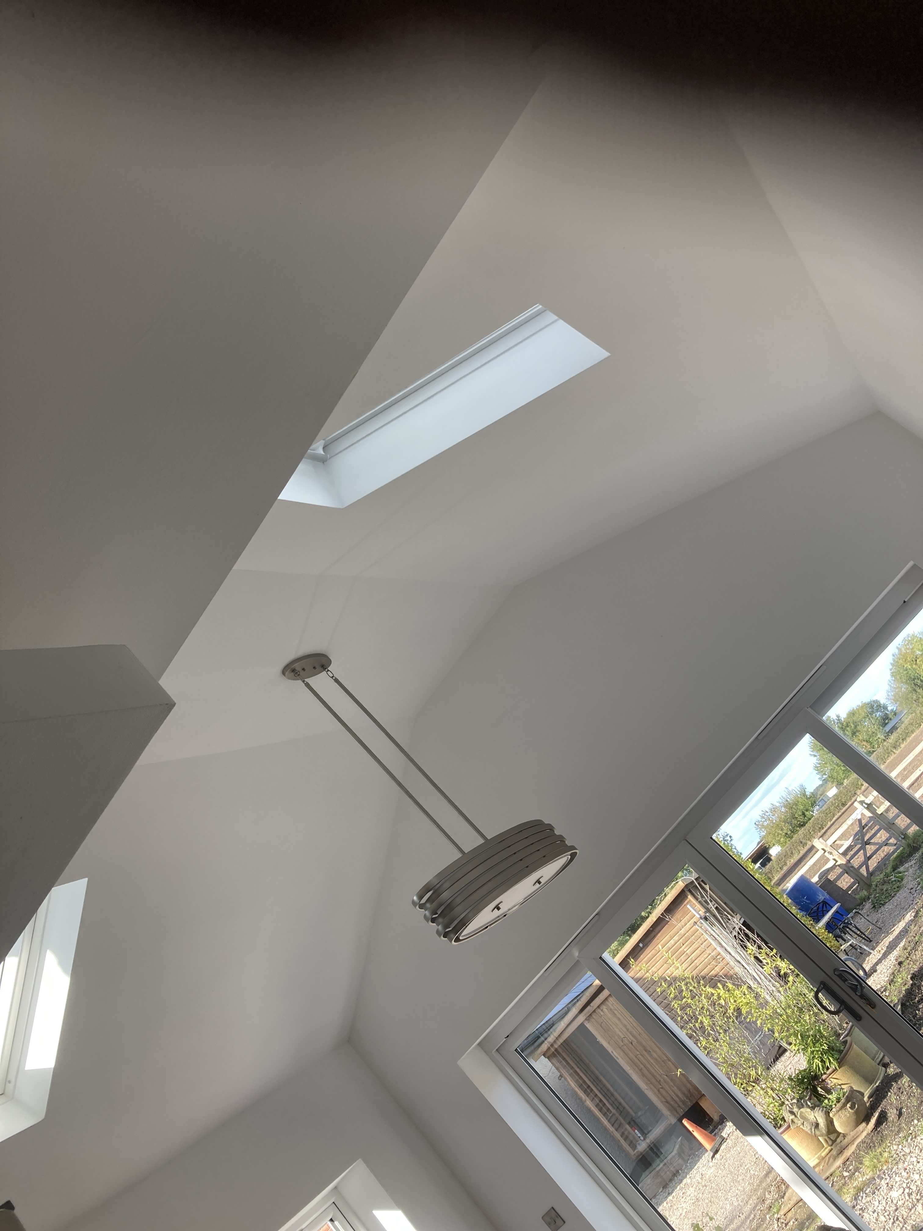

Bournbrook Posted September 27, 2024 Posted September 27, 2024 Hi all. Some advice needed. We currently have PP for a new dwelling in our garden. Currently we have a pitched roof which creates a vaulted space above the room below. The architect specified solar panels on that roof, but since talking to the renewables company, it seems as though there isn't much point given the amount it would produce vs cost. That means we would like to add a rooflight instead. It is on a pitched roof (39 degrees) and would be about 2.5-3m above ground level. It is on the side of the house and so would face our neighbours garden. Planning have said this would not be considered a NMA and we would need to go back to planning. I really want to avoid this for a variety of reasons, so am looking at fitting it retrospectively once all signed off. Most of the info I have found says they can be only fitted on a side-facing roof slope with obscure glazing. This seems crazy given it's in a ceiling. Does anyone have any experience of whether this is the case, when it's in a vaulted ceiling? thanks
Temp Posted September 27, 2024 Posted September 27, 2024 Quote b) any upper-floor window located in a wall or roof slope forming a side elevation of the dwellinghouse shall be - (i) obscure-glazed, and (ii) non-opening unless the parts of the window which can be opened are more than 1.7 metres above the floor of the room in which the window is installed This condition requires upper-floor windows in any part of the side of a house to be obscure glazed. Glazing to provide privacy is normally rated on a scale of 1-5, with 5 providing the most privacy. To be permitted development, side windows should be obscure glazed to minimum of level 3. Obscure glazing does not include one-way glass. Source https://www.gov.uk/government/publications/permitted-development-rights-for-householders-technical-guidance So unfortunately you are correct, it must be obscured to level 3. How well do you get on with the neighbours? If they are happy I would just risk installing clear glass if that's what you want. The planners are very unlikely to come check once the original build is complete. 1

DevilDamo Posted September 27, 2024 Posted September 27, 2024 As the bottom of the opening will be above 1.7m, it doesn’t need to be fixed shut or obscured. And there should be no reason why the LPA cannot treat it as a NMA. I’d like to see their reasons for thinking otherwise.

Temp Posted September 28, 2024 Posted September 28, 2024 16 hours ago, DevilDamo said: As the bottom of the opening will be above 1.7m, it doesn’t need to be fixed shut or obscured. And there should be no reason why the LPA cannot treat it as a NMA. I’d like to see their reasons for thinking otherwise. Unfortunately that's not what the tech guidance says. It doesn't need to be fixed shut but it does need to be obscured.
Temp Posted September 28, 2024 Posted September 28, 2024 One option would be to fit clear glass and some sort of obscure film. At least then if the neighbours move you can peal it off. 1

joe90 Posted September 28, 2024 Posted September 28, 2024 (edited) Conditions C.2 Development is permitted by Class C subject to the condition that any window located on a roof slope forming a side elevation of the dwellinghouse shall be: (a) obscure-glazed; and (b) non-opening unless the parts of the window which can be opened are more than 1.7 metres above the floor of the room in which the window is installed So yes, not PD unless a and b above, which in my mind is bonkers (unless there is a site line into a neighbours house !!,!). 2 hours ago, Temp said: One option would be to fit clear glass and some sort of obscure film. This would be my choice, you have abided of the rules (but can peel it off later,) if the neighbours can’t see it how can they complain, and if they do and planning get involved (which will take forever) say it fell off and I will get some more guv. https://www.amazon.co.uk/vgoltd-Frosted-Adhesive-Privacy-Bathroom/dp/ Edited September 28, 2024 by joe90 1
