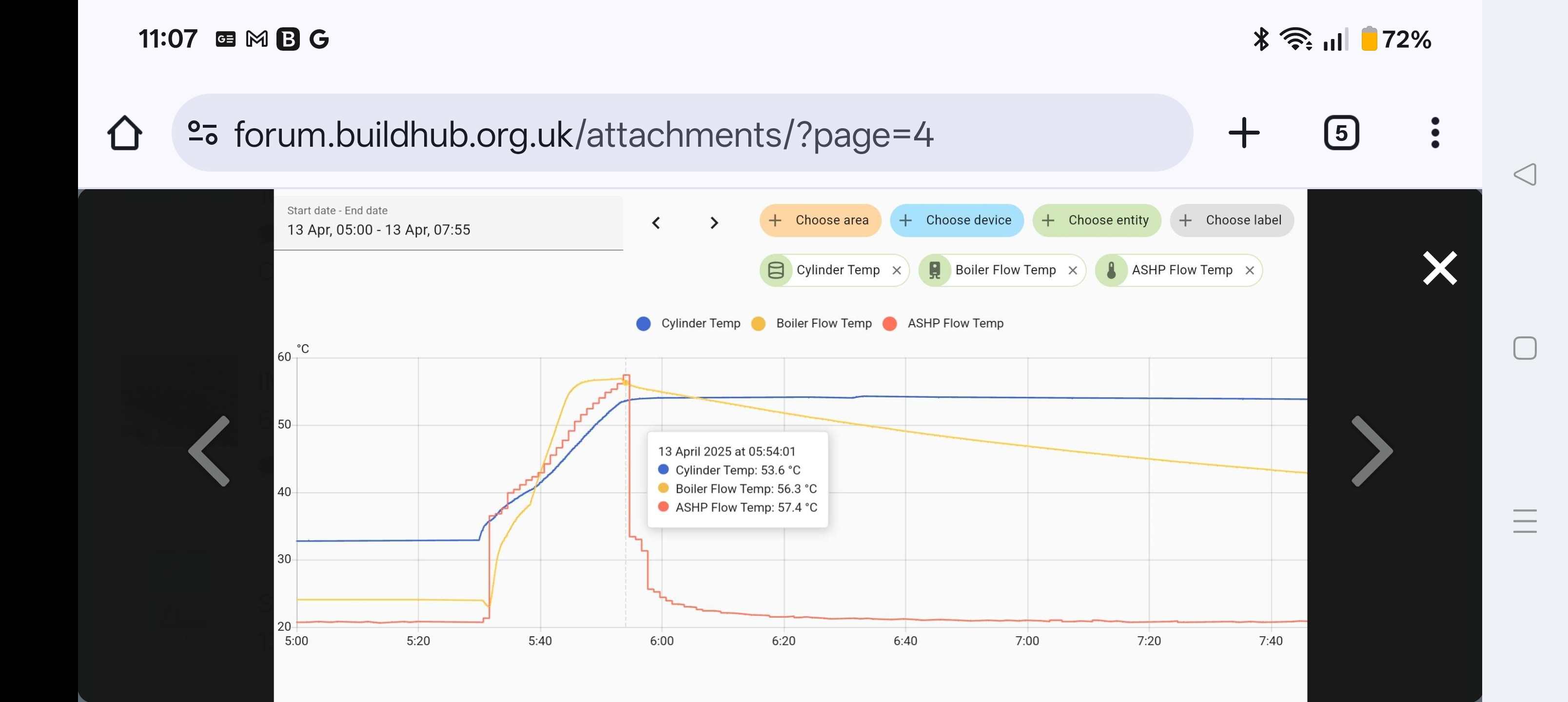

Posted
Just found a trend I posted on another thread
Screenshot_2025-08-09-11-07-01-70_40deb401b9ffe8e1df2f1cc5ba480b12.thumb.jpg.95380f438b3b78bc5044991b454c334b.jpg
For clarity the boiler and heat pump were running, the boiler sat behind a plate exchanger and added heat to the ASHP flow. ASHP on its own takes nearly twice as long to heat cylinder.

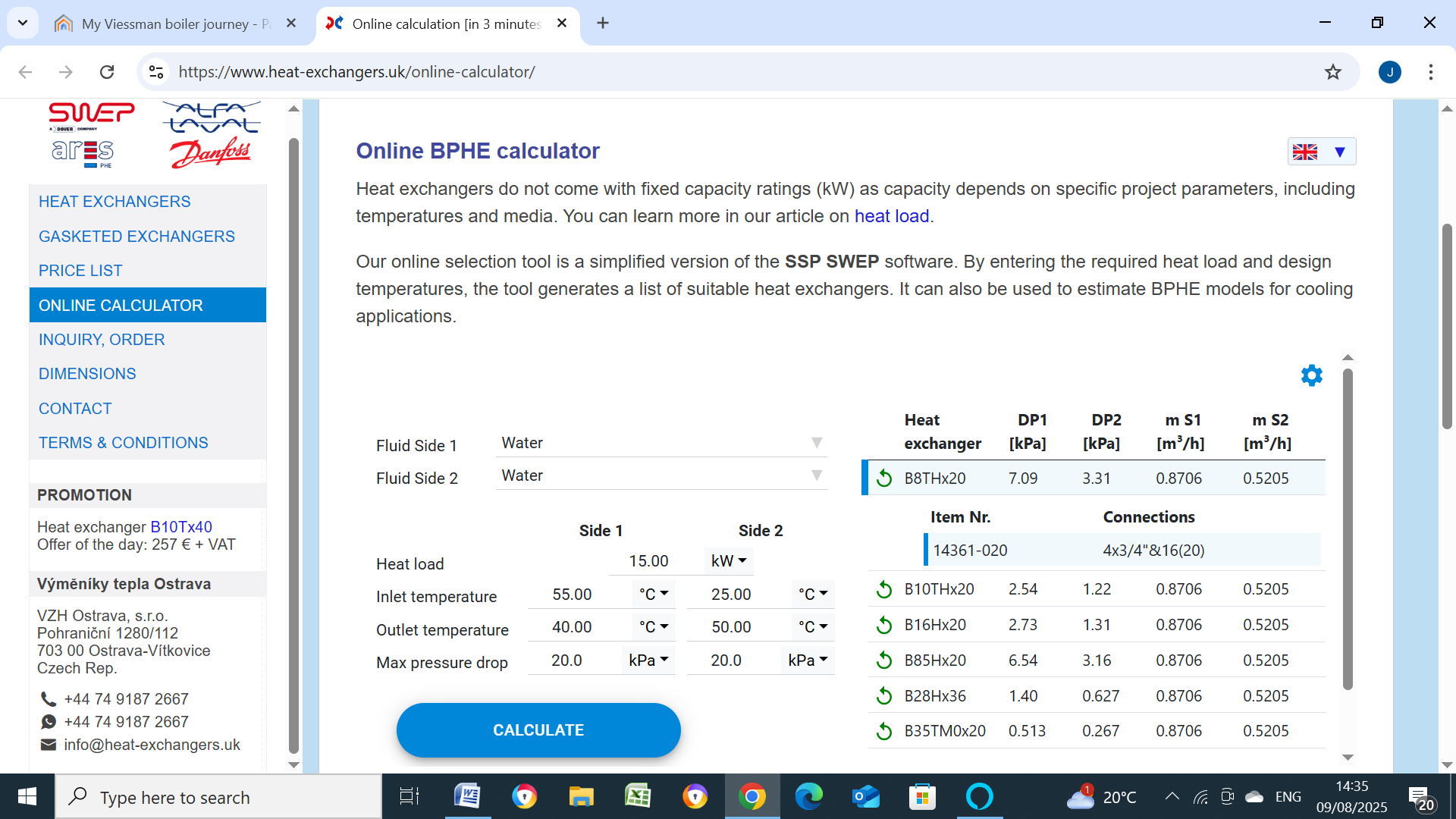

5 hours ago, marshian said:
Ideal world I’d like to achieve flow temp of less than 55 deg C and a target tank temp of 50 deg C with 115 litres of water at 25 deg C heated in a maximum of 30 mins max with one boiler cycle (ie it fires once and runs till stat satisfied - not cycle several times to achieve the target)
In that case above, then a B8X20, almost 0.5m2, will output a minimum of 15kW with boiler flow/return temps of 55C/40C at a boiler flowrate of only 14.5LPM/0.87M3/hr & secondary side inlet/outlet temps of 25C/50C at a flowrate of 8.7LPM/0.52M3/hr, to heat 115L from 25C to 50C in 25 minutes assuming the cylinder stat is located just above the cylinder outlet to the PHEX inlet.

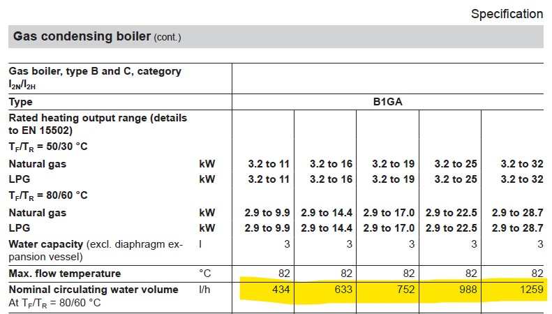

I went back to the manual - I'd made the assumption that the boiler flow rate requirement would be at peak output and running a 16kW boiler range rated to 6 kW I could comfortably run at 0.4 to 0.5 m3/Hr
I dislike system noise so really want to run the pump on the slowest speed but it looks like the boiler likes a little more flow.
Early days but I really hope that's resolved the niggle - I might range rate it back to minimum and see if the issue comes back

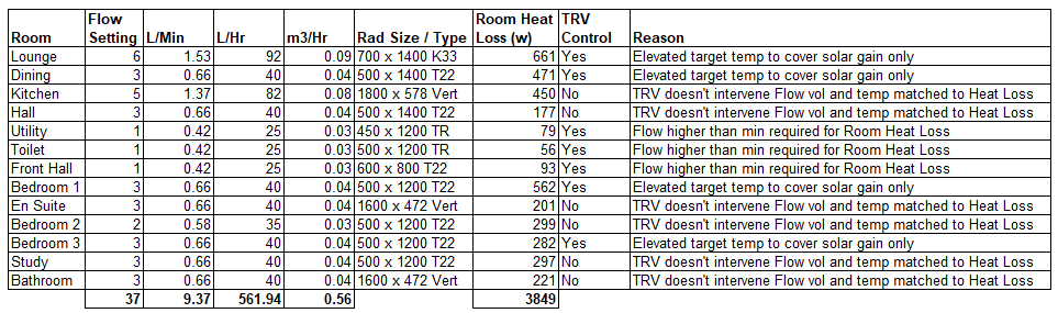

I have 13 Rads all with TRV's in the house table below explains what they are room sizes Heat loss at -2.5 Deg C OAT and how they are set up (Because there are issues with getting the flow rate low enough for some rads and solar gain with some rooms)
I regard the circuit as well balanced both upstairs and downstairs
I have a pressure relief by-pass but it's fully closed as the circuit never shrinks enough to need it.

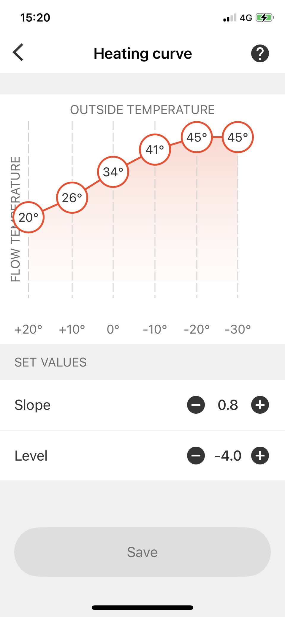

System noise is absent and I've been able to make a small tweak to the WC curve (slope and level) now running a slope of 0.6 and a level of -2.0
So
20 at 20 Deg OAT
25 at 10 Deg OAT
31 at 0 Deg OAT
37 at -10 Deg OAT
The niggle with the boiler remains but I've removed the range rating and I'm letting the boiler do what it wants.

Just an update on the RAS-B2 TRV bodies
I used the Danfoss installer app to get the base line settings but over the first week I tweaked them from the suggested to get the rooms to where I want then to be.
Vertical rads need more flow than suggested (no convector fins I think is the main reason).
I've not had to adjust them since and room temps are rock solid and the DT on the rads are all between 5 and 7 deg.
Pump output is also rock solid at 0.6 m3/hr
Absolute game changer I reckon - the Wiser EB4 bodies were good and I've been happy with then for a few years but the adjustment range was too coarse from 1-3 (I ended up using a setting along side a tweak on the lockshield to get the flow rate right and this caused  a little system noise and I really dislike system noise - it's me I know but I want a quiet heating system)

He thinks I'm running the boiler with a far too narrow DT with 3 times the flow rate I could use if I increase the DT and suggested I target a DT at the boiler of 12 Deg rather than 6 Deg. He believes it will be more efficient with a larger DT.
So I did a repeat of my earlier condensate collection and efficiency calculation - 97.23% was the result pretty much identical to previous.
So I'll adjust all the flow rates thro the rads, tweak the Weather Compensation curve to target a higher flow temp (maybe 40 Deg C which should give me a return of 28 Deg C so not far off my current 32 F 26 R) and see if that makes any difference to the boiler behaviour.
Fundamentally the return temp drives the condensing efficiency improvement so I don't think it will make much difference.
I think it will possibly result in fewer cycles a day (currently 1 fire per hour plus a HW cycle a day) so 22 to 25 a day so boiler runs longer which may get a small benefit in terms of eff but my biggest concern is upping the flow temp target might result in a bit more creaking pipes - I remember how much they creaked every time the boiler fired on scheduled heating with higher flow temps and I like how little they do now.
