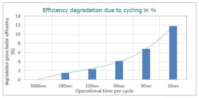

21 hours ago, John Carroll said:
If you can believe the below, then any run time of more than 3 minutes per cycle has a negligible effect on boiler efficiency.
Sorry meant to also say it does show that there is an impact on efficiency until 60 mins of run time (OK so it's the outer edge of a bell curve) IMO it's still over 1% (but less than 2%) loss at a 3 min run time which is why I like to set the system up to minimise cycling as much as possibe
Honeywell don't pay much attention to these findings since their Evohome continuously cycles the boiler and even smart roomstats with TPI? control do similar.
It's a conversation being carried out elsewhere on here - Smart is not always "smart" sometimes it's pretty (expletive deleted)ing dumb
Is that running Opentherm or on/off?
Not sure how accurate that graph is in real terms. Believe it covers the boiler in isolation from a full system. System effects on efficiency are very different depending on system volume and type of heating (radiators, fan coils or UFH). When you fire up a boiler you have to heat the boiler metal work, interconnected pipes, the water within, then the radiators or floor, before any useful work is actually completed.
A boiler running in a small loop, doing no useful work, my loose 12% efficiency on a 30 second run, but you wouldn't have a warm house, so real efficiency is zero.
Trouble with most on/off control, is most boilers run full load to get to set point ASAP, so a short run is just full load, then off, so you have zero chance of utilising part load modulation efficiency gains, which comes from prolonged running, or something like Opentherm telling the boiler to slow down work less hard.
Believe are also many differences in Opentherm on how hard it allows the boiler to run, Honeywell is run it hard to keep run time short, while Tado is run it slow and long - could be wrong?

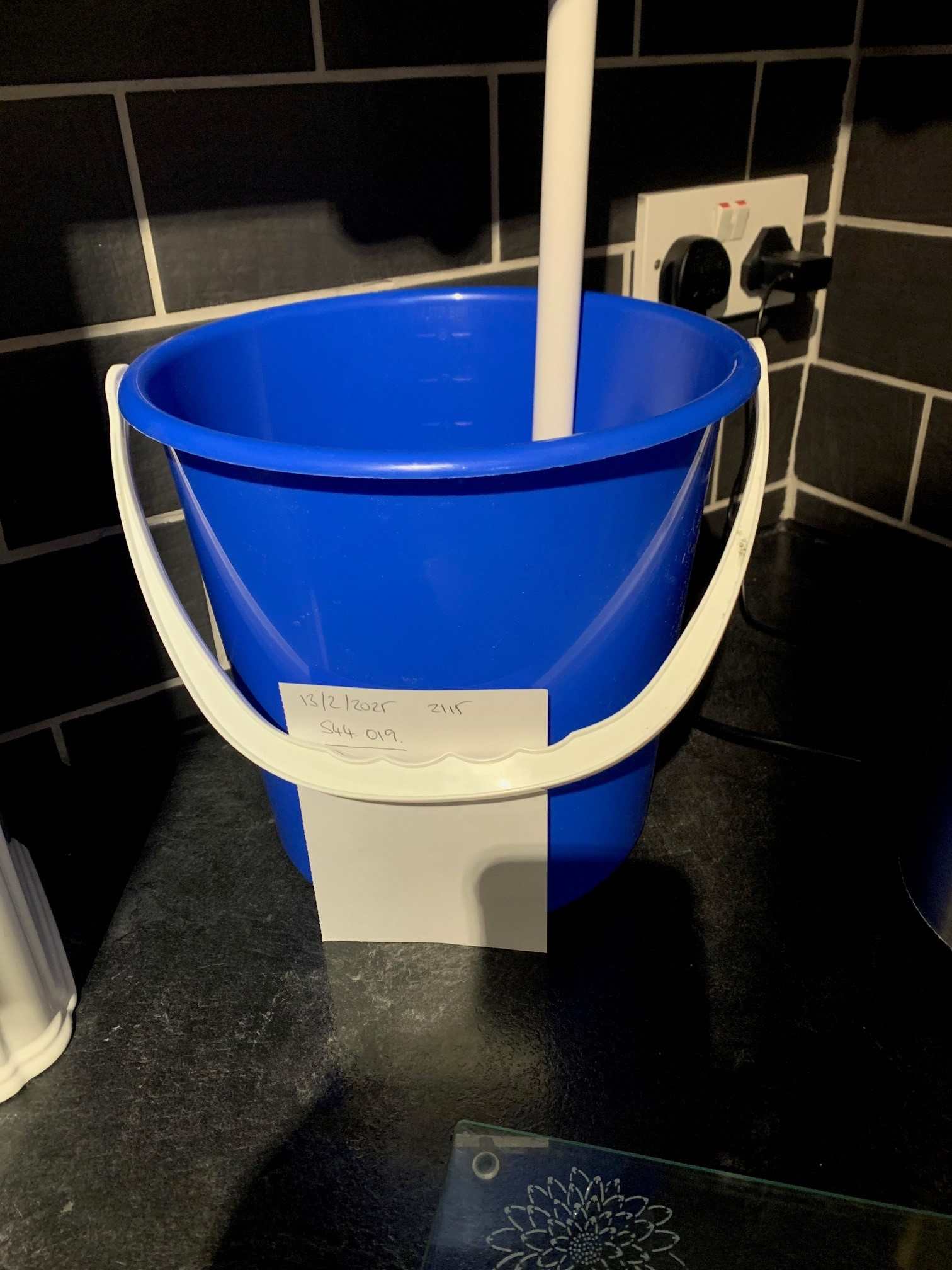

OK then I've done this
I was going to leave it overnight but in 60 mins of boiler running it's collected ~600 mls of condensate and I'm not 100% sure I'd be happy leaving it 8 hrs overnight
24 minutes ago, marshian said:
From this thread
Don't forget the gas meter readings, required to make any sort of calculation.
Meter reading at start 544.019 m3
Meter reading at end 544.439 m3
Condensate collected 612 grms
Boiler run time 67mins
Flow temp 30.5 to 33.6
Return temp 24 to 26.5
Avg kWh 4.66 kWh

Gas consumption, 0.42*11.0, 4.62kWh, condensate, 612/1000. 0.612L, condensate vol, 0.612/4.62, 0.13225L/kWh, condensing%, 0.13225/0.1595, 82.92% (using my figure of 0.1595L/kWh if fully condensing) and possible higher and even approaching 100% if my figure is a bit high.

I got very close to that with my workings but it's a mile away from the expected chart position based on a ~25 - 26 deg return temp
I am however bloody amazed at 612 grms of condensate in just over an hour running at close to min modulation

Based on my schoolboy chemistry, and assuming a density of Natural gas of around 0.8kg/m3 then I calculate that burning 0.42m3 of natural gas would produce 714g of condensate.

Ah well, this 79 yearold boy's chemistry isn't  that far out so, I use 11.0kWh/m3 and condensate of  0.1595L/kWh = 0.42*11*0.1595*1000, 738g, only 3% or so higher than the above.

But your boiler efficiency is still ~ 97% (as per graph, above), at say 30C fluegas temp, with a OAT of 4.1 C you are losing ~ ((30-4)/100)*4.5, 1.2% sensible heat to give 88.8% + the condensing effect, not quite the full 10% but by my calcs, 8.29%, to give a overall efficiency of, 88.8+8.29, 97.09%, TG it didn't come out at > 100%!!.
