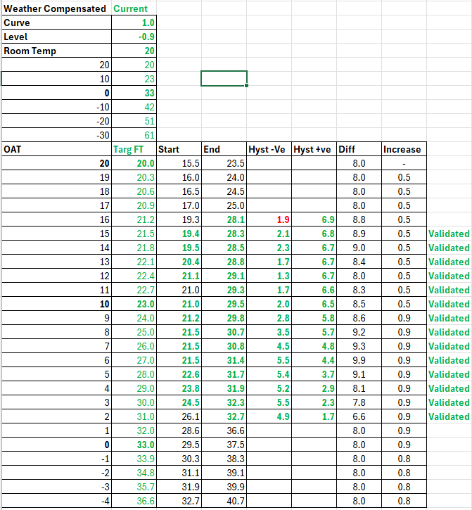

Table of start temp and shut down temp based on WC settings
Posted (edited)
At a OAT of 10C the Targettemp is 23C, the end temp is 29.5C, TT+ 6.5C
At a OAT 0f 2C   the Targettemp is 31C, the end temp is 32.7C,  TT+ 1.7C
At a OAT of 10C the burner shuts down at TT+6.5C, is this because its exceeded TT+5C?
At a OAT of   2C the burner shuts down at TT+1.7C, why?
Does the boiler (FT)ever run at the the TT??.

Posted
I think that the start up and shut down signal temps are different as OAT changes.
From collected data anyway (and it's remarkably repeatable - those aren't just one occasion but the average of multiple occasions)
Yes the boiler FT does run at the target temp until it no longer can due to influence from the return temp creeping up

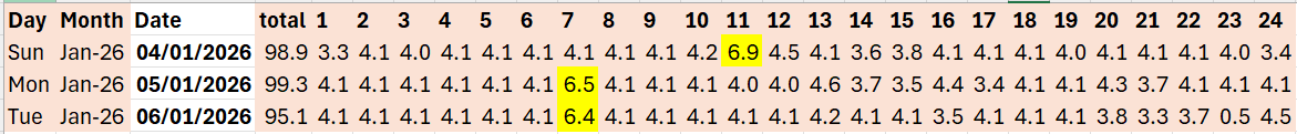

Gas usage in kWh for the three days by hour
Yellow marked cells are where it included 30 mins of HW at an elevated flow temp and modulation rate
At a 35 deg Flow temp the boiler is running at 4.05 to 4.1 kWh at min modulation
Posted
If the boiler is continuously running at 4.1kWh gas consumption and the output by my calc is 3.924kW then it adds up fairly well as this gives a boiler efficiency of 95.71%. You mentioned somewhere I think that you thought your boiler's  minimum output should be better as its not achieving its advertised figure of 3.2kW at 50C/30C, which means the gas consumption should be 3.2/0.9571, 3.343kWh?, what do you reckon is the minimum gas consumption when it starts cycling?
Yeah that aligns with my efficiency calcs based on Gas usage and Condensate collected over the same period
Running 35/29 I'm not expecting the boiler to meet the same claimed min output at 50/30 (or it's 2.9 kW at 80/60) I think 4kW is probably a realistic expectation and I'm OK with that.
Do you mean min gas consumption when
It ramps up (from min modulation)
or
It actually starts cycling because I don't have an issue with the boiler cycling
When the Avg OAT in winter are at or below 5 Deg C it cycles one an hour (24 cycles per day)
When the Avg OAT in Autumn or Spring are above 5 Deg C (but below 10 Deg C) the number of cycles per day jumps to High 30's
Once OAT gets above 10 Deg cycles per day are around 5 to 7 cycles
The bold above is where the boiler IMO miss-behaves (It's a characteristic according to the Viessmann Technical team)
