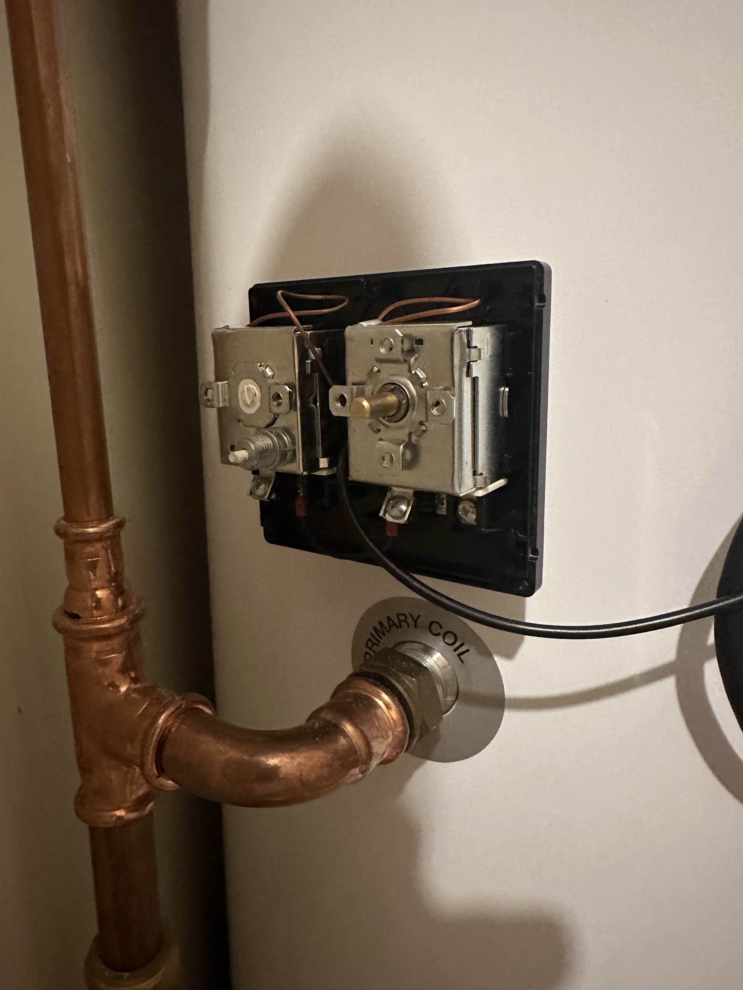

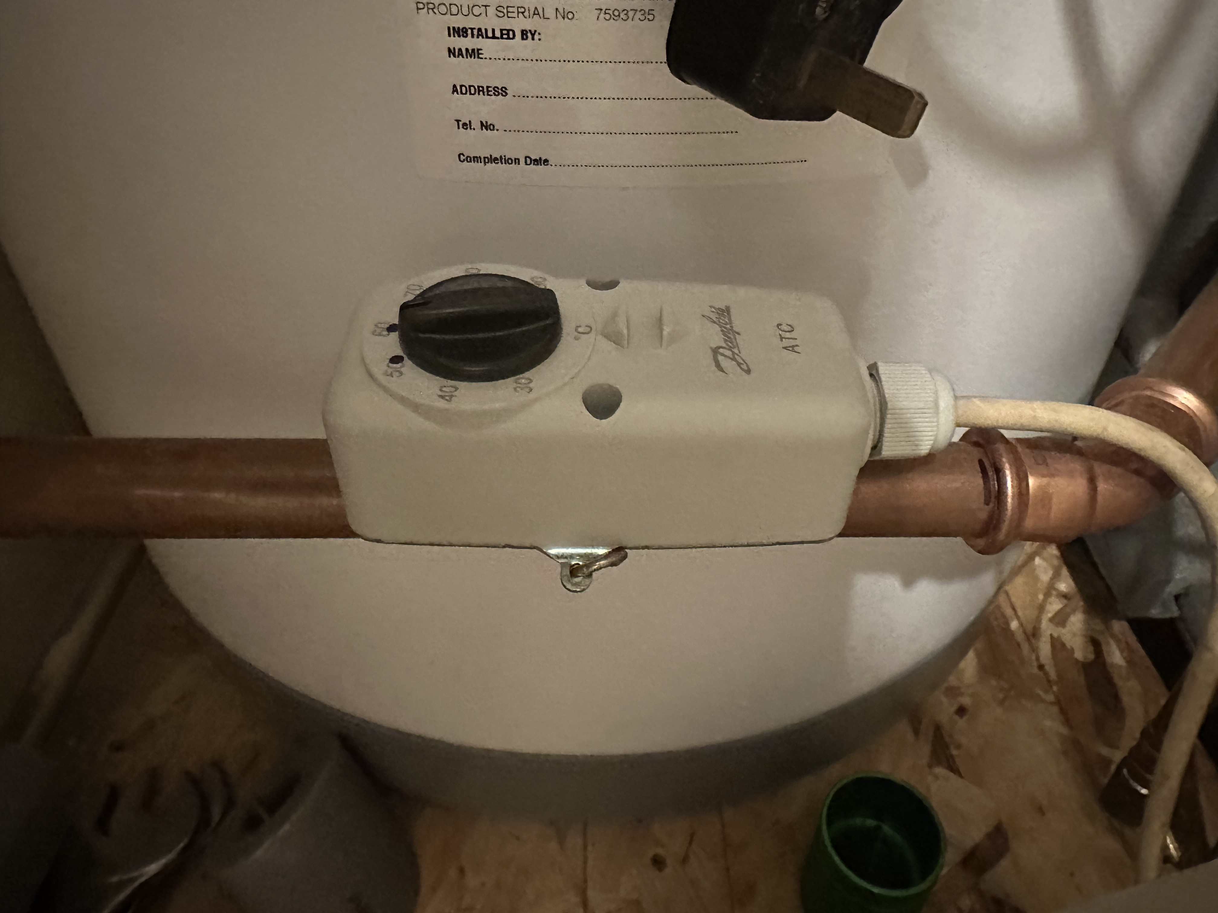

marshian Posted September 14 Author Posted September 14 Next job is to understand how to wire this into the system As a temporary upper limit safety measure I'm using the original tank stat as a pipestat on the coil return it's not resting there it's got a spring wire underneath to hold it on 🙂
JohnMo Posted September 15 Posted September 15 7 hours ago, marshian said: Next job is to understand how to wire this into the system The right is the thermostat and left is overheat protection required for an unvented cylinder - so you only need bother with the right hand side.
marshian Posted September 15 Author Posted September 15 3 hours ago, JohnMo said: The right is the thermostat and left is overheat protection required for an unvented cylinder - so you only need bother with the right hand side. Thank You - makes life a little simpler
