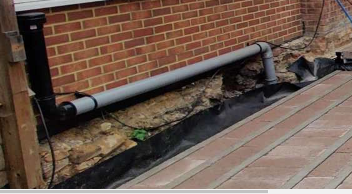

AdTee Posted September 14 Share Posted September 14 (edited) Hi folks, I really need some help on this one please! I've started building and I'm not sure how to progress. Apologies that I've posted recently on this subject (without reply, unfortunately) - I can't work out how to delete it. I wanted to share a few pics/ updated drawings in the hope that it might spark an idea or two. So, It's an end terrace, DIY stick-build timber frame extension, building off of a groundbeam (steels encased in concrete). Wall make-up to be as shown in first pic. THE BIG SNAG!... One side wall will sit 100mm from boundary with neighbour and 300mm from their conservatory. Due to a sloping site, finished floor level of half the extension will be 225mm below the bottom of neighbour's conservatory, (and bottom of the conservatory to base of my wall will be 550mm) - see pic/photo 2. Meaning, I need to back fill behind my new wall up to the bottom of their conservatory (fill of approx 200mm wide by 550mm high). I need an alternative to my standard TF at this point but can't fathom it out. The architectural tech had a look this week but isn't sure himself - we bashed out an idea but it's far from perfect, and I'm not even sure it will work (see pic 3). A builder friend (who admits to having little TF experience) came up with another idea (pic 4) but I'm not sure if this will work either. MAIN CONCERNS Drainage/Tanking/DPC's/moisture control/breathability, standing up a TF wall pre-clad and sheathed in cement board (weight/ & this wall also needs to be sealed up against the neighbour's rear brick extension which sits astride the boundary), and I only have the 300mm gap between their conservatory and my wall to get to it) I'm desperate for a solution as I need to start getting this frame built before the weather turns. Any help to get me on my way will be massively appreciated! Thanks in advance Ad Edited September 14 by AdTee Link to comment Share on other sites More sharing options...

AdTee Posted September 14 Author Share Posted September 14 2 minutes ago, G and J said: My apologies if I’ve misunderstood but aren’t you effectively building a partial basement without basement suitable methods? Ah I think I see what you mean, but the it's only the one wall alongside the conservatory that's the issue really, as the all the gardens slope down that way. It's a combination of the conservatory sat on made-up ground/rubble fill, and our side flattened out into two levels. Link to comment Share on other sites More sharing options...
G and J Posted September 14 Share Posted September 14 So you have already built a strip foundation designed to support the build up in your first diagram. And in effect you need a retaining wall outside of this to prevent bits of next door sliding towards you? Your second diagram seems to be using a block outer skin as a retaining wall. Doesn’t that mean your timber frame is a support for said retaining wall? If so that doesn’t sound like a good idea. In your shoes I’d pay an SE to design you a solution. I’d be too concerned at the risk of building something unsafe, or needing significant remedial work. 1 Link to comment Share on other sites More sharing options...
Mike Posted September 14 Share Posted September 14 I can't see an easy solution either. You don't want anything that relies on a gravel board to keep the soil away - it will fill up over time - and a 100mm thick retaining wall 500mm high seems inadequate. Theremoblock insn't intended to be used as a wall and the internal ledge would look odd. I'd also not use cement board cladding that close to the boundary due to the difficulty/impossibility of future maintenance (it's not going to be easy to install it in the first place either); since the houses are brick I'd want a brick external leaf, at least on that side. As @G and J suggests, you'll likely need a structural engineer to come up with something that will work with your foundations. Better to take a pause now and get it right, than build something that could cause problems in the future, not least when you eventually want to sell it, even if you can get it past Building Control. Link to comment Share on other sites More sharing options...

ProDave Posted September 15 Share Posted September 15 So just what is next doors conservatory sitting on? It looks like the remains of a dry stone wall or some rubble just piled up. Honestly that should have been sorted right at the start before you even laid your foundations. My suggestion is build some formwork and pour a concrete slab against all that rubble to stabilise it, but whatever you do it needs some prefessional input. Who's vent pipe and AAV is that? It will become inaccessible. Link to comment Share on other sites More sharing options...

AdTee Posted 3 hours ago Author Share Posted 3 hours ago Hi all, Following your help a couple of months back, I thought I'd update you on where I'm currently at with this! After myriad delays, the SE finally produced his solution last week: The wall in question will switch from timber frame to brick and block cavity, which will span the width of the ground beam. The gap between the new wall and the neighbour's conservatory (285mm in width) will be filled with concrete, blanketing the spill that is there (I'll remove the loose debris and cut it back where poss) up to the bottom of the conservatory (560mm height). The concrete will be laid with a fall away from my wall, and a channel of some kind will be formed to take water down towards the garden. The SE spec'd the wall cavity to also be filled with concrete up to the same height. He didn't make any suggestion for waterproofing, referring me to the BCO, who suggested using something like bituthene, and drew her idea (second pic) onto the engineer's drawing. Neither of them think that insulation will be necessary due to the mass of the wall, although personally I think I should go belt and braces and insulate somehow. I know it's far from ideal, but I think I have little alternative. I'd be really grateful for any ideas for waterproofing and insulation that you may have, please. If I can just get this wall design finalised and built in the next week or so, I'll be happy. I'm going to leave the timber framing until the spring when I can get a good run at it. Mahoosive thanks! 6154-SK02 Section 2-2.pdf Link to comment Share on other sites More sharing options...
