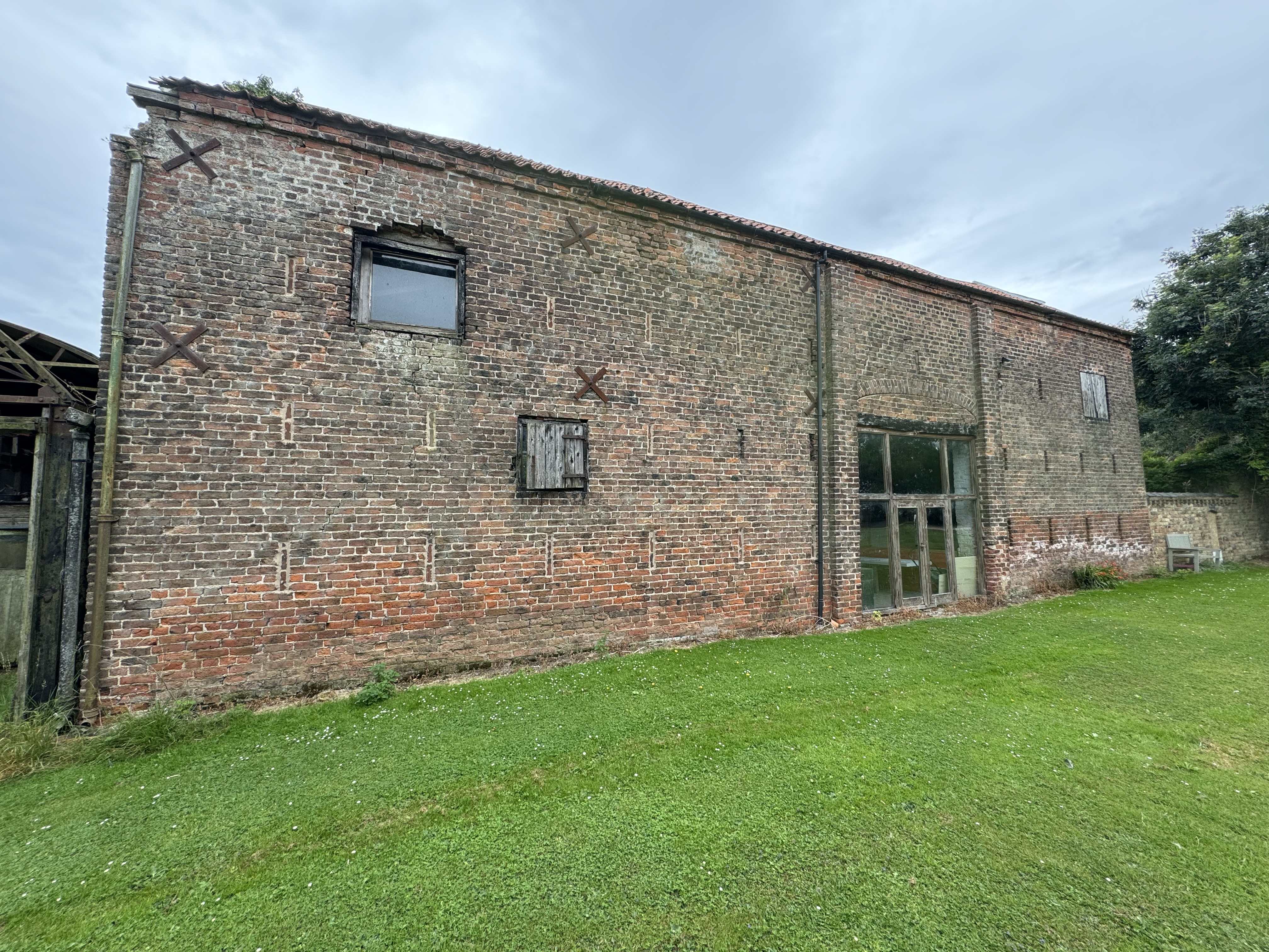

BadgerBodger Posted September 14, 2024 Author Posted September 14, 2024 1 hour ago, ToughButterCup said: Welcome. Please excuse the cheeky question - you do have Planning Permission don't you.... for a Listed building? You're a magician if you have. Go to the top of the class. @Pocster will award you a jammy dodger in due course. Yes, listed building consent and planning permission. The design has had to be extremely sympathetic to the surroundings (i.e no new openings and no out of character materials externally) and there is a measurable positive impact due to the proposed demolition of an adjacent agricultural building. In fairness I can thank my father and his partner for the work that has gone into that. It certainly didn’t come first time around and there was, how to phrase it, a significantly protracted review period. 26 minutes ago, Alan Ambrose said: Sounds a fantastic project. Welcome … and can we drool over a picture of it please? Sure, I don’t have many but here’s a teaser, there will be more due course!!! I’ll be back in a few weeks to meet some architects to tender for stage 4 so I’ll be taking some then. 3
Alan Ambrose Posted September 14, 2024 Posted September 14, 2024 What a lovely old building. It would be interesting to hear more sometime about the steps involved in obtaining consent from the listings people.
ToughButterCup Posted September 14, 2024 Posted September 14, 2024 50 minutes ago, BadgerBodger said: ... @Pocster - get the Dodgers out. I mean he's even mown the grass within a few mm of its life. There's nowt there that a bit of expanding foam won't cure. 1

joe90 Posted September 14, 2024 Posted September 14, 2024 3 hours ago, BadgerBodger said: almost 25 years after fist imagining it I Wow that’s impressive, well done. I do question “no new openings” I think listed buildings can be converted sympathetically without looking just like its original use (which it no longer is) but hey what a lovely project and looking forward to the journey with you.
Alan Ambrose Posted September 14, 2024 Posted September 14, 2024 >>> I do question “no new openings” Me too, the openings in there right now don't look 100% authentic. I think we should concentrate on beautiful and efficient and great to live in buidings for the future. A lot of the old stuff, particularly old ag stuff, probably had 5 minutes spent on 'design'. And we're going to go out of our way to 'preserve' this? Ag buildings were built for storage and/or animals ffs. Wouldn't it be an idea to allow a little more slack for the new usage for humans? A friend has a listed place. Heritage were doing a barney about keeping some stairs - until the owners found someone in the village who had put them in in the '70s. 1 1
BadgerBodger Posted September 14, 2024 Author Posted September 14, 2024 I’m inclined to agree, architecture can and should demonstrate the past and the present concurrently. The very nature of this barns change of use (and an argument for permissions being granted) is due to its lack of relevance for its original purpose resulting in the building being in a general state of disrepair. We may seek to may subsequent applications to make additional changes but I’m inclined to believe that once we have opened each of the vertical ventilation slots (80+) you see in the photo and installed glazing to each the building will be reasonably well lit. For now it’s a compromise I’m happy to make to get moving!!! It’s a blank(ish) canvas inside. 2
Alan Ambrose Posted September 15, 2024 Posted September 15, 2024 Ah, glazed ‘arrow slits’ should look amazing - the opposite of the current ‘as much glass as you can’ movement. All mysterious, castle-like and seductive.
ToughButterCup Posted September 15, 2024 Posted September 15, 2024 1 hour ago, Alan Ambrose said: Ah, glazed ‘arrow slits’ should look amazing - We have some really narrow windows. Craig at Gaulhofer worried more about those than the larger windows.... those 'slit' windows look narrower than ours.

BadgerBodger Posted September 15, 2024 Author Posted September 15, 2024 9 minutes ago, BadgerBadger said: Welcome - let the username confusion commence!! 🤣 Ha, I typed BadgerBadger … username taken. I thought that’s a first. 21 minutes ago, ToughButterCup said: We have some really narrow windows. Craig at Gaulhofer worried more about those than the larger windows.... those 'slit' windows look narrower than ours. Yeah, I think I’m not going to have much luck with getting them manufactured by whoever I go with for the main windows… probably have to get a local joiner or make them myself. 1

joe90 Posted September 16, 2024 Posted September 16, 2024 On 15/09/2024 at 10:25, BadgerBodger said: Yeah, I think I’m not going to have much luck with getting them manufactured by whoever I go with for the main windows… probably have to get a local joiner or make them myself. Being so narrow you could go with frameless otherwise you will have almost no glass.

BadgerBodger Posted September 16, 2024 Author Posted September 16, 2024 54 minutes ago, joe90 said: Being so narrow you could go with frameless otherwise you will have almost no glass. Hmmmm frameless. I hadn’t put much thought to that being an option but worth investigating. The internal opening is actually larger than the external. They are fluted with a full half brick margin either side. I was thinking of removing one brick above and below so that the window sits within the rebate and doesn’t impede on the opening. Lends itself quite nicely to the ability to reglaze in the future and deal with thermal bridging without excessively reducing the clear opening. I’ve found some upvc ones that might do the trick too but call me sentimental, I want wood.
