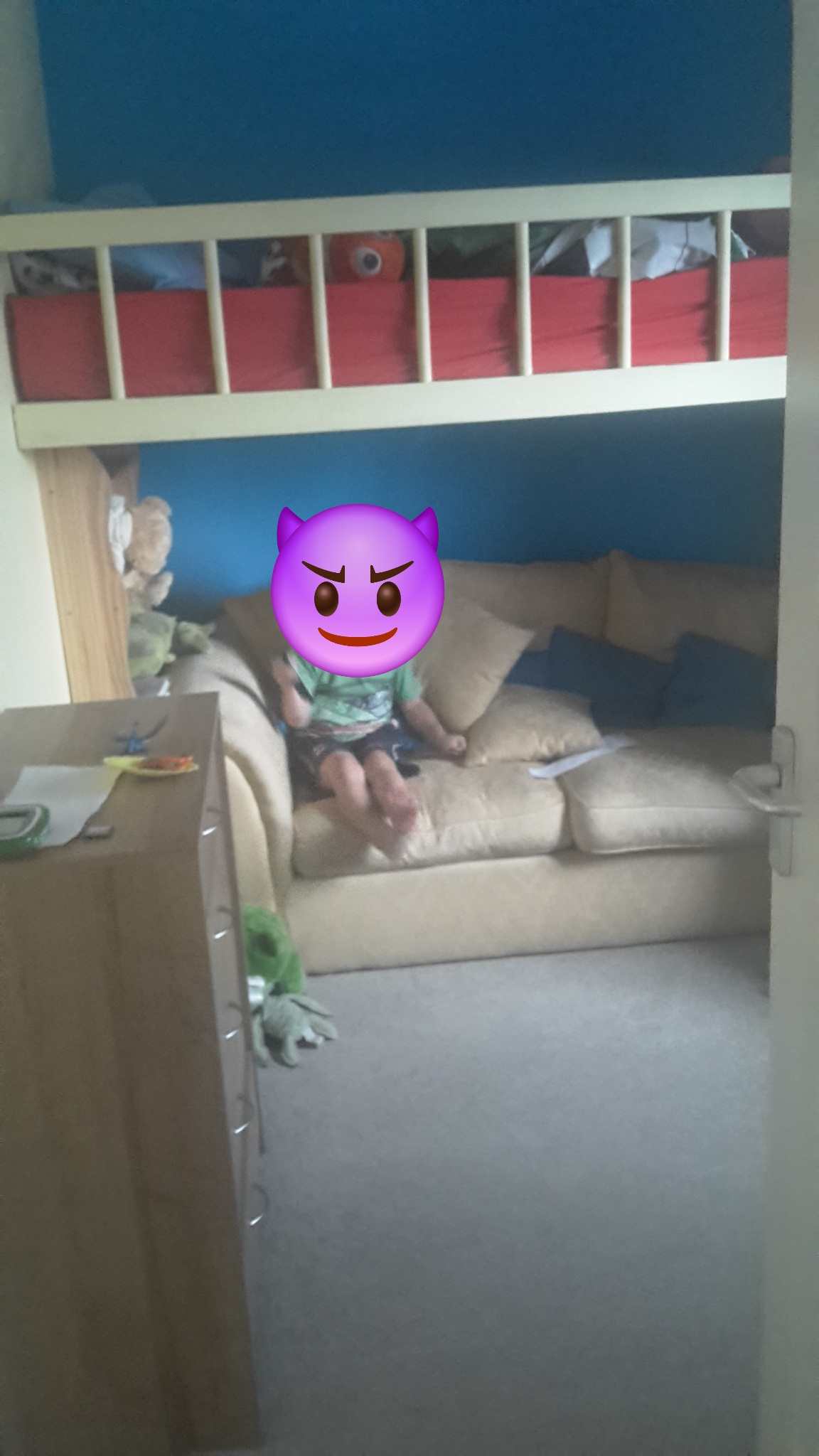

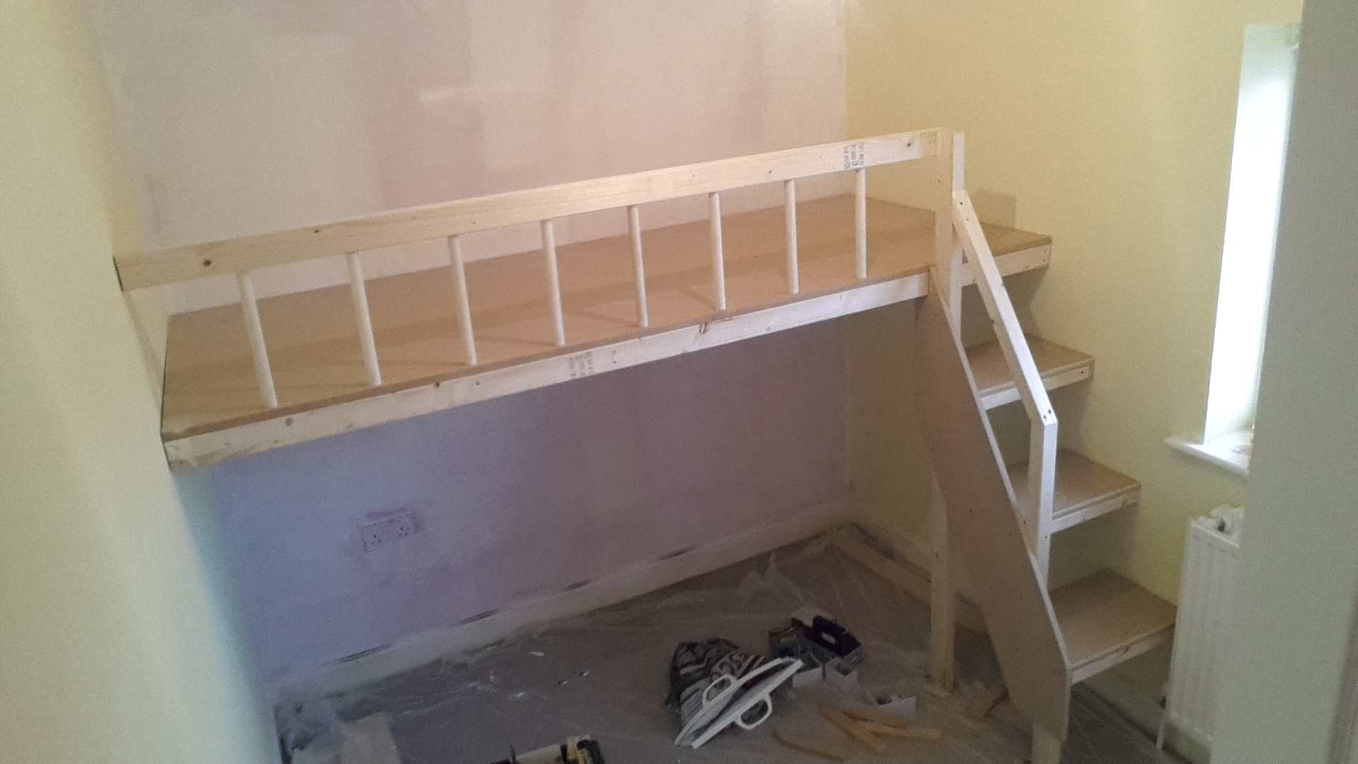

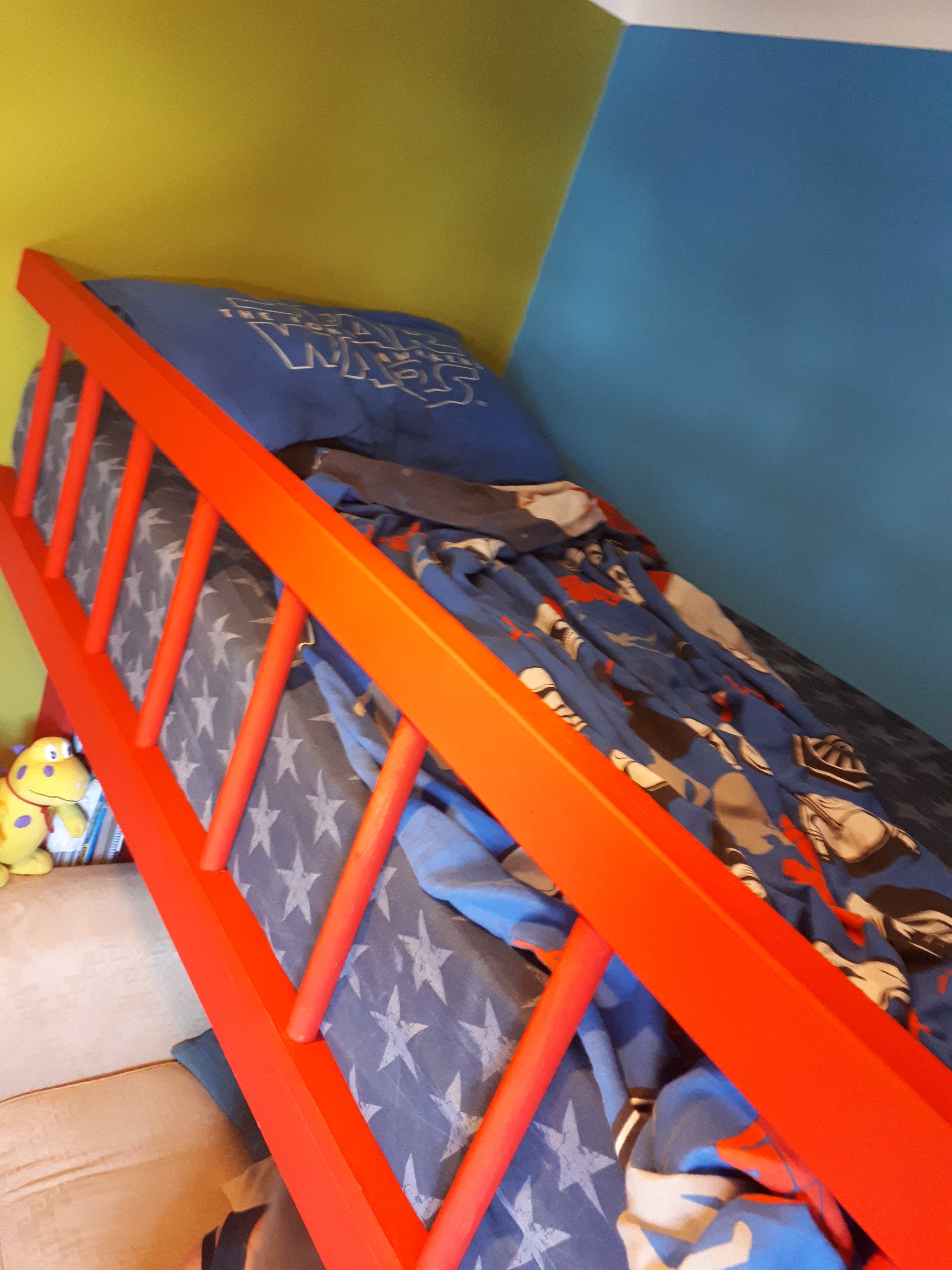

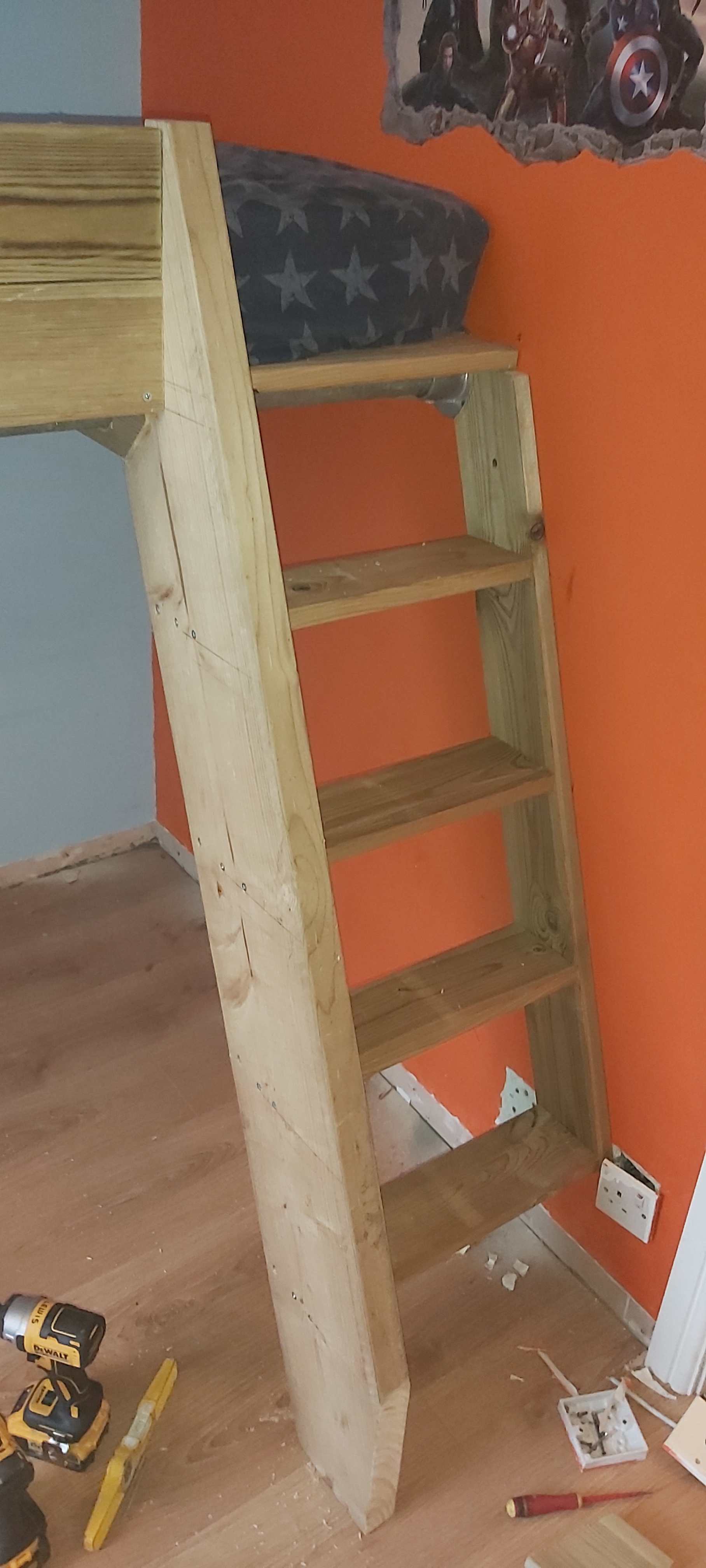

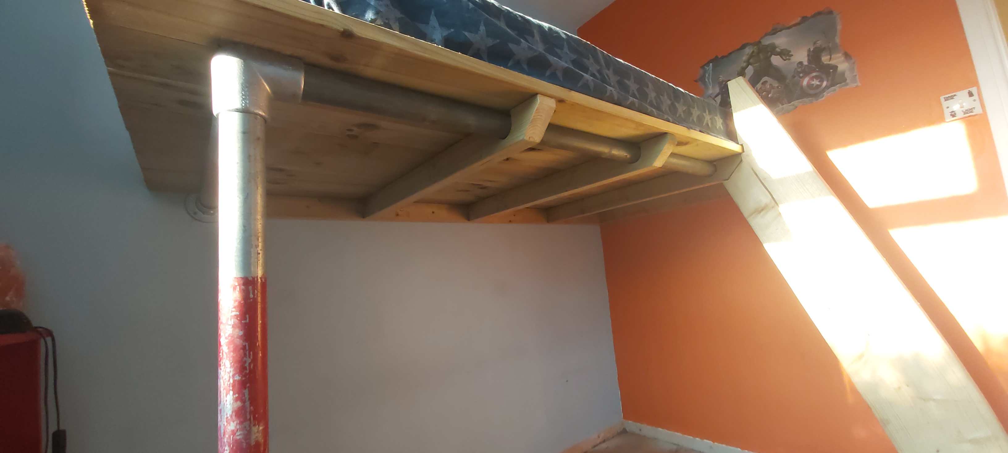

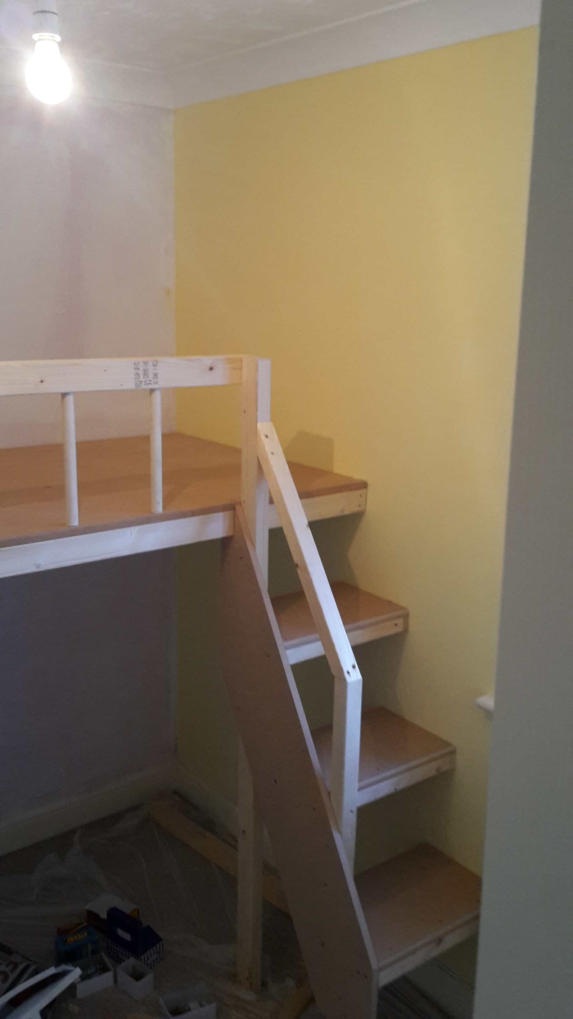

FuerteStu Posted September 4, 2024 Share Posted September 4, 2024 I've built two raised beds for my eldest boy. Both were built to be as indestructible as he is destructive. I never went that high and they were high enough for plenty to go on underneath. I can post pictures if you're interested in what I came up with? Link to comment Share on other sites More sharing options...

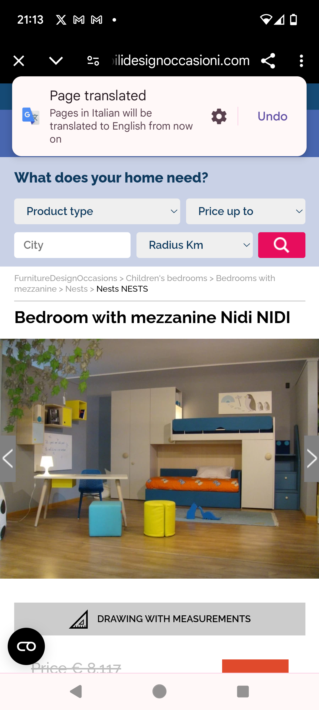

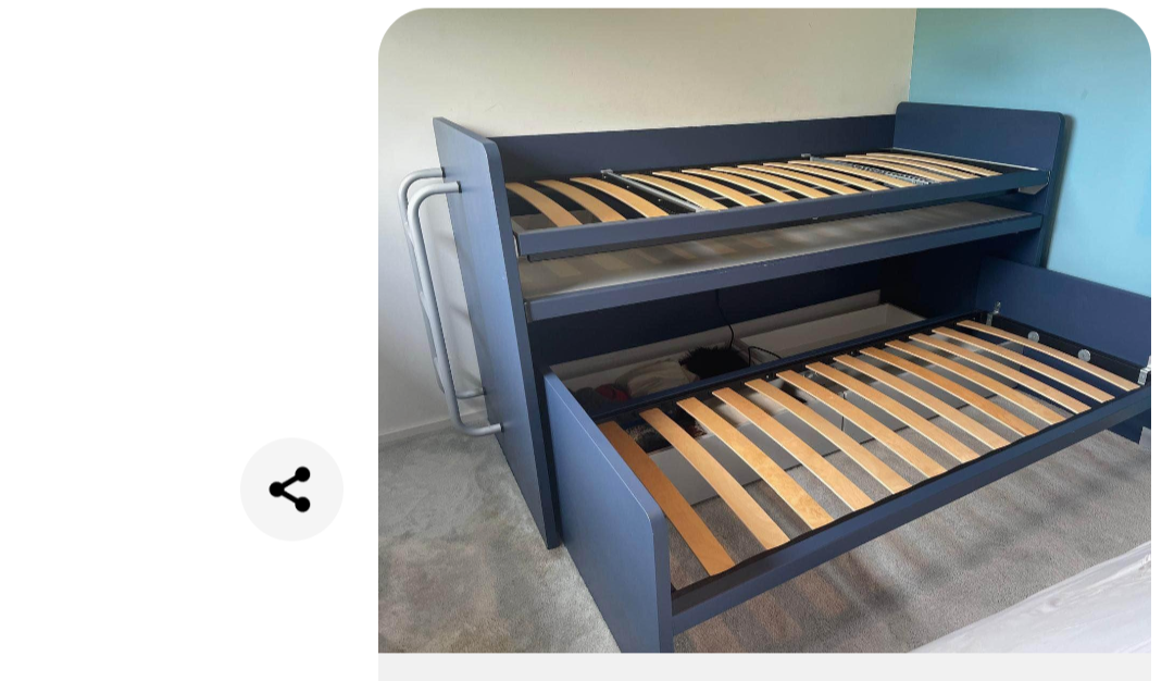

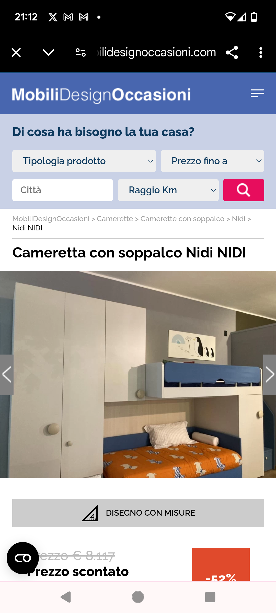

CalvinHobbes Posted September 4, 2024 Share Posted September 4, 2024 (edited) I was looking at furniture in Lux for grandchildren and saw some of these, the blue one was on a resell site and has sold so sadly I can't show you the other pics but it has a table you slide out. Mobili seems really good even for inspiration. Perhaps you could do something similar and put a table underneath. Otherwise look at loft beds, plenty of designs. Very popular in Lux, Japan etc. Edited September 4, 2024 by CalvinHobbes Link to comment Share on other sites More sharing options...
FuerteStu Posted September 4, 2024 Share Posted September 4, 2024 First one I built allowed for a sofa bed underneath.. Large steps for a 5yo to climb, there was a light on a timer at the top, so he didn't have to climb down in the dark. The rail at the top was made from a length of 2x3 and two broom sticks cut into sections Link to comment Share on other sites More sharing options...

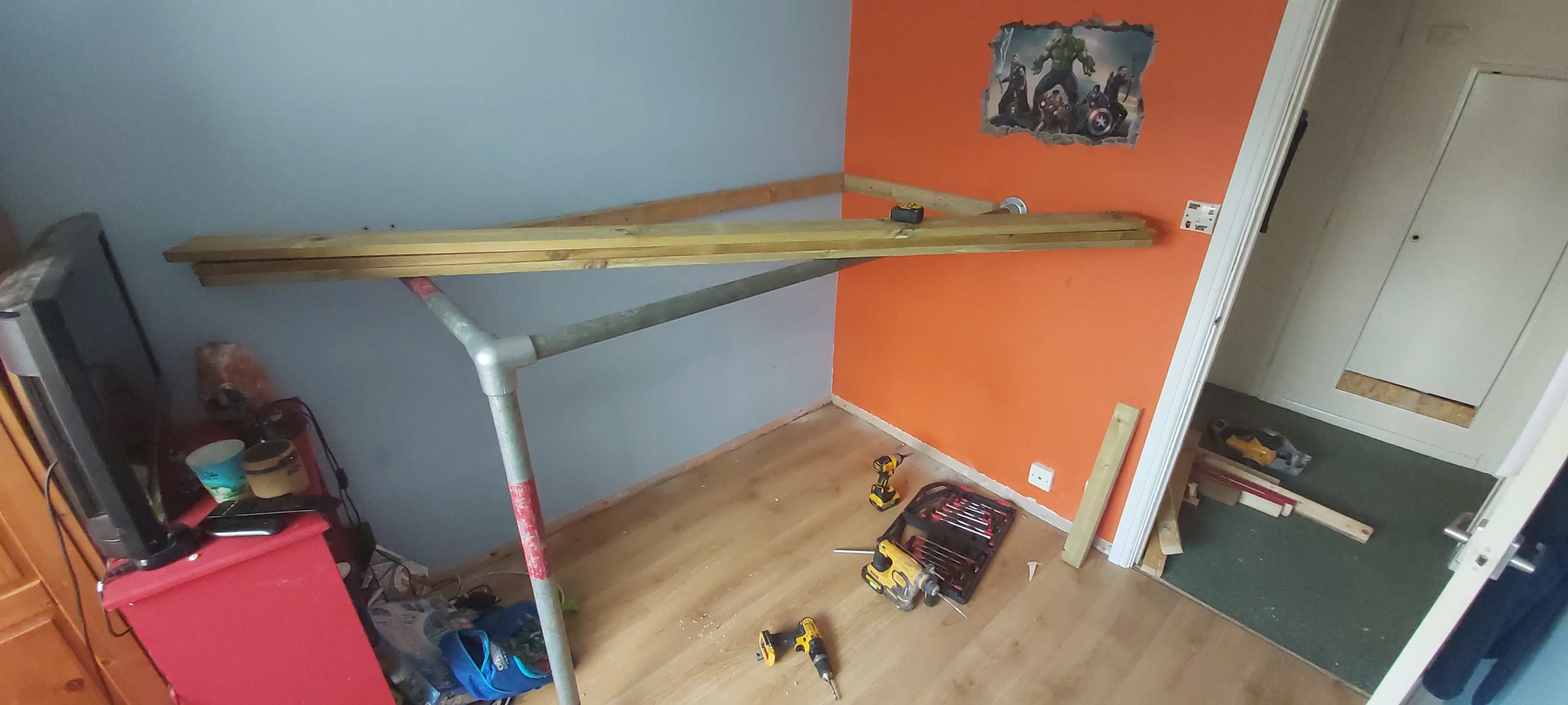

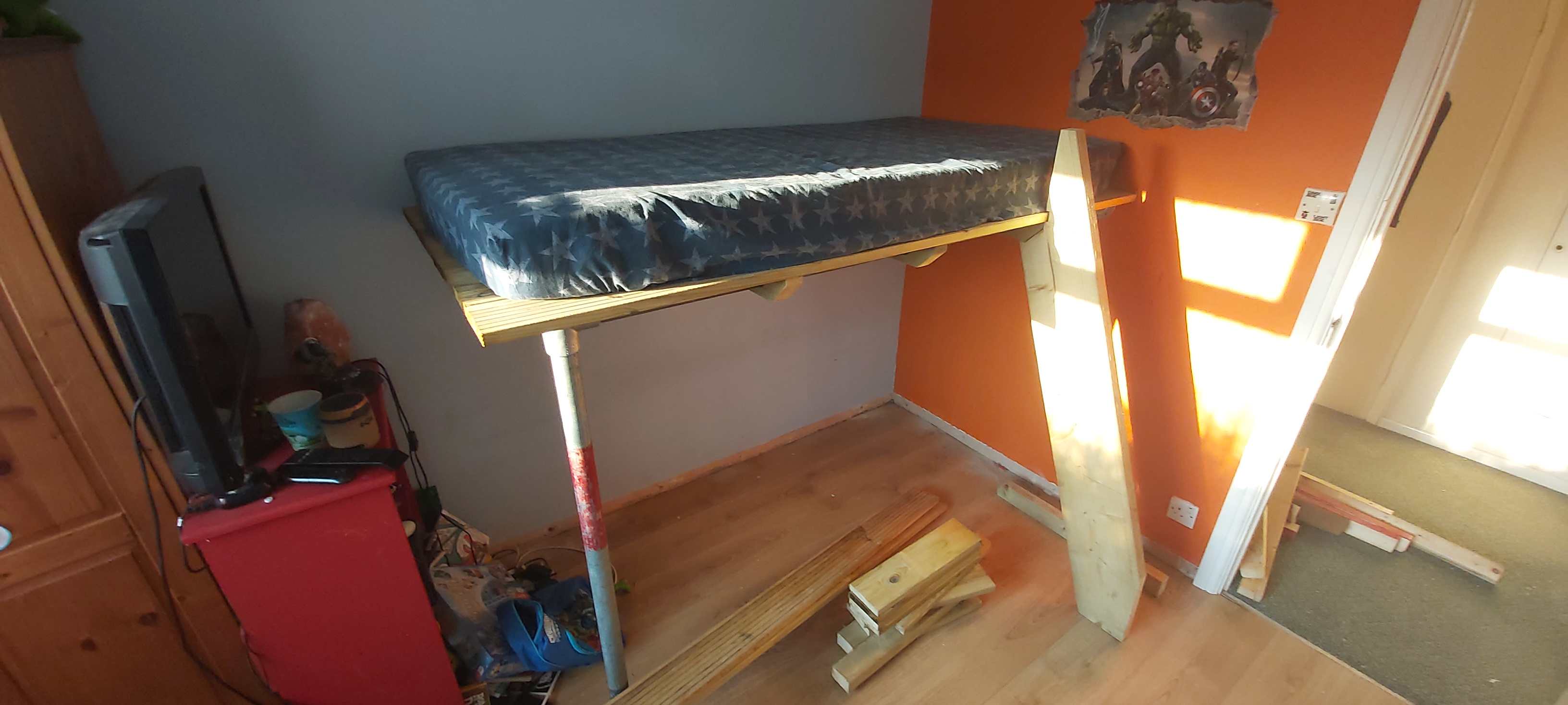

FuerteStu Posted September 4, 2024 Share Posted September 4, 2024 Second one was when he was older.. Had a steeper ladder, and made with scaffold tubes. This one was fixed to two walls. With the corner supported with an upright 2 Link to comment Share on other sites More sharing options...
