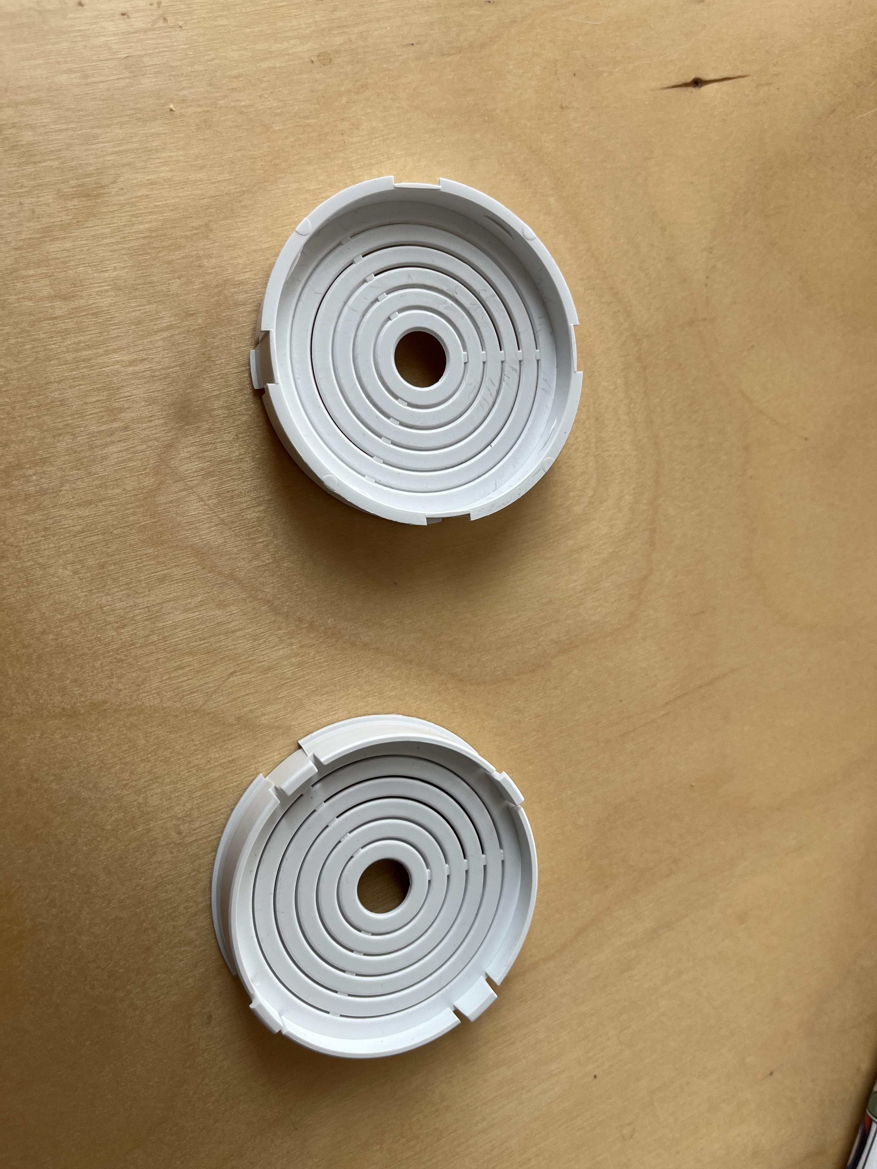

MikeSharp01 Posted September 3 Share Posted September 3 We are just about to put the MVHR unit in and hook it up to all the ductwork and the outside world. We have a Titon HRV4.25 Q Plus B2 (with the aura controller) and I am not sure what attenuation strategy I should use. I have read loads of stuff on here and elsewhere and also spoke to the technical team at Titon (can't praise them (him) enough) and he suggested using two of their 1m semi flexible attenuators although I know some on here advise against these devices. I had intended to put the attenuation into the distribution boxes, so after the unit in supply and before it on extract, which I will custom make, based on ideas shown elsewhere here, to fit the space and allow maintenance but his suggestion - which will be the other side of the unit on the connections to the outside, has some advantages eg getting fitted in the space /lined up. I do want to to be as quiet as I can get away with. Any thoughts. Link to comment Share on other sites More sharing options...

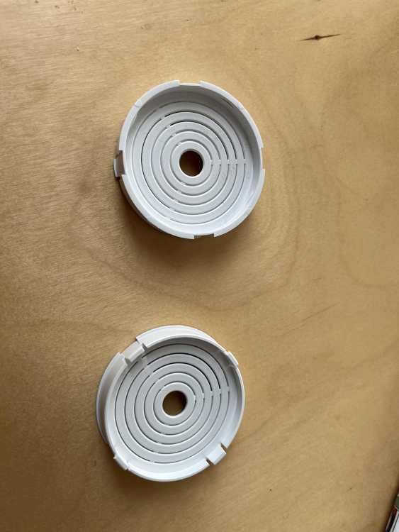

Simon R Posted September 4 Share Posted September 4 16 hours ago, MikeSharp01 said: I do want to to be as quiet as I can get away with. Any thoughts. Mike, you may like to consider using these. Mr Harris put me on to them, the idea is that you keep the air velocity down to a minimum in the tubes by installing these restrictors at the plenum. You pop out the restrictor rings as required. It's a bit of a fiddle as it's an iterative process as you balance out the flows. Link to comment Share on other sites More sharing options...
MikeSharp01 Posted September 4 Author Share Posted September 4 1 hour ago, Simon R said: you may like to consider using these. Mr Harris put me on to them, the idea is that you keep the air velocity down to a minimum in the tubes by installing these restrictors at the plenum. You pop out the restrictor rings as required. It's a bit of a fiddle as it's an iterative process as you balance out the flows. Thanks. Good plan - I will get some when the balancing starts. Link to comment Share on other sites More sharing options...

jack Posted September 16 Share Posted September 16 On 04/09/2024 at 12:50, MikeSharp01 said: With us there is no room for them before the distribution plenums so they will need to go on the other side between the titon and the outside air but I do have room inside the DIY plenums for some foam etc. Not sure what the effect of having the attenuator on the external connections is though. The sounds are from the unit itself and airflow within the system, particularly through any throttle points. I doubt putting an attenuator between the unit and the outside will have any impact on the noise at the internal inlets/outlets. On 04/09/2024 at 13:54, Simon R said: Mike, you may like to consider using these. Mr Harris put me on to them, the idea is that you keep the air velocity down to a minimum in the tubes by installing these restrictors at the plenum. You pop out the restrictor rings as required. It's a bit of a fiddle as it's an iterative process as you balance out the flows. These are the standard approach with Ubbink (Brink) manifolds. The designer told us the right number of rings to pop out and everything was close enough that we needed only slight adjustments on the room vents in a couple of places to get everything balanced. I don't know whether there's a way of estimating the number of rings to pop out for other systems. Link to comment Share on other sites More sharing options...

Simon R Posted Wednesday at 10:04 Share Posted Wednesday at 10:04 On 16/09/2024 at 12:28, jack said: don't know whether there's a way of estimating the number of rings to pop out for other systems. I just estimated based on room air volume requirement. The largest flow with no restrictor, then the others as a percentage of the largest flow ( I didn't use restrictors in any of the returns). Using pi r2 to calculate the rings to remove. This works out at approximately 70,55,36,19,16% which is a reasonable starting point. Having done this measure the flows with the room restrictors fully open. If the flow was too low then remove another ring to get to the right sort of volume +-20%. As changing each restrictor affects the pressure in the system you may need to repeat the process. I would not bother trying to be too exact, it really is a diminishing returns exercise I called quits when within 20%. Once you get to this point you can then adjust the MVHR fan speed to get the required flow in the room with the largest. The other rooms should also be correct at this point. After setting up this way I found that in practice I could run the MVHR at a lower fan speed and still have a comfortable environment (almost silent). 2 Link to comment Share on other sites More sharing options...
