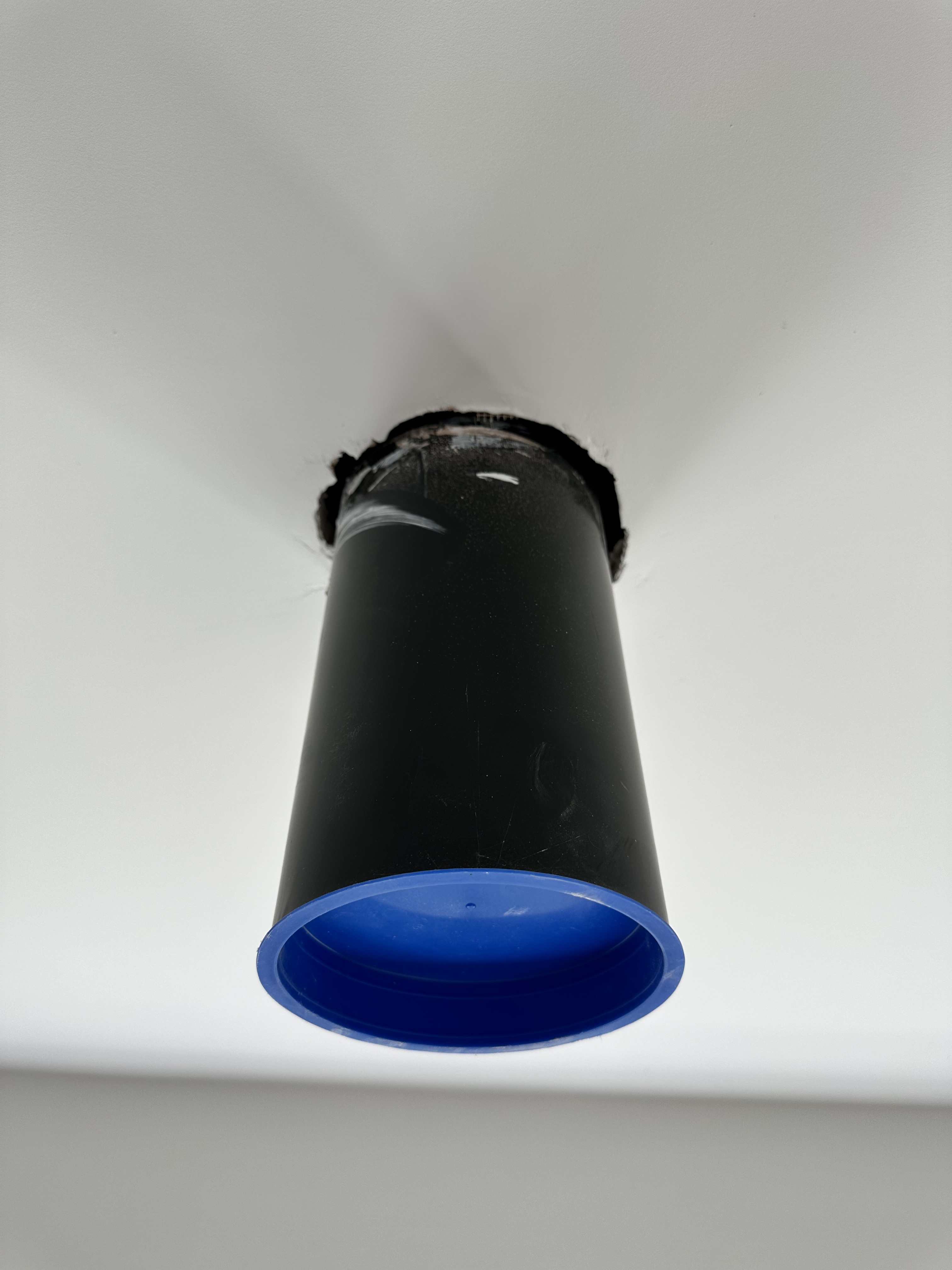

Mikey Posted August 26, 2024 Share Posted August 26, 2024 Hi all, how have others filled this gap(see pic) between the vent and ceiling. It’s a bit big for a bead of silicone, expanding foam will be a right mess. Compriband might work… Just wanting to crowd source what others have had success (or not!) with. Cheers Link to comment Share on other sites More sharing options...

JohnMo Posted August 26, 2024 Share Posted August 26, 2024 15 minutes ago, Mikey said: Just wanting to crowd source what others have had success (or not!) with. Decent deep fill filler, couple of coats, deep fill to fill the gap and the second a fine filler to take up the shrinkage. Your terminal will cover it also. 1 Link to comment Share on other sites More sharing options...
Eric Posted August 26, 2024 Share Posted August 26, 2024 A hole saw isn’t expensive & just leaves enough room for a bead of silicone. Link to comment Share on other sites More sharing options...
Russell griffiths Posted August 26, 2024 Share Posted August 26, 2024 For anybody doing this in the future, the better method is to cut the plenum tube flush with the plasterboard, then the plasterer will fill the gap when he skims the ceiling. 2 Link to comment Share on other sites More sharing options...
Oz07 Posted August 26, 2024 Share Posted August 26, 2024 I'd squirt some foam in there just to give the filler a bit of backing else you will just keep pushing it up? 1 Link to comment Share on other sites More sharing options...

Mikey Posted August 27, 2024 Author Share Posted August 27, 2024 On 26/08/2024 at 17:17, Eric said: A hole saw isn’t expensive & just leaves enough room for a bead of silicone. The plenums were installed prior to plasterboard and the tackers did not cut tight enough. Would you fit the plenums after boarding? Link to comment Share on other sites More sharing options...
Eric Posted August 27, 2024 Share Posted August 27, 2024 13 minutes ago, Mikey said: The plenums were installed prior to plasterboard and the tackers did not cut tight enough. Would you fit the plenums after boarding? Yes, board ceilings then fit the plenums. Seal with silicone, cut plenum level with plasterboard. Link to comment Share on other sites More sharing options...
Chanmenie Posted August 27, 2024 Share Posted August 27, 2024 I fitted plenums first then cut the plasterboard so it was tight to the plenums then the plasterer plastered up to the plenum which I then cut flush to the ceiling with a multitool. No filler needed Link to comment Share on other sites More sharing options...

Dave Jones Posted August 28, 2024 Share Posted August 28, 2024 no need to cut anything if you use the correct terminal. the ones that fit the metal ducting were less than £3. We ran a batten noggin either side so the boarders had something to screw them too as if you did the job properly and filled the ceiling void with insulation it wants to push down on them so they need support to stop them popping out. Link to comment Share on other sites More sharing options...
Mikey Posted August 28, 2024 Author Share Posted August 28, 2024 16 hours ago, Chanmenie said: I fitted plenums first then cut the plasterboard so it was tight to the plenums then the plasterer plastered up to the plenum which I then cut flush to the ceiling with a multitool. No filler needed This is what I was doing but the tackers did not cut the board tight enough and so the plasterer couldn’t / didn’t skim right up to the plenum. On the gf there was no way of fitting the plenums after the plasterboard, they had to be in before. Link to comment Share on other sites More sharing options...
Chanmenie Posted August 29, 2024 Share Posted August 29, 2024 19 hours ago, Mikey said: This is what I was doing but the tackers did not cut the board tight enough and so the plasterer couldn’t / didn’t skim right up to the plenum. Yeah that’s exactly why I did mine myself. But I appreciate I am fortunate to have the time and skill to be able to do it. Link to comment Share on other sites More sharing options...
