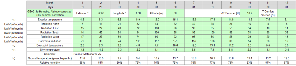

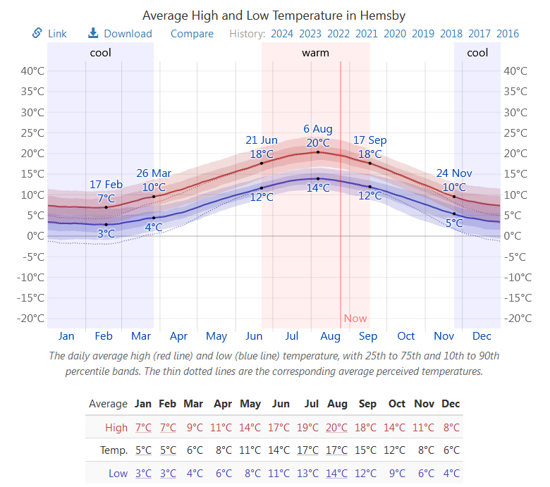

marshian Posted August 22, 2024 Posted August 22, 2024 On 22/08/2024 at 06:22, G and J said: So if i look at Jeremy's spreadsheet it calculates the heat required to maintain the internal temperature - default is 20c inside and -10c outside which gives me ~2.5kW. But.... I'm not sure if -10c is excessive for Suffolk, There's no allowance for getting up to temperature, and There's no allowance for hot water either. And I'm really not sure how to derive the heat demand figure from his spreadsheet. Help! Expand When I did my heat loss study it used -2.3 based on location (Norfolk) -10 is a little bit OTT for East Anglia The Heat study came out at 14,500 kWh per year for CH and HW (HW was assessed at 3285 kWh of that overall figure) However they use a really high ACH rate due to the age of my house which I disagreed with (it has quite an impact) Our overall gas usage per year is down to 7800 (CH and HW) CH is 77.5% of our usage, HW is 21% of our usage and cooking is 1.5%

G and J Posted August 22, 2024 Author Posted August 22, 2024 On 22/08/2024 at 08:24, JohnMo said: Heat pump you really should be running steady state, not on off like a boiler. I take the following for DHW allowance. 2.5kW heat demand x 24 hrs is 60kWh. So now you need to take time out for DHW, so allow 2 hrs (2x heating sessions). So now you need to produce 60kWh in 22 hrs. 60 / 22 so 2.7kW. So you are looking at a 4kW heat pump, which is about as small as you get. -10 is excessive for Suffolk, but in your case it's going to make much difference, you will still have an oversized heat pump. So you need a single zone to enable it to cope with limited cycling. Expand Our MCS plumber dude told us straight of that the smallest heat pump we can have will be oversized, so I kinda took that as a given but corroborating opinions are useful. I was trying to calculate heat load/demand to get my head round how far off passive standard we are. With the current set of assumptions I’m working to at -10c the heat loss divided by the internal floor area is around 17W/m2, so we are well over. At the Norfolk level of -2.3c it’s 13W/m2 ignoring DHW - and just over 14W/m2 if I do the patent @JohnMo 24/22 DHW fudge factor - which doesn’t look so bad after all. My confidence level in these numbers though is not high yet as I have the queasy feeling that I’m missing a basic, partly because they are so much better than I naturally expected (I still associate passivehaus with long straggly beards and 4’ thick cameldung and candyfloss walls, but then, I am an old reactionary at heart!). Heat demand though still confuses the life out of me.

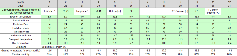

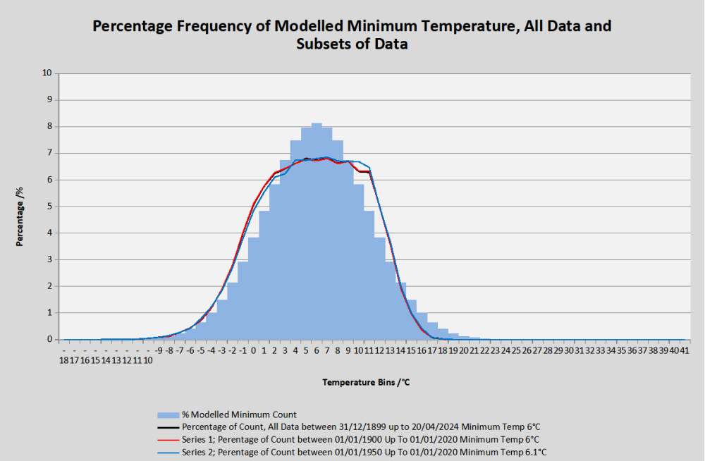

SteamyTea Posted August 22, 2024 Posted August 22, 2024 On 22/08/2024 at 06:22, G and J said: not sure if -10c is excessive for Suffolk, There's no allowance for getting up to temperature, and There's no allowance for hot water either Expand Quick answer is yes, no and you need to add to it. The longer answer is you need to know the total power per degree kelvin. Then you need to know your weather profile i.e. how often, in hours, it is -10, -9, -8 ......8, 9, 10....up to your heating off temperature (mine is a daily mean OAT of 9°C). Then you look that the middle 99% of that profile and accept at the negative temperature tail, you may need to turn on a fan heater. If you know your DHW energy demand, say 5 kWh/day, and your heating system is saying 5 kW, then you are heating water for 1 hour, so you have to make sure your heating system can, in the coldest days, supply enough energy in 23 hours. If you have ever lived in a place with a properly designed and executed E7 system, you will we used to this. You get all your energy stored in 7 hours (or less) then spread it out for the remaining 17 hours. In practice, you will find that your combined maximum heat load is not a nice round number that the heating system comes as i.e. 8 kw. So you have to round up to the next available size. Gas combination boilers are generally sized to deliver instantaneous hot water, so are often massive oversized i.e. 24 kW, but the modulate down to possibly a couple of kW power output for space heating, then start short cycling (what buffer tanks are used for).
