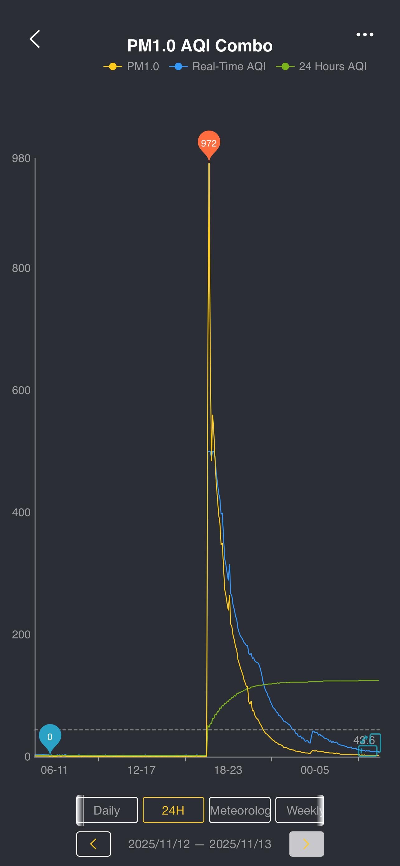

Kelvin Posted November 13 Posted November 13 (edited) I cooked steak last night. We eat very little red meat so it had been a while since I cooked steak. I had the Neff downdraught recirculating fan on full and had the kitchen door open. There wasn’t much visual evidence of the steak frying in the room. Here’s the air quality plot. The sensor is in a room off the kitchen. PM2.5 and 10 were almost off the scale. Edited November 13 by Kelvin
JohnMo Posted November 13 Posted November 13 3 minutes ago, Kelvin said: I cooked steak last night. We eat very little red meat so it had been a while since I cooked steak. I had the Neff downdraught recirculating fan on full and had the kitchen door open. There wasn’t much visual evidence of the steak frying in the room. Here’s the air quality plot. The sensor is in a room off the kitchen. PM2.5 and 10 were off the scale. They say eating meat is bad for you and the environment
Tetrarch Posted November 13 Posted November 13 We have the Neff downdraft and it copes absolutely fine regularly with four pans on the go. The balance between the occasional lingering smell and the aesthetic appearance of no hood, (plus the theatre of the downdraft) means that we are happy with our decision A consideration may be the volume of the room the vent empties into. Whilst we only have one (double piped) vent directly over the island, the kickboard vent empties in a large space, so the effects may be mitigated somewhat Regards Tet
