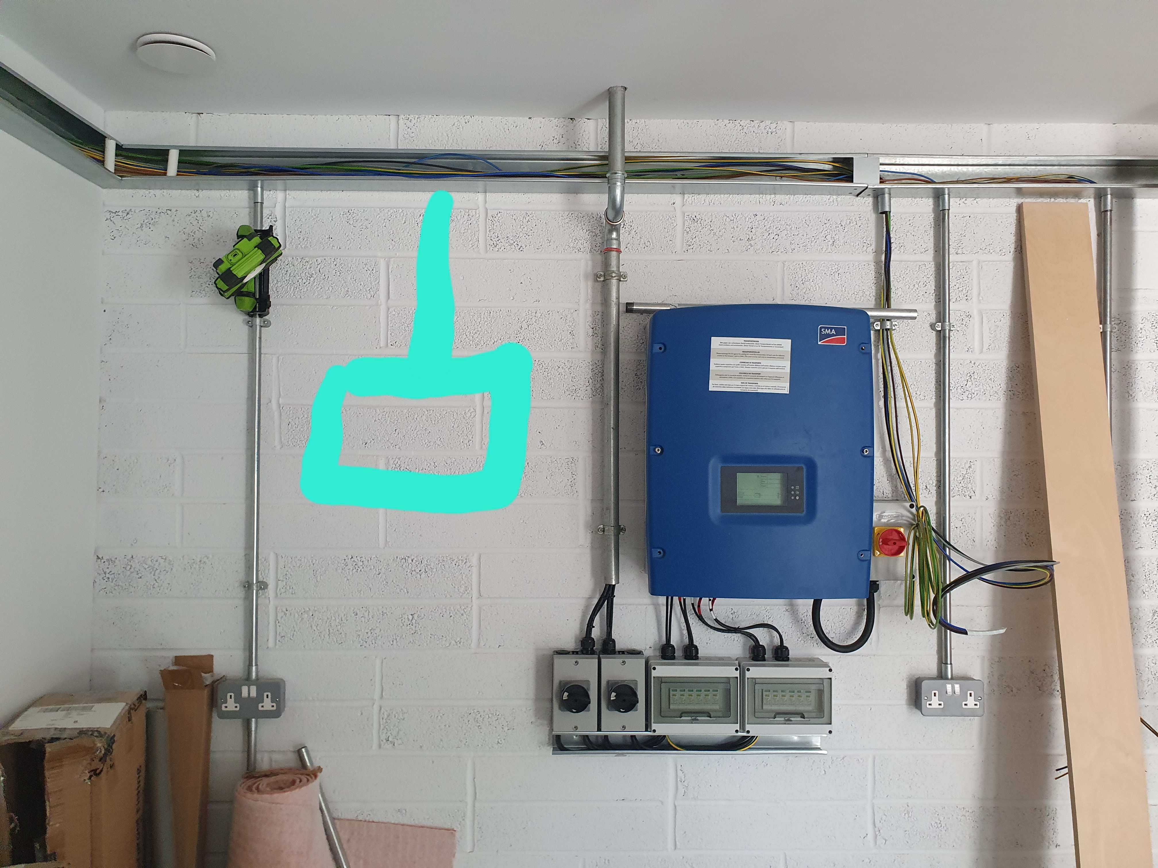

joth Posted November 13 Share Posted November 13 On 06/08/2024 at 12:57, Tom said: Thanks all, really helpful. For now I guess I'll just get a cabinet so the sparks has somewhere to take the cables to. Here's a picture where it'll go, the cables and power can come down from the trunking above, marked in green. Does anyone have any specific recommendations for wall mounted cabinets? Late reply, but that trunking is not ideal for CAT6a cable feeding the whole house, as a) there's not going to be much space in it if you have 96 cables as some here suggesting LOL. (Or even 50 cables) b) it's generally not considered best practice to run data and mains together in parallel Not strictly a regs violation and CAT6a should be shielded to minimize interference issues so you may be fine, but if anyone designing from scratch I'd recommend splitting mains and data to separate trunking Link to comment Share on other sites More sharing options...
Tom Posted November 14 Author Share Posted November 14 19 hours ago, joth said: Late reply, but that trunking is not ideal for CAT6a cable feeding the whole house, as a) there's not going to be much space in it if you have 96 cables as some here suggesting LOL. (Or even 50 cables) b) it's generally not considered best practice to run data and mains together in parallel Not strictly a regs violation and CAT6a should be shielded to minimize interference issues so you may be fine, but if anyone designing from scratch I'd recommend splitting mains and data to separate trunking Thanks Joth. I did raise a concern at the start of the install re putting the data and AC wires in the same trunking, but it seems they weren't too concerned. Not that I found that very reassuring! Is there a way of assessing interference with the CAT6a before I make the final payment? Link to comment Share on other sites More sharing options...
Pocster Posted November 14 Share Posted November 14 I have in some situations mains and cat cables running together . No interference or issues with this that I can detect . Link to comment Share on other sites More sharing options...
joth Posted November 14 Share Posted November 14 2 hours ago, Tom said: Thanks Joth. I did raise a concern at the start of the install re putting the data and AC wires in the same trunking, but it seems they weren't too concerned. Not that I found that very reassuring! Is there a way of assessing interference with the CAT6a before I make the final payment? Ideally a TIA CAT6a certification test (while drawing full load on the electrical equipment sharing that trunking, which if PV might mean doing it on a sunny day lol) But if this wasn't in the original contract I can see them at most giving you a basic cable verification (buzz) test https://www.fullcontrolnetworks.co.uk/questions/copper-cable-tester-your-options/ Link to comment Share on other sites More sharing options...
