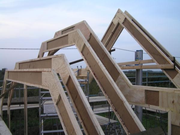

2 hours ago, Gone West said:
We did indeed have a factory built timber I beam portal frame. IIRC there were limitations when designing, such as the roof angle which determined the maximum width for a given height. Ours was only 6m wide. I think PH15 construct their frames in a very similar way to ours.
Mine is 6m wide too.
So how were the joints made at the wall/roof joins, and at the roof peak? Did you support the roof peak with a beam, or was all the load taken by the portal frames? On the front of the PH15 booklet, there a picture of IBeam portal frames used to make a house with a big beam supporting the top of the roof.
I might have to use a beam after all, but that would spoil the head room in the mezzanine bedroom area, unless I raise the roof a big higher, which I'm reluctant to do.
I haven't ruled out having my I-beams made for me. It'll depend on the quotes.
There were no beams used. A picture paints a thousand words, so
IIRC the joining pieces were 18mm ply both sides, glued and screwed. I think the roof angle has to be around 45 degrees to prevent spread. I am not a SE though, so could be wrong about that, it was many years ago.
