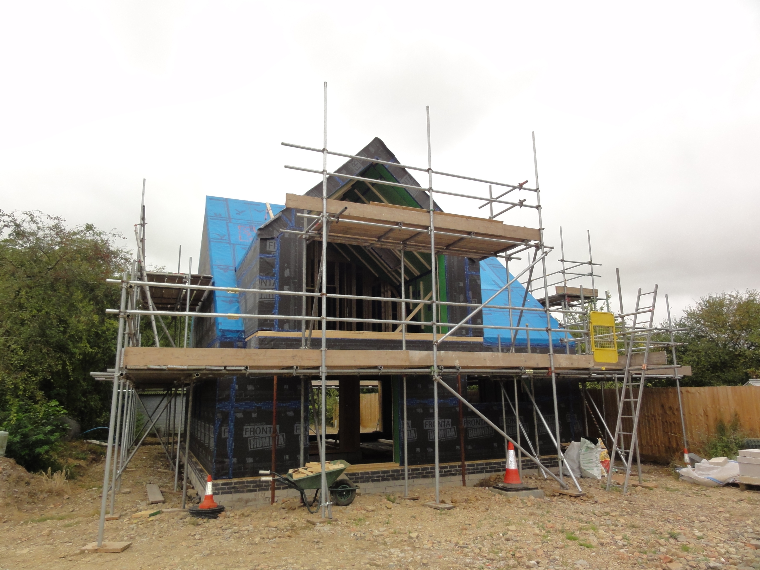

Moira Niedzwiecka Posted October 27, 2017 Posted October 27, 2017 Hello All, Our house is a 300mm closed panel timber frame insulated with cellulose. This is the make up of the walls and the roof. Externally we will have a natural slate roof, walls render & ironstone. Has anyone with a similar construction had any issues with an internal TV aerial? Will we still be able to get a signal through this construction? It has only just occurred to me. I would be grateful for any help. Moira
Jeremy Harris Posted October 27, 2017 Posted October 27, 2017 If you're in a very good signal area, then you might get away with an indoor or loft fitted aerial OK, but I suspect you may struggle. We've found that our house, which has a very similar construction, attenuates high frequency signals a fair bit, so, for example, DAB radio won't work indoors, but FM radio does, just about. Mobile phone signals are very weak in our area, as are terrestrial digital TV signals, and neither can be reliable received. Terrestrial digital TV frequencies are quite high, and may well be attenuated to the point where an indoor or loft aerial won't work. You can feed cables through the wall for an external antenna, but it's a bit of a fiddly job. I did it using a specially made up long 6mm diameter drill, to drill the pilot hole right through the wall, then a 20mm hole saw either side. With a lot of patience and a bit of plastic turned up to form a pointed bit that was a tight fit in the end of a bit of 20mm plastic electrical conduit, I managed to fiddle around and get a bit of conduit through the wall, and sealed it on either side. I then ran antenna cables through this, and sealed it up around the cables at either end. This worked OK, but was a bit fiddly and time consuming, as it's not easy to feel for the hole on the other side when poking something though 300mm of cellulose filled wall.

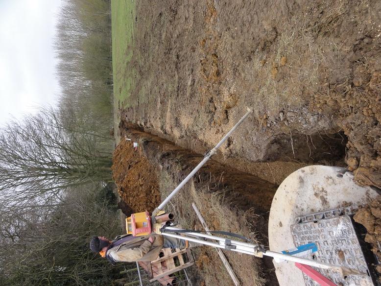

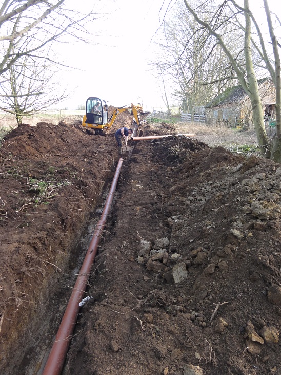

Moira Niedzwiecka Posted October 27, 2017 Author Posted October 27, 2017 Jeremy, thank you. The drainage has been a problem from the start. We were going to have a mini waste treatment plant to start with. The percolation test was ok for foul & surface soakaway. After a very wet winter both we & BC were not convinced it was the right thing. We managed to get an easement from the farmer to duct through his field & woodland to the main combined sewer for the village. It was 110m away & we hit rock halfway. We are elevated so had to go really deep to start with to get the correct gradient so we did not come out of the ground before we reached the main sewer. You would have thought we were building crossrail!
Jeremy Harris Posted October 27, 2017 Posted October 27, 2017 (edited) It looks to me as if you may well have scope for a low level vent, higher than the top of the foul drain run (shall we call it mini-Crossrail? ) perhaps suitably hidden somewhere, to deal with the pressure equalisation issue in the long foul drain run. You can then fit an AAV high up in the house to deal with the separate issue of the possible partial vacuum caused when an upstairs toilet is flushed. I had to make the case to do something very similar to the BCO, rather than my building inspector, as I knew that it was a bit out of the ordinary. In our case we have a treatment plant, that incorporates a low level vent (just a few hundred mm above ground level) that performs the requirement of equalising the pressure in the foul drain. I did not want to fit an SVP through the roof or out through a wall, so I wrote a carefully worded request directly to the BCO, with drawings, explaining how I proposed to deal with the two different vent requirements in the regulations. I also explained why I needed to avoid running an SVP through the wall or roof, and the consequences that doing so may have on the thermal performance of the house. He accepted this without question, and agreed that, although this was not a standard means of addressing the requirements, as suggested in the guidance in the approved document, it was OK and did comply with the building regulations themselves. It's important to note that the approved documents (in this case Part H) are not regulations, they are just methods and guidance that MAY be used to comply with the building regulations, but equally they are not the only way that the regulations can be complied with. Edited October 27, 2017 by JSHarris

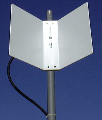

Onoff Posted October 28, 2017 Posted October 28, 2017 (edited) I built a couple of horizontally polarized, trough antennae for friends locally. Designed for optimum performance 538MHz i.e dead centre of Band A. They work a treat. A trough antennae is really just a corner reflector with the vertex removed and replaced with a plane reflector - which lends itself to fitting against a wall...or gable. These are vertically polarized, imagine turned thru 90deg for horizontaliy polarized. Waltham's signal is horizontally polarized. So a corner reflector: And a trough antennae, as above but with the vertex taken off: The construction can be sheet ali or mesh. For the first I used sheet ali. The second one was done in 1/2" galv mesh. If mesh is used it needs to be ideally 1/12 wavelength or smaller. I made the dipoles from 8mm ali tube from memory. I reckon the plane reflector could be hidden by the cladding on a gable then just have the two wings in mesh and the dipole on show. Admittedly probably not the off the shelf solution the OP was after! I'll maybe redo the maths later as I've mislaid my original paper calcs. They're don't come out small btw. +1 on www.aerialsandtv.com , great company. Scroll down to the table above the picture and see their recommendation for an aerial: http://www.aerialsandtv.com/walthamtx.html Tbh they're really nice people to talk too. Give them a ring. Edited October 28, 2017 by Onoff
