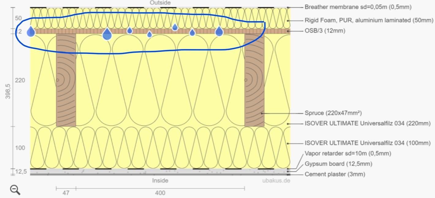

Iceverge Posted July 20, 2024 Share Posted July 20, 2024 1 hour ago, G and J said: So, I’m trying to understand the logic behind this build up. A skin of PIR externally (carefully taped?) presumably does a brilliant job of alleviating cold bridging, and means the frame has to dry inwards. Presumably the breather membrane is to keep rain out, but could be non breathable given it’s proximity to the non breathable PIR. Is the intello membrane primarily for air tightness? The breather membrane is just to make sure that any water doesn't find it's way into the structure. The PIR if taped correctly is keeping the drips out anyway but belt and braces. Correct Intello is for airtightness. Link to comment Share on other sites More sharing options...

IanR Posted July 20, 2024 Share Posted July 20, 2024 (edited) 3 hours ago, G and J said: and means the frame has to dry inwards. I'm not seeing any evidence of that, why do you assert that it does? Edited July 20, 2024 by IanR Link to comment Share on other sites More sharing options...
G and J Posted July 20, 2024 Author Share Posted July 20, 2024 2 hours ago, IanR said: I'm not seeing any evidence of that, why do you assert that it does? Because I understood the PIR to be vapour impermeable. From what I’ve read you can put PIR outside if the frame if you don’t tape it and maybe leave small gaps, which I would have thought would reduce it’s effective thermal insulation. Otherwise it won’t be breathable. Link to comment Share on other sites More sharing options...
IanR Posted July 20, 2024 Share Posted July 20, 2024 (edited) 53 minutes ago, G and J said: Because I understood the PIR to be vapour impermeable. But that doesn't make the moisture turn around and head back the other way. If you look at the Ubakus analysis it finds the moisture will sit at the OSB and take 139 days to dry out. I'd assume by evaporation. Within the standards Ubakus uses, 139 days to dry out is a failure - 90 days is the max. I'd assume that's because there is insufficient drying time in the summer to garuntee it will dry out and is therefore at risk of continuously being "wet". One caveat with Ubakus is that it "does not take into account the capillary conductivity of materials", although with my limited knowledge I'm not sure that would help with the foil covered PIR being the next layer as I'd expect capillary conductivity to be negligible. As mentioned before, a more precise condensation analysis should be used for non-standard build-ups. BC should require it for sign off. 53 minutes ago, G and J said: From what I’ve read you can put PIR outside if the frame if you don’t tape it and maybe leave small gaps, which I would have thought would reduce it’s effective thermal insulation. Otherwise it won’t be breathable. Really? You've read that the product is OK to use if you do a crap job of fitting it and allow cold air to breach the insulation? Not sure that's a strategy I'd use. Edited July 20, 2024 by IanR Link to comment Share on other sites More sharing options...
G and J Posted July 20, 2024 Author Share Posted July 20, 2024 31 minutes ago, IanR said: But that doesn't make the moisture turn around and head back the other way. Well, either the house in Iceverge’s link is rotting away inside the walls as I type or things do dry inwardly, so maybe it does. Standard practice can easily become dogma and that’s generally a good thing if it simplifies and ensures that the majority of projects are ok. But sometimes there might be the possibility of something better if new approaches are tried. Interesting debate, I do appreciate the inputs. Link to comment Share on other sites More sharing options...
IanR Posted July 20, 2024 Share Posted July 20, 2024 7 minutes ago, G and J said: Well, either the house in Iceverge’s link is rotting away inside the walls as I type or things do dry inwardly, so maybe it does. I'm not sure you are understanding what I'm saying, which is evidenced by the Ubakus analysis, so I'll back out of this discussion finishing with me repeating that it does not dry inwardly. That does not mean that its rotting away. It's not as black and white as you'd like to perceive it. Link to comment Share on other sites More sharing options...
Kelvin Posted July 20, 2024 Share Posted July 20, 2024 I wouldn’t rely on Ubakus for anything non-standard. Get a full WUFI analysis done then you can have more confidence in how the building will deal with moisture over the seasons. Wood can rot quite quickly in the right environment. Intello Pro Clima is for air tightness but it’s also a vapour control (check) layer. Link to comment Share on other sites More sharing options...
G and J Posted July 20, 2024 Author Share Posted July 20, 2024 17 minutes ago, Kelvin said: I wouldn’t rely on Ubakus for anything non-standard. I’m using it for thermal performance only. I’m striving to be as informed a ‘buyer’ as possible, but the final answer will be underwritten as a minimum by appropriate professionals. 19 minutes ago, Kelvin said: Intello Pro Clima is for air tightness but it’s also a vapour control (check) layer. I might be suffering from an inadequate understanding of terminology (amongst other things). When I tried to look it up I thought it indicated that this was moisture permeable. If not then I am royally confused. The good news is that I’m used to being that, but I try not to stay that way. Link to comment Share on other sites More sharing options...

SteamyTea Posted July 22, 2024 Share Posted July 22, 2024 Just a quick note, from much earlier on in the replies, you do not need liquid water for mould to grow and bacteria to multiply. You just need the right levels of relative humidity in the right temperature band. There are two methods used to analyse condensation/humidity risk (statistical or analytical) both have failings. Bur both are better than anecdotal analysis. It is not as simple as too high a humidity level in the building structure, or even condensation, WILL cause a problem, it depends on the structures tolerance to moisture and how long it can resist fungal or bacterial attack before self healing/repelling. It really is a bitch of a topic, but the good side is that most houses, and specially new ones that are used properly, don't have a problem. Link to comment Share on other sites More sharing options...
