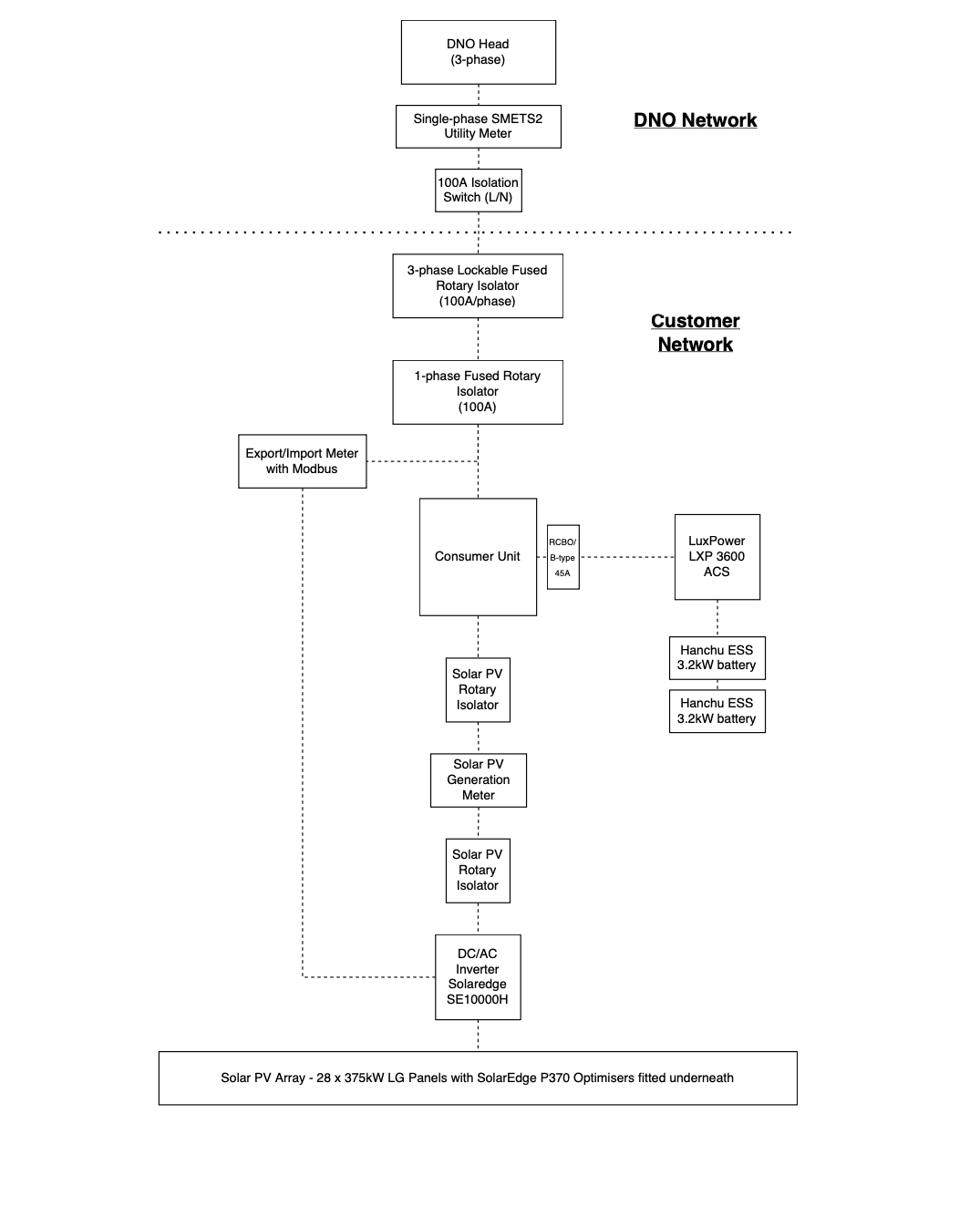

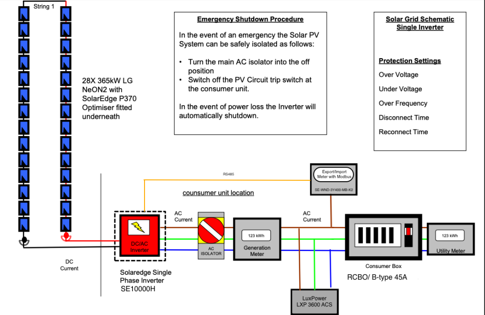

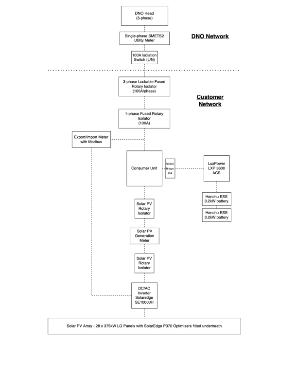

Thorfun Posted August 21, 2024 Author Share Posted August 21, 2024 i've created a whole new single line diagram which i think is now much better. any comments before i submit to DNO? Link to comment Share on other sites More sharing options...
sharpener Posted August 21, 2024 Share Posted August 21, 2024 Looks clear and easily understandable. Why is there the 3phase lockable isolator as well as the single phase one, is it for future expansion? Under IET CoP for EESS there should be a lockable two-pole isolator on the input to the Luxpower inverter, you could argue that it is adequate to lock off the dedicated RCD (if this has got the holes in the handle for one of those cheapo mcb locks) - so mention it is lockable. May be show power flow, data (wired) and data (wireless, if any) with different kinds of line? May be show rating of DNO fuse and have the principle flow from left to right? Aren't the batteries 3.2 kWh not kW? (Doesn't sound to me a good match 10.5 kW PV though, will only store 40 mins of full output) Link to comment Share on other sites More sharing options...
Thorfun Posted August 21, 2024 Author Share Posted August 21, 2024 3 minutes ago, sharpener said: Why is there the 3phase lockable isolator as well as the single phase one, is it for future expansion? we have a 3-phase supply but are only running the house off a single phase. hence the single phase smart meter. so, yeah, basically future expansion if needed. 4 minutes ago, sharpener said: Under IET CoP for EESS there should be a lockable two-pole isolator on the input to the Luxpower inverter, you could argue that it is adequate to lock off the dedicated RCD (if this has got the holes in the handle for one of those cheapo mcb locks) - so mention it is lockable. isn't that excessive though? if they're working on the lines then switching off via the 3-phase lockable rotary isolator would suffice, no? i can easily update the drawing to say it's lockable though, although that is not true. 5 minutes ago, sharpener said: May be show power flow, data (wired) and data (wireless, if any) with different kinds of line? i did have arrows and stuff but figured everything is 2-way flow anyway so why bother! i also found some other SLDs on a Victron forum and they didn't have flow direction so i didn't bother. 7 minutes ago, sharpener said: May be show rating of DNO fuse and have the principle flow from left to right? i can add the 3 x 100A DNO fuses. not sure what you mean by 'principle flow from left to right' though. 8 minutes ago, sharpener said: Aren't the batteries 3.2 kWh not kW? (Doesn't sound to me a good match 10.5 kW PV though, will only store 40 mins of full output) whoops! don't let @SteamyTea know i got the units wrong. i'll never live it down. Updating now. the batteries are expandable. i can only afford 6.4kWh of storage at the moment. but can easily add extra 3.2kWh units to increase the capacity as and when funds allow. it's not a huge amount of storage but it reduces our night time usage a bit. Link to comment Share on other sites More sharing options...

sharpener Posted August 21, 2024 Share Posted August 21, 2024 3 hours ago, Thorfun said: isn't that excessive though? if they're working on the lines then switching off via the 3-phase lockable rotary isolator would suffice, no? i can easily update the drawing to say it's lockable though, although that is not true. Yes but that is what the IET says on the matter and their Code of Practice is incorporated in BS7871 by reference so mandatory under the Building Regs. I did borrow both the first and second editions from their library prior to my DiY install but I can't remember the rationale. It might be so you can work safely on the inverter itself. In my case this makes some sense as I have a bypass switch so the inverter can be taken out of service entirely with the rest of the system live. More importantly if you have off-grid/UPS capability they also require you to have a separate earth electrode as you cannot rely on the DNO's PME earth terminal in case they are working on their side of the cutout and have disconnected their cable. Not many installers know about either of these requirements. i did have arrows and stuff but figured everything is 2-way flow anyway so why bother! i also found some other SLDs on a Victron forum and they didn't have flow direction so i didn't bother. No I meant use different kinds of line (solid, dashed, chain-dashed etc) for the different kinds of link. i can add the 3 x 100A DNO fuses. not sure what you mean by 'principle flow from left to right' though. You have got the logical flow from DNO intake to the final circuits from top to bottom (more or less) but personally I would go for left to right like this though it is largely a matter of taste. whoops! don't let @SteamyTea know i got the units wrong. i'll never live it down. Updating now. the batteries are expandable. i can only afford 6.4kWh of storage at the moment. but can easily add extra 3.2kWh units to increase the capacity as and when funds allow. it's not a huge amount of storage but it reduces our night time usage a bit. Yes, I started with 7.1 kWh of Pylontecs but added a third module after the first winter. 1 Link to comment Share on other sites More sharing options...

Thorfun Posted August 22, 2024 Author Share Posted August 22, 2024 I uploaded the required drawings and my application is now complete. I used the Smart Connect portal and I received the 'your application is complete' email pretty soon after. so they either have some form of AI or image recognition software to check the drawings or they don't care. either way, I'm happy. 🙂 Link to comment Share on other sites More sharing options...

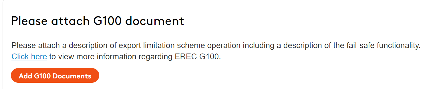

Thorfun Posted December 4, 2024 Author Share Posted December 4, 2024 24 minutes ago, MikeSharp01 said: I have hit a snag with our G99 application - they (UKPN) want a description of the G100 export limitation scheme employed - I read the briefing document on the Energy Networks Association but it looks long winded to provide a report. Did you just refer them to the Inverter certification and or draw them a schematic showing the energy meter linked to the inverter or was it more complex than that? it's been a while since i did mine but i believe that i just submitted the G100 certification for my Solaredge inverter for the application. then after the application was approved and i had to submit the commissioning docs i needed to specify the limiting shown in my single line diagram above. Link to comment Share on other sites More sharing options...
Bramco Posted December 4, 2024 Share Posted December 4, 2024 42 minutes ago, Thorfun said: it's been a while since i did mine but i believe that i just submitted the G100 certification for my Solaredge inverter for the application. Think this was what we did too - if I remember correctly, some inverters have this capability some don't, so you have to choose carefully. The info is on the database, so just download the relevant doc. There are devices that to the limitation separately but ideally you'd have the inverter do it. Link to comment Share on other sites More sharing options...

MikeSharp01 Posted December 19, 2024 Share Posted December 19, 2024 1 hour ago, Dillsue said: Won't the docs you previously submitted be more or less identical for the 3.68- 5 kw upgrade?? Possibly, I will get it dug out but probably not this side of XMAS, sorry @pudding - where are you we used the UKPN online assessment system and uploaded all the images and documents. Link to comment Share on other sites More sharing options...

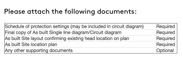

pudding Posted December 20, 2024 Share Posted December 20, 2024 Well, the G99 approval was received this morning after I sent an updated A1-2 form with more details of the Export limitation scheme, and specified on there the 5kW export the guy at National Grid told me I can have. So nice quick response! He said to reply with the commissioning docs once its installed. Now, I've no idea whats docs these are. Any clues? Anybody have examples of refs for which docs are required after a G99 install? Link to comment Share on other sites More sharing options...
Dillsue Posted December 21, 2024 Share Posted December 21, 2024 21 hours ago, pudding said: He said to reply with the commissioning docs once its installed. Now, I've no idea whats docs these are. Any clues? Anybody have examples of refs for which docs are required after a G99 install? Google "G99 commissiong form" and find what's needed for G99 but if you're using export limitation I'd guess theres an extra G100 test record available from the ENA or your DNO Link to comment Share on other sites More sharing options...
