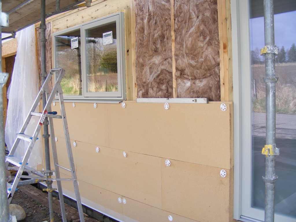

ProDave Posted June 14, 2016 Posted June 14, 2016 Knauf Earthwool Frametherm 35 is the product you want, available on a roll, or batts. Batts are probably better for a roof.Conveniently available in 90mm thickness and 2 layers nicely fills between 195mm timbers. I am using the roll version in my walls: 2
