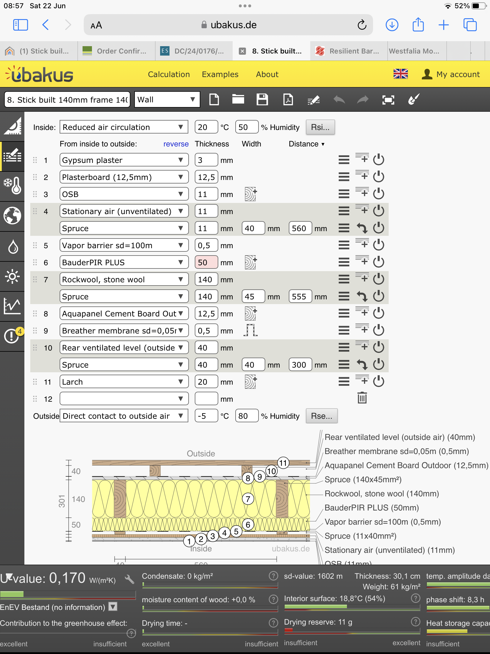

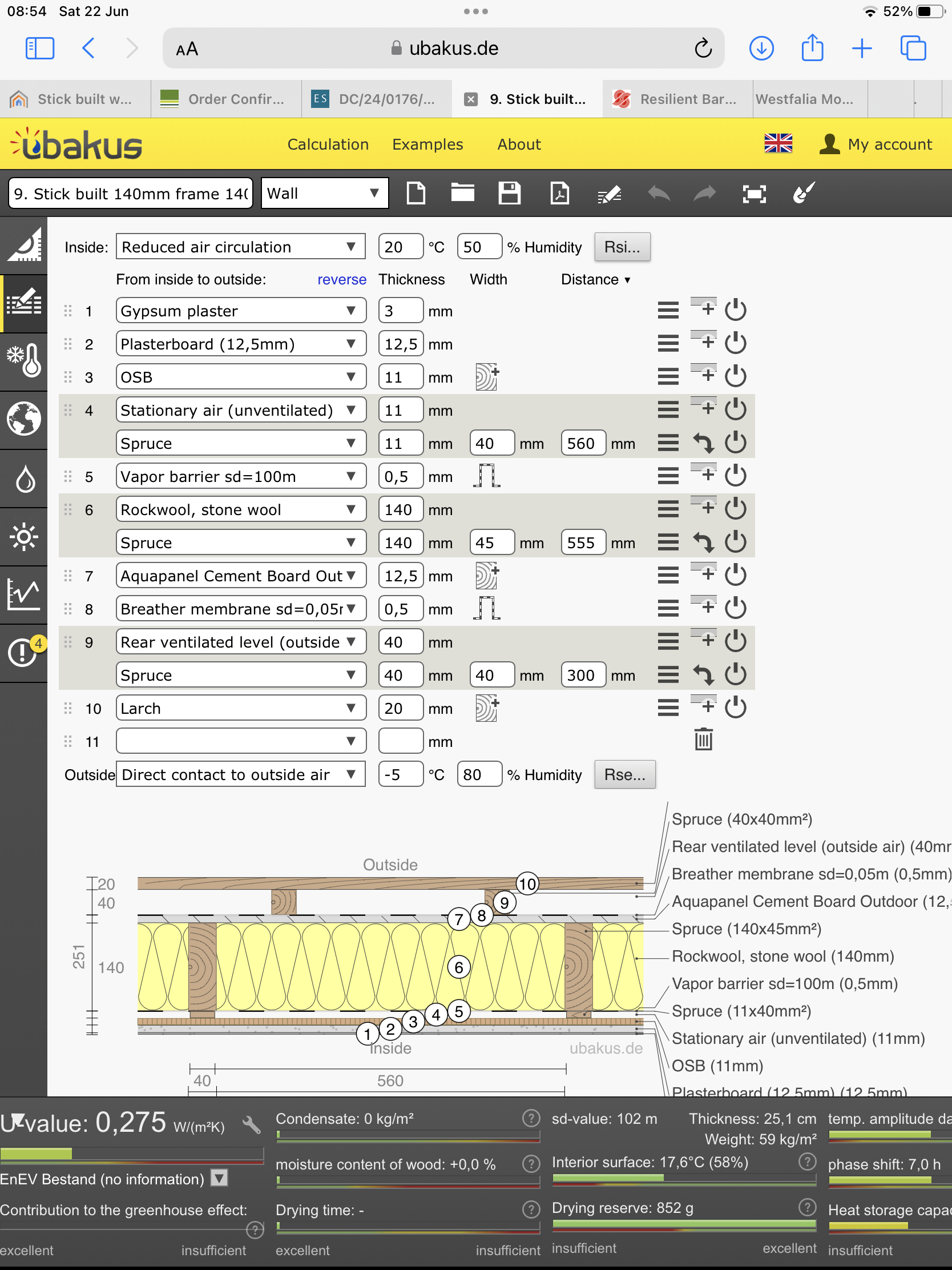

I am drawn towards a composite rockwool and PIR  solution like Thorfun listed.  140mm rockwool stuffed in frame (easy to do, improves sound performance) thence a skin of PIR to deliver thermal insulation, and that’s where the trade off between wall thickness and u value hit.
It is likely to deliver a poorer u value than we could have but that’s ok, once I’ve looked at the other elements I can analyse the balance and we can make informed choices.
And I would have stopped there and moved on to the next element had ubakus not had a little red triangle.  However, I think there is a possible flaw in its analysis.
If I have a build up such as:IMG_2829.thumb.png.45befc6a92cb41665d3290450591943b.png
then I get no warning triangle on drying reserve.
However, if I add a layer of PIR on the outside of the vapour barrier I get:
So, the addition of the PIR layer is the only addition.  It is next to and outside of the barrier which should let nothing through.  So if PIR does not absorb, store or transmit water as has been stated then it’s almost like it’s a 50.5mm thick vapour barrier - so why should it change whatever the drying reserve is?
If PIR was able to absorb, store and transmit water then it would be no different to the rockwool that it is next to.
Either ubakus has a quirk or there’s something fundamental that I’m failing to understand.
if you speak to an insulation manufacturer (you'll need to choose one that does mineral/glass wool AND PIR they will do a condensation risk analysis on your wall build up for you. then the risk is put on their shoulders.
We attached our IntelloPlus on the inside of the PIR so all our insulation is beyond it. I did that as I was paranoid about off-gassing of the PIR in to the house but I'm also convinced it just makes the condensation risk reduced and simpler to calculate.
It also stops warm, wet(ish) air from inside getting to a cold surface inside the wall which would risk condensation, so that is a very good thing.
May I ask what your wall airtight strategy is?

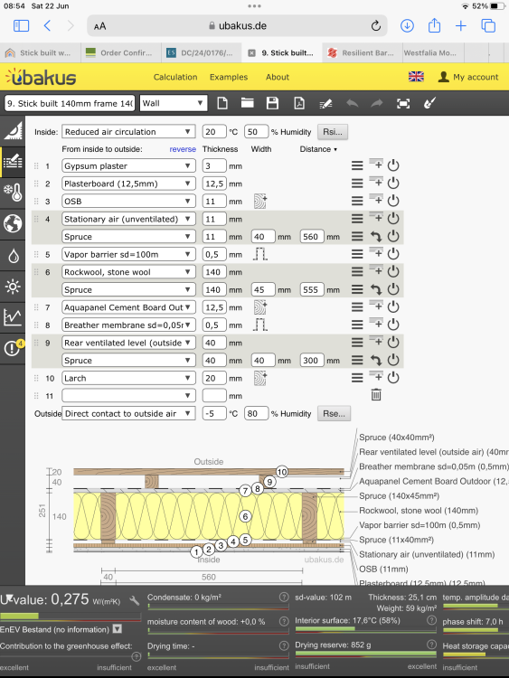

Ubakus isn't perfect. It just predicts one set temperature for outside and inside.
If for instance your buildup doesn't dry at -5⁰ don't fret as it's unlightly it'll be that cold for long enough to actually do any damage.
On the structural side of things I think you'll need to have the OSB connected to the studs as it provides the racking strength to prevent them folding over like a house of cards.
From a fire perspective I would prefer to see the OSB on the inner face of the studs or if it is external to them behind a good layer of fireproof material like rockwool or cement board.
