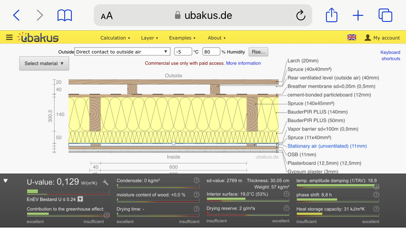

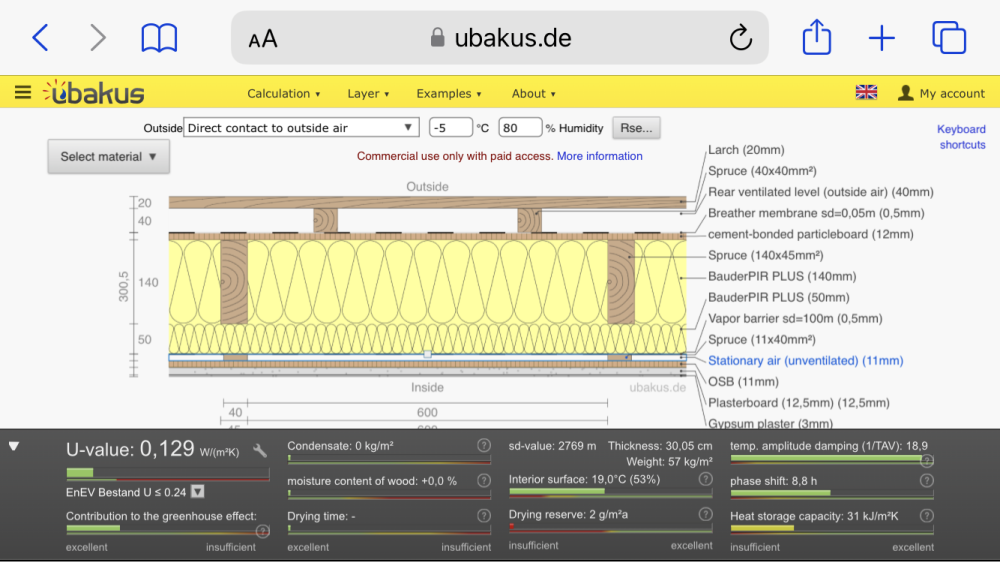

G and J Posted June 20 Share Posted June 20 So, the answer is on site stick built. Took me a while but I got there. I've been looking at ubakus and that’s been rather illuminating, though it’s raised as many questions as it’s answered. I seek a wall build up that is circa 300mm thick, has a sensible u value, has the required fire resistance due to proximity of boundary being less than 1m. Experiments show using lots of PIR makes for a thin and insulative wall. Rockwool or cellulose increase u value quite a bit. I note the comments on here about PIR alternatives being better for sound attenuation, etc. and I thought long and hard about this but then I realised SIPs were PIR and reports appear to say that they make good houses. So, I've come up with a build up which appears to hit the mark but there is a warning on the drying reserve. Should I worry about that? Link to comment Share on other sites More sharing options...
Thorfun Posted June 20 Share Posted June 20 Only 11mm service cavity? Are you sure that’s enough? I presume your cladding is horizontal as well? If so can you reduce the battens to 25mm? we did 140mm frametherm 32 equivalent glass wool between the studs and 80mm PIR internally to get similar U-values. Link to comment Share on other sites More sharing options...
G and J Posted June 20 Author Share Posted June 20 4 minutes ago, Thorfun said: Only 11mm service cavity? Are you sure that’s enough? I presume your cladding is horizontal as well? If so can you reduce the battens to 25mm? we did 140mm frametherm 32 equivalent glass wool between the studs and 80mm PIR internally to get similar U-values. With the plasterboard, OSB and 11mm service void that will accommodate 25mm back boxes. There won’t be any pipes in them. (Though I will have to cut the hole in the OSB oversize so the back box can grip the plasterboard.) We're planning vertical cladding, hence the 40mm for counterbattens, but I don’t know how to do that on ubakus. I like the idea of Frametherm 32 @ 140mm to deaden sound, but not sure it’s worth 60mm off of the width of the house. Will investigate, thank you. Link to comment Share on other sites More sharing options...
Kelvin Posted June 20 Share Posted June 20 (edited) Where us the airtight layer going? You’re cutting through the airtight layer to accommodate the backboxes? Edited June 20 by Kelvin Link to comment Share on other sites More sharing options...
G and J Posted June 20 Author Share Posted June 20 Just now, Kelvin said: Where is your air tight layer going? Excellent question, and the simple answer is I don’t yet know. Peeps have referred to using the sheathing as the airtight layer which makes sense until I get to the upstairs ceiling (I’m assuming a cold loft). Link to comment Share on other sites More sharing options...
Kelvin Posted June 20 Share Posted June 20 You can use the OSB sheathing some folk have achieved good results using it. However you’re cutting into it and fitting backboxes. Link to comment Share on other sites More sharing options...
G and J Posted June 20 Author Share Posted June 20 Ah, sorry, I wasn’t clear. The OSB behind the plasterboard is just for stiffening and making the walls super solid and able to take light fixings everywhere. The sheathing on the outside of the frame is cement board, and that was the layer I was looking at. Link to comment Share on other sites More sharing options...

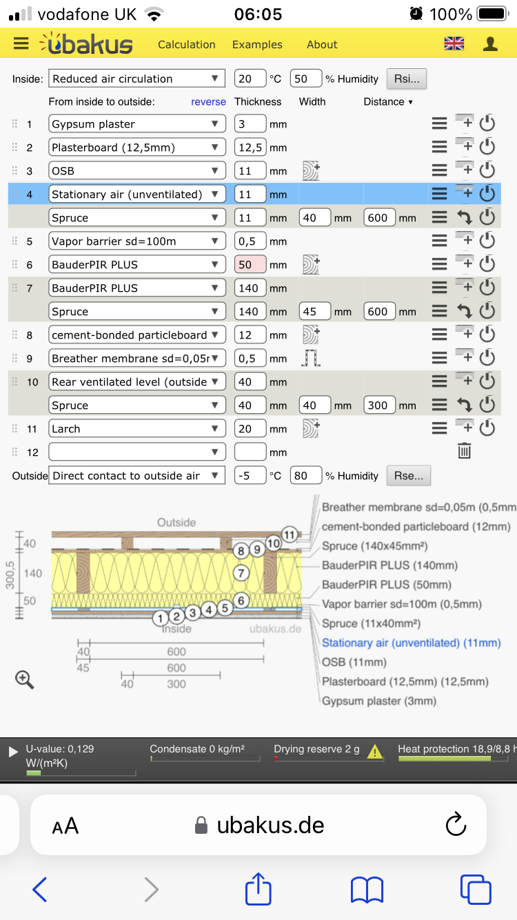

JohnMo Posted June 20 Share Posted June 20 8 minutes ago, G and J said: 10 minutes ago, Kelvin said: Where is your air tight layer going? Excellent question, and the simple answer is I don’t yet know Could you move to behind the 50mm PIR in the 140mm studs. PIR between studs, all need to be perfectly cut, foamed in place with zero gaps. Frametherm is really easy 37 minutes ago, Thorfun said: Only 11mm service cavity can you get your cooker cables and clips in the space. What are the electricians clipping cables to? As there is nothing for horizontal runs to clip to. 1 Link to comment Share on other sites More sharing options...
G and J Posted June 20 Author Share Posted June 20 2 minutes ago, JohnMo said: Could you move to behind the 50mm PIR in the 140mm studs. Actually that’s a brilliant idea, well done. The 50mm PIR would keep the vapour barrier lovely and safe and snug, and stop it rattling (does that happen? I’m guessing it might if it was the airtight layer). I’ll pop it in ubakus and see if it objects. Still don’t know how to seal to the upstairs ceiling though. 5 minutes ago, JohnMo said: PIR between studs, all need to be perfectly cut, foamed in place with zero gaps. Frametherm is really easy When I looked at rockwool generally it had half the R value of PIR, so in my case if I swap out PIR for frametherm my u value drops by circa 0.35. I’ve not compared the cost difference. Yet. (Or for that matter how much extra PIR is needed to compensate). 24 minutes ago, JohnMo said: can you get your cooker cables and clips in the space. What are the electricians clipping cables to? As there is nothing for horizontal runs to clip to. I think the oven will run off the ring main. Won’t be running any cables horizontally except through the posi joists. The kitchen service void depth is the exception. That is on an outside wall, but the will have a larger service void to accommodate pipes. All other pipes will be in internal walls. I tend to fix kitchen units slightly further out to make life easy running drains and stuff behind the units, and I don’t mind a slightly larger worktop - I’m a messy cook and I like to cover acres with mess lol Link to comment Share on other sites More sharing options...

saveasteading Posted June 20 Share Posted June 20 25 minutes ago, G and J said: Swapping the 140mm PIR for 140mm Rockwool Within the stud space we experimented on the practicality. Because stud never provides an exact, squared shape, it leaves gaps. We settled on using half thickness in pir and then dense mineral wool pressed in over it. The thinner pir can be fitted more precisely and the gaps are small and sealed off, thus becoming small insulating pockets. It's a compromise. As a bonus, the vapour barrier can deflect a bit when services are going in the service void. Link to comment Share on other sites More sharing options...
G and J Posted June 20 Author Share Posted June 20 4 minutes ago, saveasteading said: Within the stud space we experimented on the practicality. Because stud never provides an exact, squared shape, it leaves gaps. We settled on using half thickness in pir and then dense mineral wool pressed in over it. The thinner pir can be fitted more precisely and the gaps are small and sealed off, thus becoming small insulating pockets. It's a compromise. As a bonus, the vapour barrier can deflect a bit when services are going in the service void. Now that is an interesting idea. So on top of the PIR/Rockwool (which totals 140mm I presume) what other insulation layer did you use? And is this inside wood cladding or a brick skin? Link to comment Share on other sites More sharing options...
G and J Posted June 20 Author Share Posted June 20 Also, I know I’m a pain but I worry - should I worry about “drying reserve”? Link to comment Share on other sites More sharing options...
joe90 Posted June 20 Share Posted June 20 2 minutes ago, G and J said: “drying reserve”? Not heard of that before? Link to comment Share on other sites More sharing options...
Kelvin Posted June 20 Share Posted June 20 9 minutes ago, G and J said: Also, I know I’m a pain but I worry - should I worry about “drying reserve”? Well moisture risks and how buildings move it through the materials over the course of the year is something worth worrying about. Arguably it’s more important than the overall tightness. I was also concerned about this so used Intello Pro Clima as the humidity variable check layer. Link to comment Share on other sites More sharing options...
saveasteading Posted June 20 Share Posted June 20 26 minutes ago, G and J said: And is this inside wood cladding or a brick skin? Stick built with osb outer skin and vcl, then a ventilation gap and treated wood cladding. Frametherm, from memory. Density is rigjt for compressing into the space and staying there. Link to comment Share on other sites More sharing options...
IanR Posted June 20 Share Posted June 20 34 minutes ago, G and J said: should I worry about “drying reserve”? Yep, since Ubakus can't determine how much of an issue it is. If there's a potential issue you then need to move to something like Wufi to determine how significant. Lack of drying reserve could be too high vapour resistance on both sides of the build up, so if moisture gets in it can't dry out quick enough. Link to comment Share on other sites More sharing options...
G and J Posted June 20 Author Share Posted June 20 26 minutes ago, IanR said: Yep, since Ubakus can't determine how much of an issue it is. If there's a potential issue you then need to move to something like Wufi to determine how significant. Lack of drying reserve could be too high vapour resistance on both sides of the build up, so if moisture gets in it can't dry out quick enough. I wonder if I’ve specified an inappropriate membrane on layer 9 then? Link to comment Share on other sites More sharing options...
G and J Posted June 20 Author Share Posted June 20 33 minutes ago, saveasteading said: Stick built with osb outer skin and vcl, then a ventilation gap and treated wood cladding. Frametherm, from memory. Density is rigjt for compressing into the space and staying there. Do you have further insulation within the frame? Link to comment Share on other sites More sharing options...
Thorfun Posted June 20 Share Posted June 20 5 hours ago, G and J said: With the plasterboard, OSB and 11mm service void that will accommodate 25mm back boxes. There won’t be any pipes in them. (Though I will have to cut the hole in the OSB oversize so the back box can grip the plasterboard.) just be aware that trying to fit drywall backboxes to that thickness will be tricky or require more expensive backboxes. you would be wise to cut bigger holes in the OSB before plaster boarding (or even just leave a strip empty of OSB at socket height. trust me, it's a pain to try and cut out OSB/ply after the fact without wrecking the plasterboard! my other comment/concern is the benefit of the OSB? yes it will make the walls more "solid" but is 11mm OSB enough to hold shelves etc? also OSB is expensive! 25mm battens are cheap. and as @Kelvin said, if you're using the OSB as an airtight layer then you're penetrating it and making it pointless. personally, I would forgoe the OSB, use 25mm battens and use an AVCL as your airtight layer. can then also wrap that under the ceiling to maintain that airtight layer. and finally, you don't need a cold loft! you can insulate between the rafters to make a warm loft and carry the airtight layer around that. means anything that's stored in the loft is nicely inside the insulated envelope and any MVHR or pipework running there won't be cold. Link to comment Share on other sites More sharing options...
Thorfun Posted June 20 Share Posted June 20 4 hours ago, G and J said: The sheathing on the outside of the frame is cement board, and that was the layer I was looking at. the outside membrane needs to be breathable. the layer inside the insulation needs to be airtight. think you've got them the wrong way round? at the very least get an interstitial condensation analysis done to ensure that moisture won't be trapped in the wall nor in the house! Link to comment Share on other sites More sharing options...
