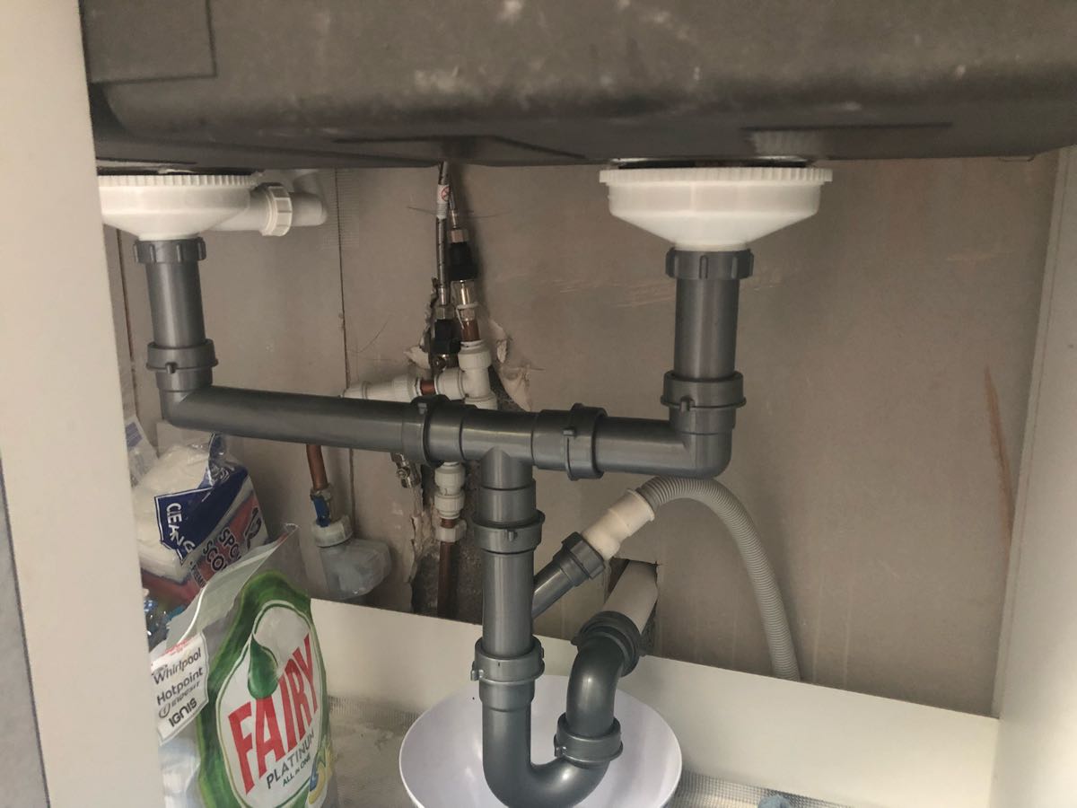

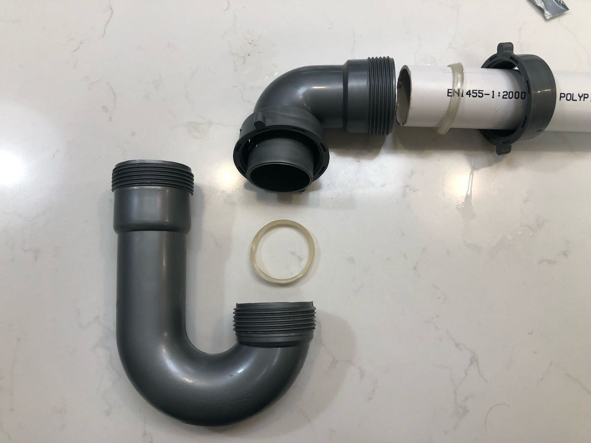

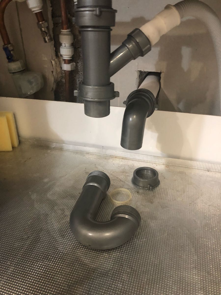

daiking Posted October 20, 2017 Posted October 20, 2017 (edited) After nearly 2 years of service, the kitchen sink waste decided to dump everything into the cupboard. The elbow piece was connected to the short leg of the u-bend. Except when I tried to refit it, I found the clear plastic ring was not pliable rubbery material but hard plastic and did not fit over the diameter of the elbow. And there is no rim or feature on the elbow to clamp everything right when I use the threaded part to tighten the joint. what gives? Edited October 20, 2017 by daiking

daiking Posted October 23, 2017 Author Posted October 23, 2017 Nope, it fits like a welly. So I’ve taken the risk of swapping the washer that fits onto the elbow and wedging the white waste pipe in till I find the correct washer
Onoff Posted October 23, 2017 Posted October 23, 2017 You could probably re-assemble what you have with CT1 and it'd go nowhere. Just clean all the parts first with Multisolve or meths. Leave to set overnight. It'd just be fun if you ever wanted to get it apart again! 1
Nickfromwales Posted October 23, 2017 Posted October 23, 2017 3 hours ago, Onoff said: You could probably re-assemble what you have with CT1 and it'd go nowhere. Just clean all the parts first with Multisolve or meths. Leave to set overnight. It'd just be fun if you ever wanted to get it apart again! I'd go with that if changing it isn't an option. There aren't any nice rubber washers with those grey setups, just the nasty nylon type which compress less than a gnats hair .

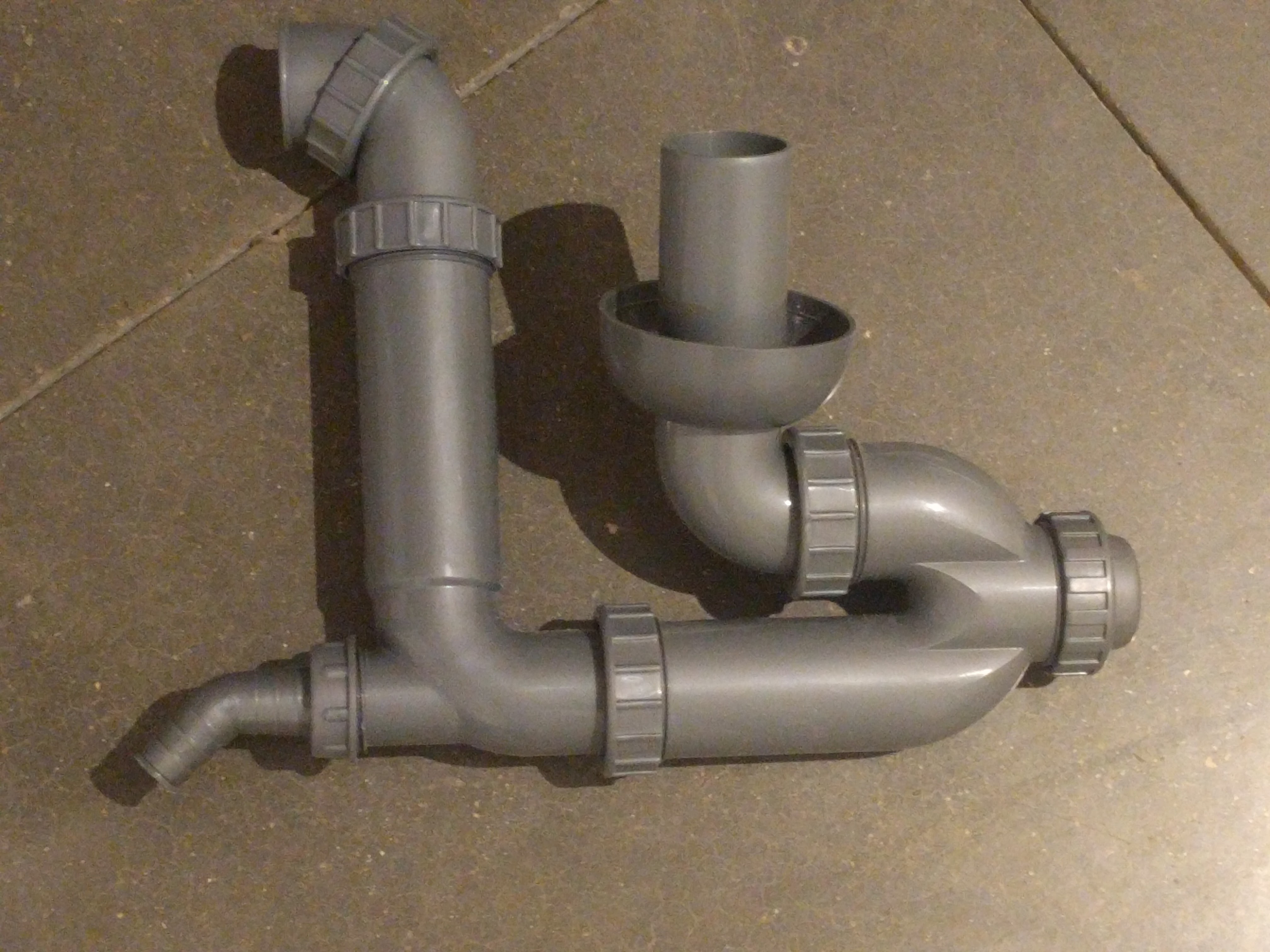

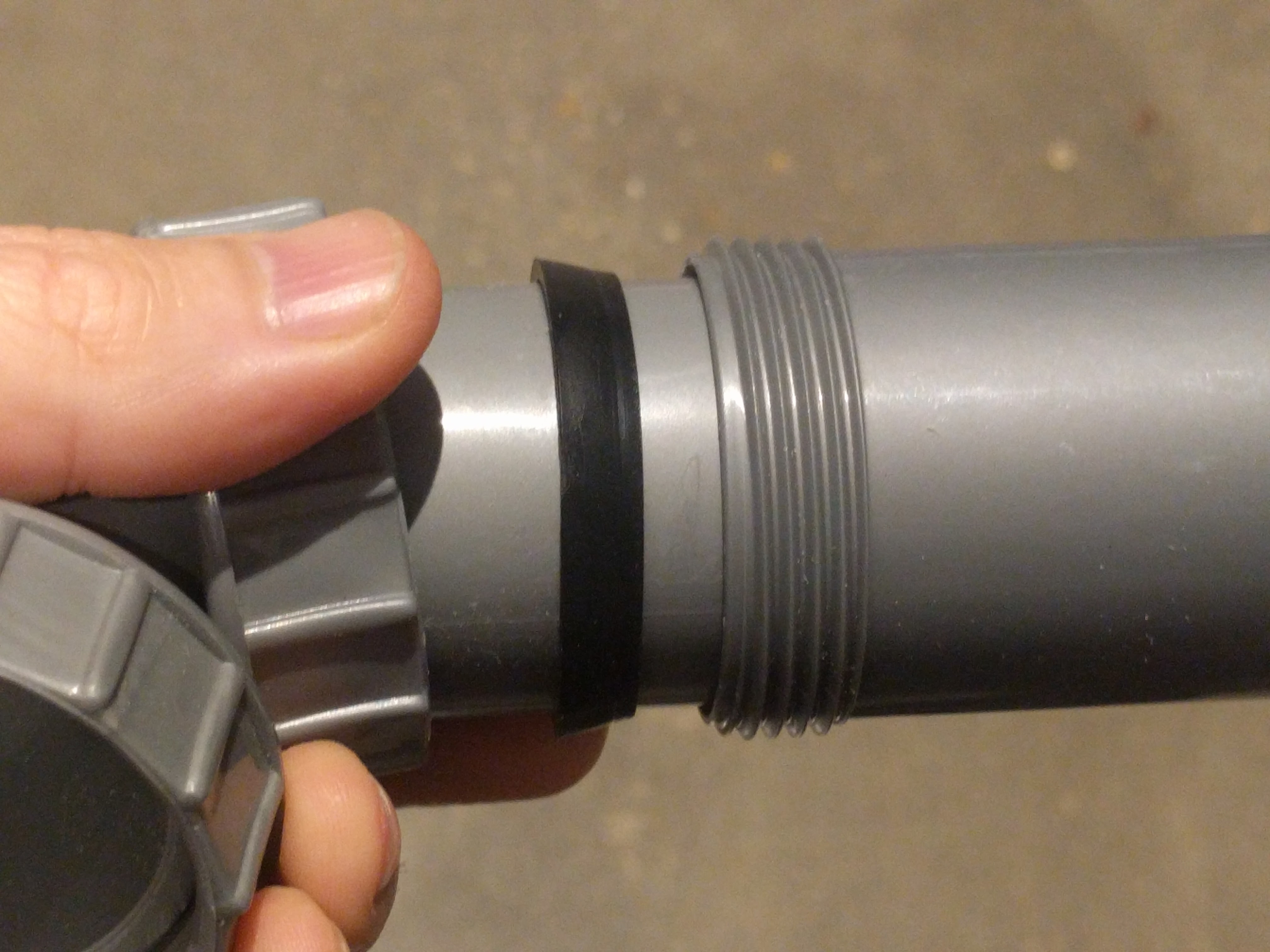

jack Posted October 24, 2017 Posted October 24, 2017 @daiking, I've got a brand new set of grey pipework that came with our Franke sink (plumbers just left it in the bag): It appears to have black versions of those clear tapered washers. Happy to mail the washers to you if they're the right size. What's the outer diameter of the pipework?
daiking Posted October 25, 2017 Author Posted October 25, 2017 1 hour ago, jack said: @daiking - BUMP! I had been away for the weekend and back to civilisation today. I may whip it out later. i am now needing a very thin washer of that type to fit the white waste pipe, presumably 38/40mm whatever it’s supposed to be. To be honest the grey pipe work barely fits on the waste pipe so wonder how these are supposed to be fitted. The grey compression bit barely moves 30mm up the pipe. It’s like that pipe has been tapered. The sink so presumably the waste trap too is a rangemaster Atlantic kube I think.
jack Posted October 25, 2017 Posted October 25, 2017 If it's the same as the one in my pics above, the washer is tapered so that it wedges into the gap between the telescoping pipes. Tightening the screw ring pushes the wedge tighter into the gap between the telescoped parts to seal the joint. The pipes are actually a reasonable friction fit on mine - the outer pipe has a slight flair to its inner edge at its end, to make space for the seal to wedge in. I've measured, and inner diameter of the seals I have is about 39/40mm. I'm happy to send you what I've got, but it'd be good to know that there's a chance it'll actually fit before I head off to the post office. Why don't you measure it up when you get the chance and let me know.
