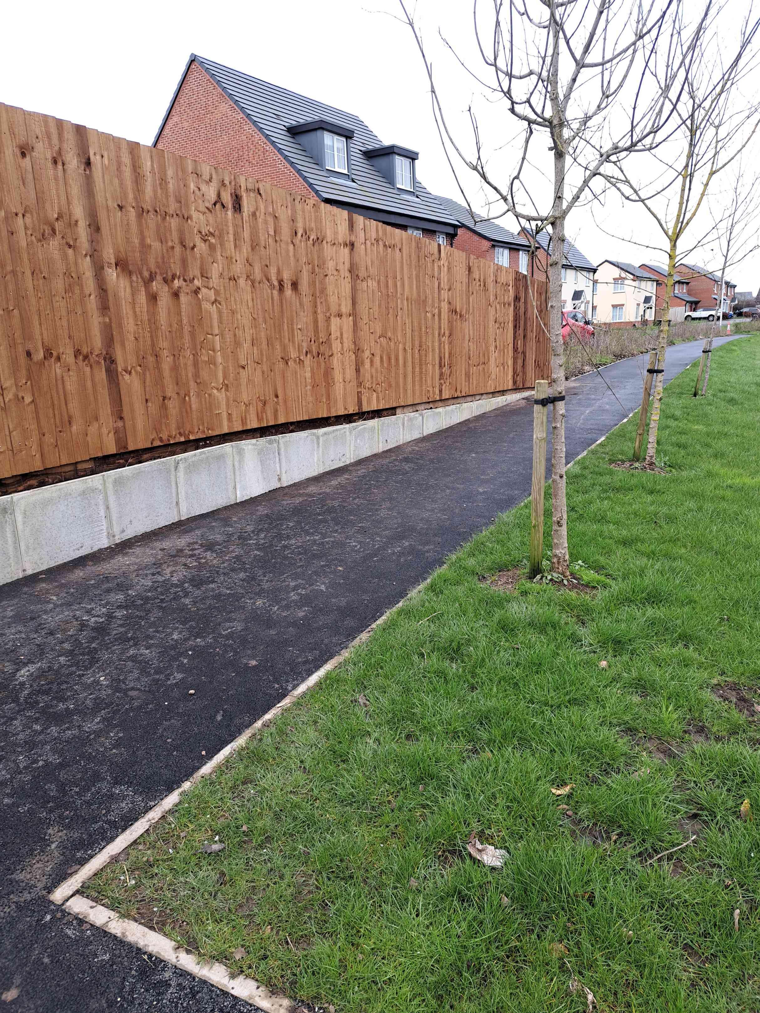

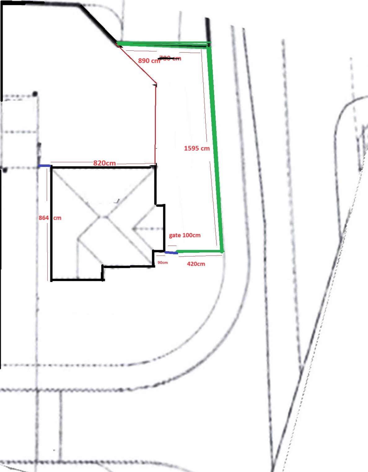

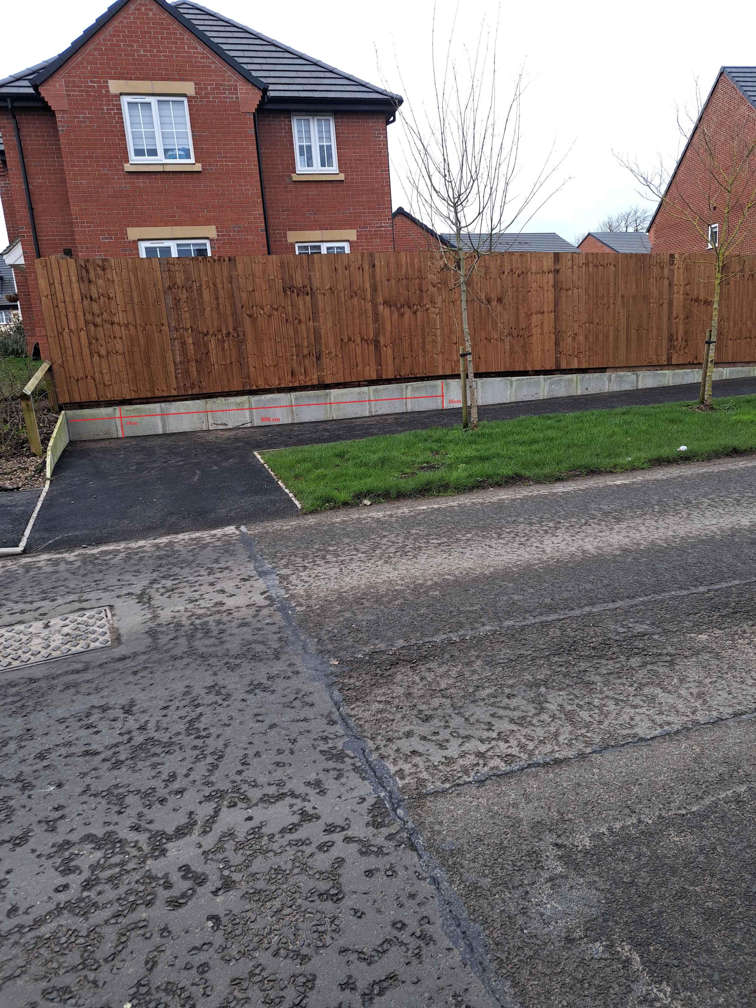

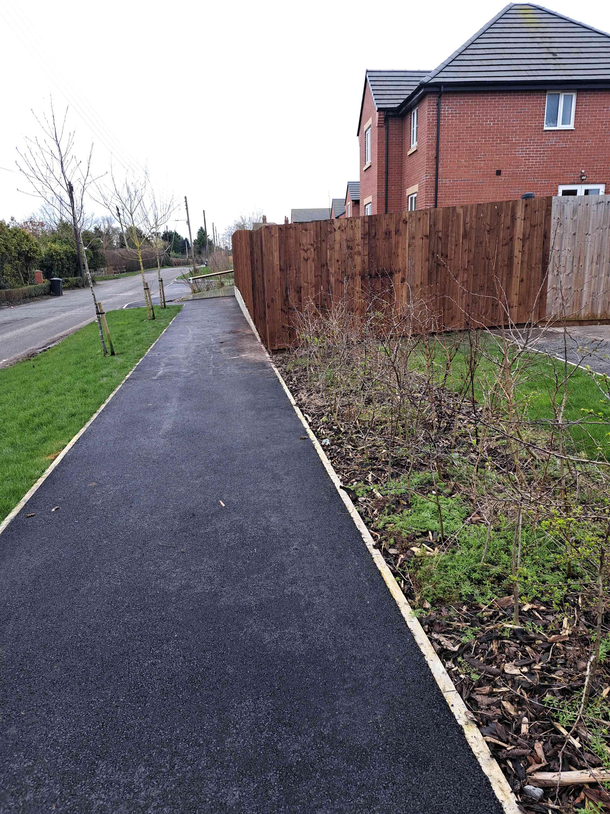

Amala Singh Posted June 17 Share Posted June 17 My house is a new build, around 2.5 years old. Extended the fence to the right side, as I own the space. In the drawing the red lines are previous fence. I extended the fence to my legal boundary limit so I can enjoy the space. The builder sent me email to take it down as I am not allowed to alter the borders , as in the deed without planning permission. So I applied for lawful development certificate. The fee is around 200+ pounds. They validated and accepted. Then came back and asked me to withdraw, as I put in a wront application type. He said fence over 1m and adjacent to highway need a planning permission. Actually everything is within planning permission. So got confused. Then asked him, if I apply as a different type, will I get permission. He said, most probably it will get rejected, as the space is supposed to be for soft landscaping. Again I got confused. It has been couple of months, I have been investigating, investigating. I didn't want to spend another 200+ for another application and get it rejected. And then google brought me here. I noticed there are some discussions already about it. I get knowledgeble every day. I went to a PP website, even paid 100+ pounds for consultation. they said spend another 700+ for planning statement, found they want to milk money with probability of positive outcome. I know from forums 'Adjacent to highway' is meant by different inspectors differently. So the council officer should have rejected my application and should have told reason than asking me to withdraw the application. It is a kind of citizen scam. To use my legal boundary, they put in too many rules. This law of 'adjacent to highway' is totally stupid. You can say it is for safety. If it is for safety reason , the law should say safety reasons. It is all presumable and gives varieties of opinions. Many places they ask to cut down the fence for drivers visibility. The hedges are allowed. If the hedges can block visibility , it is still allowed. Totally stupid again. Now coming to the point again. 'Adjacent to highway/pathway' all put together. Adjacent not defined well. Some places they ask to put back 1m. Now. my question is the pathway is divided by verge and tree is planted there. In most cases, highway, path followed by verge, here the path is split by verge. So , there is no visibility issue for drivers definitely as the fence is many meters away from highway. Now do they need to consider the visibility for the walkers as well? I have inadvertenly withdrew the application and now I am lamenting for that. I have sent an email to the council, to take the application back. Most probably they will not do so. If they refused to give me the certification instead of withdrawing it, probably they should have given some reasons, how much distance I have to leave etc? Probably I should have put in hedges in front. In the beginning , I didn't know all these nonsenses. Now what should I do? Link to comment Share on other sites More sharing options...

ProDave Posted June 18 Share Posted June 18 The planning officer is right, that is what the guidelines say, no fence above 1M adjacent to the highway without PP. You could move the fence back 1 metre, then it is not "adjacent" but that is very subjective and not defined. Or put the fence back where it was, plant a nice hedge on the boundary wait for it to grow and let the fence fall down. I have a BIL in a similar sort of house where only a fraction of the garden was originally enclosed. He now has a large garden enclosed by a Beech hedge on the boundary. 1 Link to comment Share on other sites More sharing options...

ProDave Posted June 18 Share Posted June 18 If the builder only cares that you satisfy the planners, then ask your planner what their definition of "adjacent" to the highway is? They may let you have a fence a bit closer to the highway, still with an open area adjacent to it and be able to fence off part of your garden. That would be a good compromise. Link to comment Share on other sites More sharing options...
Amala Singh Posted June 18 Author Share Posted June 18 3 minutes ago, ProDave said: If the builder only cares that you satisfy the planners, then ask your planner what their definition of "adjacent" to the highway is? They may let you have a fence a bit closer to the highway, still with an open area adjacent to it and be able to fence off part of your garden. That would be a good compromise. who the planner? Planning officer from council? They give as less information as possible , that is how they made me withdraw the application. Adjacent to high way is not a strict term by law, the authorities can decide on case by case. If the officer visited the site , how much is adjacent, In most scenarios it is 1m. But they dont want me to change anything. Otherwise I am willing to compromise, I can put back original hedges they laid, and put the fence back of it. Probably I can wait until the enforcement letter, so I can appeal and discuss. Link to comment Share on other sites More sharing options...
ProDave Posted June 18 Share Posted June 18 There have been cases on here where if you stand on the footpath and reach out with your arm and cannot touch the fence then it is deemed not to be "adjacent" but it is very subjective. Try re submitting with the fence 1 metre from the footpath, and see what they say, argue you are moved it back so it is no longer "adjacent" and you have left an open strip of land. Link to comment Share on other sites More sharing options...

Hughgo12 Posted June 18 Share Posted June 18 There are rules in place to stop people doing what they want and becoming a free for all. For example; looking at your photo it would seem that none of your neighbors have front fences, it would be common to see this on the deeds and planning in developments as there would be rules against erecting fences, parking on footpaths, leaving bins out, maintenance fees etc. But as always, some people have no regard for these and just do whatever they want 4 Link to comment Share on other sites More sharing options...
joe90 Posted June 18 Share Posted June 18 Although I have fought planners in the past and don’t have high regard for them, part of their job is to maintain a landscape that is consistent and in keeping with the surroundings for the benefit of everyone. Whilst we might not all agree with the rules I think your fence where you have built it is ugly and not in keeping with its surroundings and neighbours. 4 Link to comment Share on other sites More sharing options...

DevilDamo Posted June 18 Share Posted June 18 Your deeds state that you require Planning to alter the boundary treatments. So PD via a LDC application is not an option. You would require formal Planning for any fence, wall or gate at any height and in whatever location. It couldn’t be any clearer. Link to comment Share on other sites More sharing options...
bassanclan Posted June 18 Share Posted June 18 Unless you have taken photos from a misleading angle. There is no way that the fence is going to be ins the scope of permitted development. Your deeds remove your rights of permitted development for the fence anyway so it's a planning application or nothing. If you put in a retrospective planning application I very much doubt you would get planning permission for what you have done, nor win on appeal. You are already on the radar for enforcement action, so I doubt they are going to just forget about it and appeals etc waste your time and money. Given that the local authority have a slam dunk case and you have seemingly ignored their advice they may well seek costs and/or a fine. Be pragmatic. Eat humble pie. Listen to what they would accept. Grow a dense hedge if you really want to 2 Link to comment Share on other sites More sharing options...
