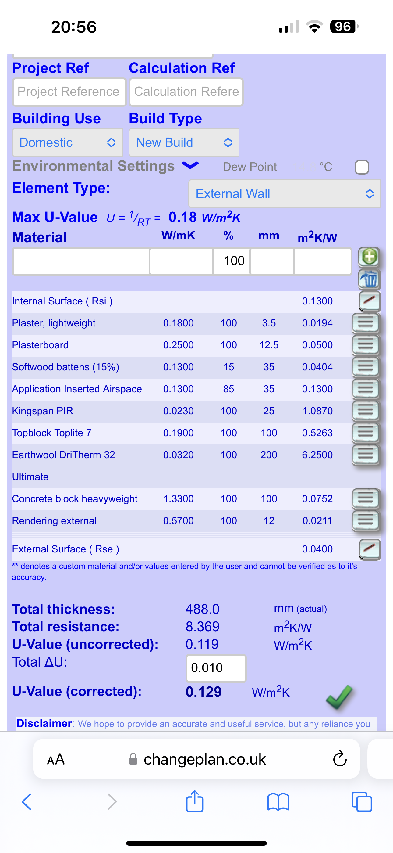

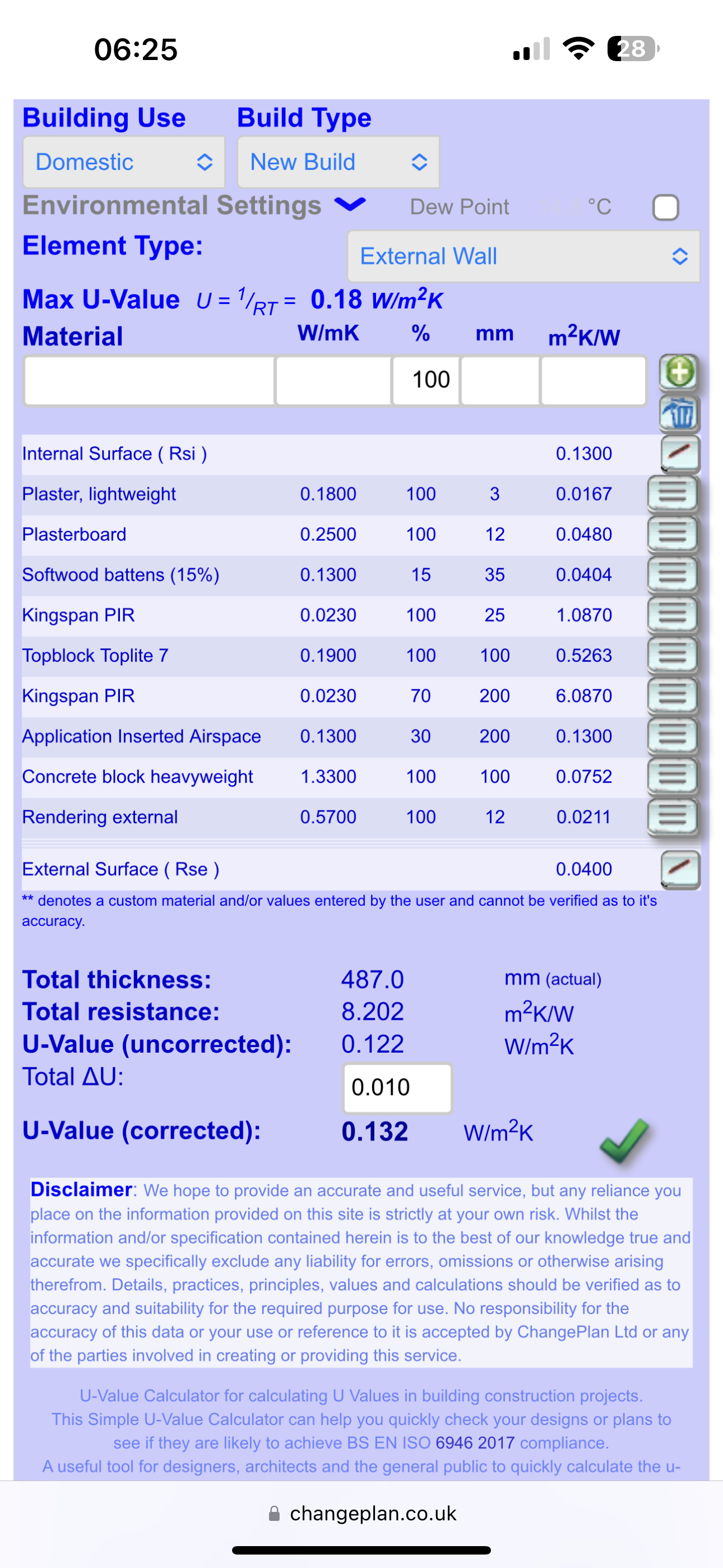

DannyT Posted June 16 Author Share Posted June 16 Thank you for all your replies. Ill take on board suggestions. First on the list is going to be to contact building control for their views on this matter. Secondly I’m going to drop the architect a email thanking him for the initial sit visit. I will then outline my reasons why I’m “adamant” I want full fill and he can come back with his reasons. However “the planning don’t like it around here” won’t cut it for me. This house needs to be done right first time. As far as I’m concerned, what ever is calculated for PIR in a cavity is way exaggerated. As joe90 also said, we also used ecotherm 32 on my uncles self build and that’s exposed to driving rain in Staffordshire with no Negative effects. I’ve been a bricklayer for 23 years, mainly on the mass produced house builder sites and I’m determined to build beyond the “norm” like many on here. I hate working on the poorly insulated and badly designed houses I build. It’s just a bit daunting going from the English regs to Scottish and their way of doing things. Thanks again Dan I have included below the 2 different wall build ups but I’ll start a new thread in correct section for that discussion. Close on paper though but I’ll never be convinced the PIR partial fill will ever be close to those figures in reality. As well as cost and time negatives over full fill. Link to comment Share on other sites More sharing options...
