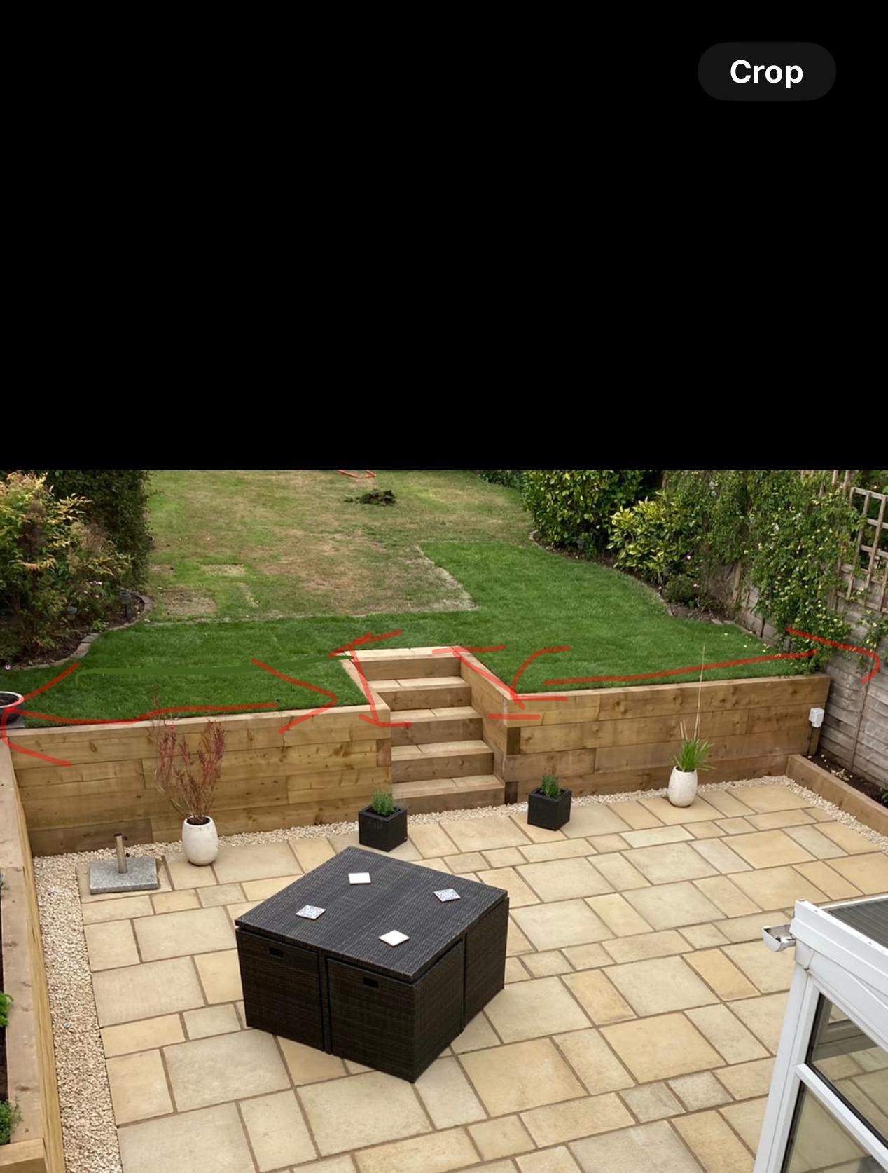

AdamD Posted June 15, 2024 Share Posted June 15, 2024 We are looking to install something along the sleeper walls in the picture, predominantly for safety as we have a toddler and a newborn, but also we want it to look nice! Glass balustrades were an option but have just had a quote of £5k for the 8.5 metres which is well out of our budget so am Just looking for some more suggestions as to what we can do? thanks in advance Link to comment Share on other sites More sharing options...
Conor Posted June 15, 2024 Share Posted June 15, 2024 I'd just put up a low level timber fence for a couple of years, your kids will soon wanting to be jumping and playing off it! Link to comment Share on other sites More sharing options...
AdamD Posted June 15, 2024 Author Share Posted June 15, 2024 8 minutes ago, Conor said: I'd just put up a low level timber fence for a couple of years, your kids will soon wanting to be jumping and playing off it! How would you fix it in, posts coming up from the stones, screwed to the sleepers and run it off that? Don’t really want to concrete into the stone border Link to comment Share on other sites More sharing options...

Moonshine Posted June 15, 2024 Share Posted June 15, 2024 I would fence posts with ground spikes in, then a slatted fence across. Height of fence would be 1.1m for building regs, but as it doesn't apply here really, as high as you want. Link to comment Share on other sites More sharing options...

AdamD Posted June 15, 2024 Author Share Posted June 15, 2024 42 minutes ago, JohnMo said: Are the sleepers pinned to each other and to the ground, or it gravity holding them there? Posts behind the sleepers which they are screwed to, and then sleepers screwed to each other Link to comment Share on other sites More sharing options...

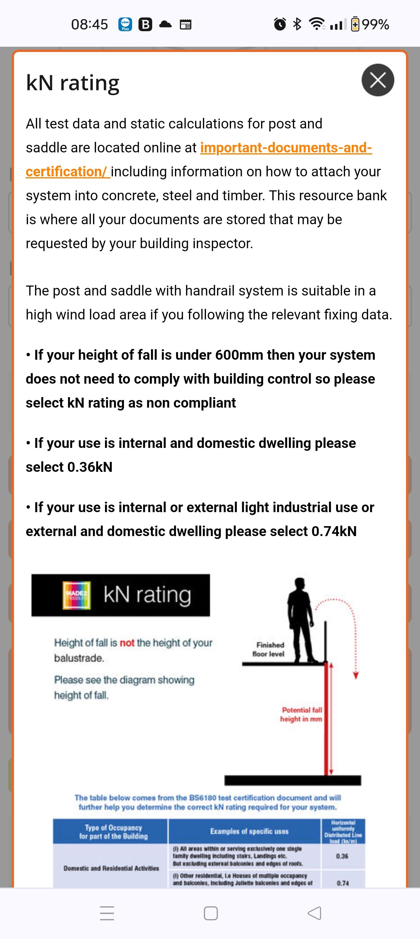

JohnMo Posted June 15, 2024 Share Posted June 15, 2024 2 minutes ago, AdamD said: Not sure why the convo has got into building regs etc! As moonshine said I’m just looking to do something to protect the toddler!! Glass ballastrade at decent prices and good delivery https://www.made2measure.co.uk/post-and-saddle-system/ Did a quick cost and it's about £1k for glass with posts Because if the fall is more than 600mm it has to comply with building regs. First bullet point in the attached. Link to comment Share on other sites More sharing options...

Conor Posted June 15, 2024 Share Posted June 15, 2024 2 hours ago, AdamD said: How would you fix it in, posts coming up from the stones, screwed to the sleepers and run it off that? Don’t really want to concrete into the stone border I'd just be putting in a picket style fence using vertical 25x50mm battens fixed to the back of the sleepers. Put some nice climbers against them. Id view it more as a deterrent for the kids to climb... Pointy sticks and growth will do that well! 1 Link to comment Share on other sites More sharing options...
AdamD Posted June 15, 2024 Author Share Posted June 15, 2024 1 minute ago, Conor said: I'd just be putting in a picket style fence using vertical 25x50mm battens fixed to the back of the sleepers. Put some nice climbers against them. Id view it more as a deterrent for the kids to climb... Pointy sticks and growth will do that well! Back of sleepers no accessible as is backfilled Link to comment Share on other sites More sharing options...
AdamD Posted June 15, 2024 Author Share Posted June 15, 2024 1 hour ago, JohnMo said: Glass ballastrade at decent prices and good delivery https://www.made2measure.co.uk/post-and-saddle-system/ Did a quick cost and it's about £1k for glass with posts Because if the fall is more than 600mm it has to comply with building regs. First bullet point in the attached. That looks good. What length did you put in to get it to around 1k? Seems more than that for me Link to comment Share on other sites More sharing options...
joe90 Posted June 15, 2024 Share Posted June 15, 2024 5 minutes ago, AdamD said: Back of sleepers no accessible as is backfilled If posts are driven down the back of the sleepers and fixed at the top this will resist any leverage. Just don’t put horizontal timbers that can be used as a ladder by the kids, vertical picket style much safer (and prettier IMO). Link to comment Share on other sites More sharing options...
JohnMo Posted June 15, 2024 Share Posted June 15, 2024 31 minutes ago, AdamD said: That looks good. What length did you put in to get it to around 1k? Seems more than that for me Two L shapes 1.5 x 3m. 1 Link to comment Share on other sites More sharing options...
