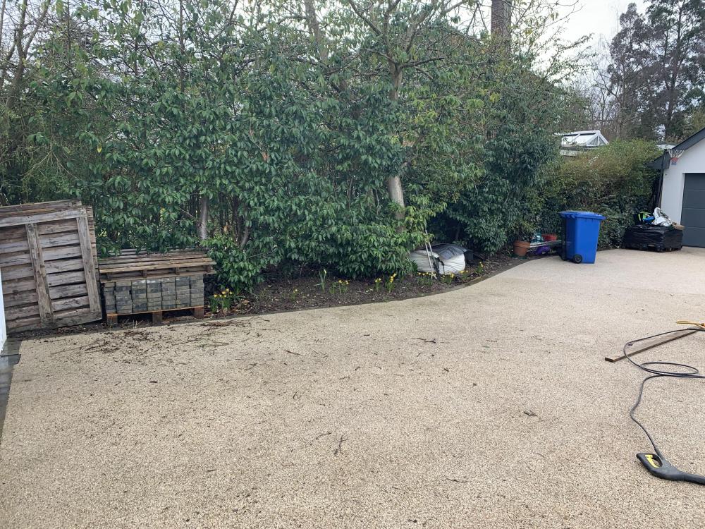

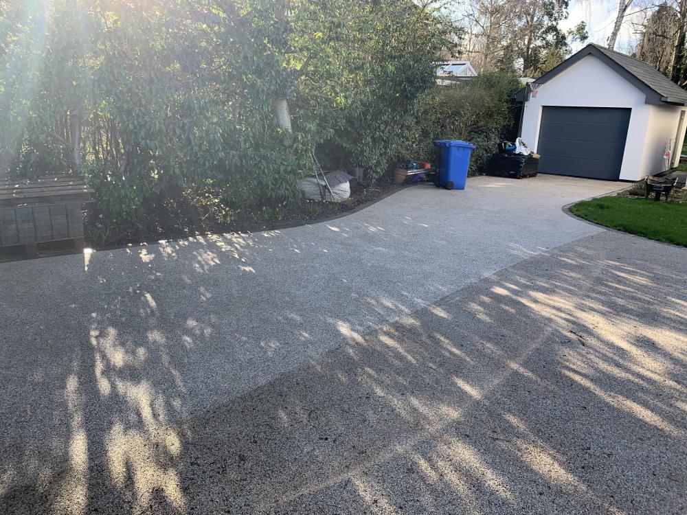

Big Jimbo Posted February 29, 2020 Share Posted February 29, 2020 That has come up well Bitpipe.The One in the video above, still looks a bit naff when he has finished. Link to comment Share on other sites More sharing options...

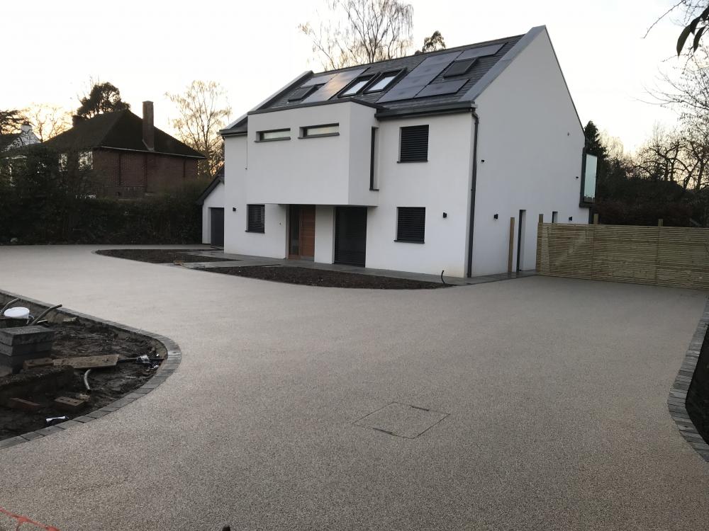

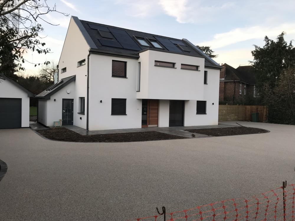

Bitpipe Posted February 22, 2021 Share Posted February 22, 2021 12 minutes ago, Petey said: Some really good info here guys thx. Im leaning towards getting a resin bound drive now but am worried with the maintenance as one guy said its a bit overrated and whilst it looks nice on day 1, tyre marks will eventually ruin in especially if coming back from a long journey on a hot day. Just wondering if anyone had any experience on that? Had mine down since Jan 2018 and, when cleaned, looks almost as good as new. Like any exterior surface, if you ignore it it will get grubby. Get a jet waster with the patio attachment and give it a scrub in the spring. Stiff brush or blower good for moving leaves etc in autumn. Use a reputable trade - quite a few chancers out there. My guy had the bespoke 'candyfloss' style mixer. If they're using bell mixers, run away. That whole area was laid in one day so no joins. 1 Link to comment Share on other sites More sharing options...
