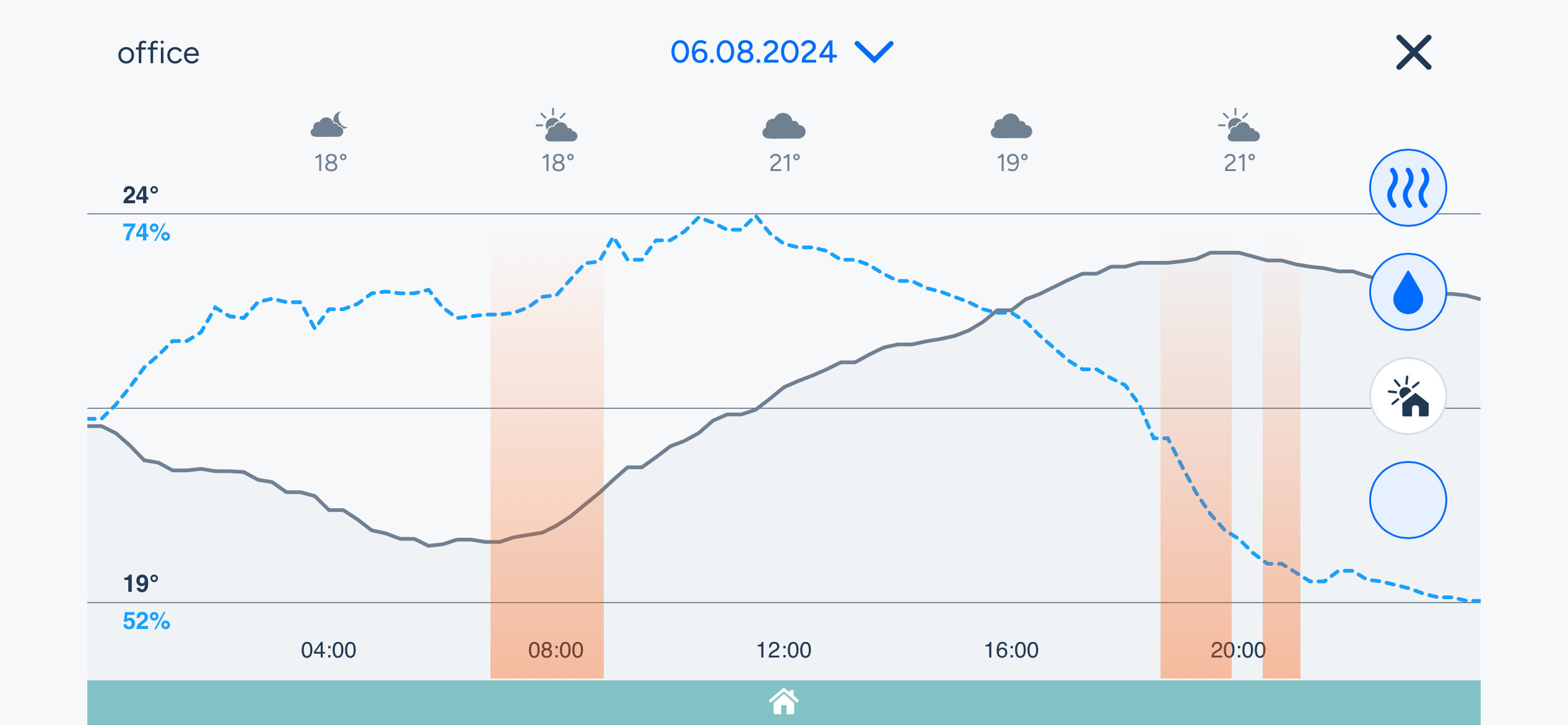

SteamyTea Posted August 5, 2024 Posted August 5, 2024 1 hour ago, Adsibob said: I do. The only problem is that I have it individually for each room of the house and you can only see the data 24hr at a time. Easy enough to concatenate files with the command prompt:
JohnMo Posted August 5, 2024 Posted August 5, 2024 Think if your design requires a tight control on internal or external humidity, I think you change design. Summer humidity even with MVHR is all over the place, especially if you are cooling, have the windows open or both. We were hot this morning, cooling on (always on really in summer) 59% at midnight and by 8am at 69%, house basically cooler than outside. House between 20 and 22 outside 22 to 25. Over the last month has been mid 50s and above.

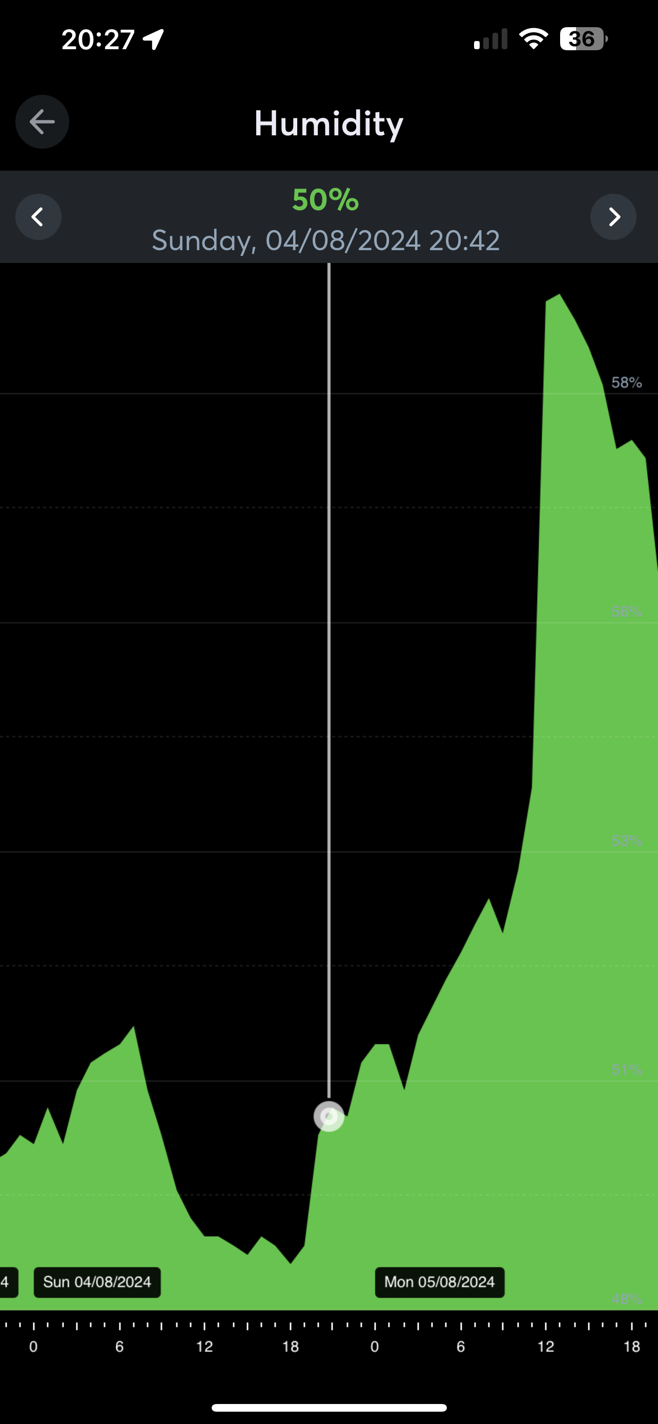

Adsibob Posted August 7, 2024 Posted August 7, 2024 2 hours ago, Mike said: I'm sure that I can manipulate data provided in any format, by the minute, day or whatever, as long I know what it all represents. I’m not sure you can if the “data” is basically an image, like this, for each room of the house and for each day of the year:
Mike Posted August 10, 2024 Author Posted August 10, 2024 On 07/08/2024 at 19:42, Adsibob said: I’m not sure you can if the “data” is basically an image, like this, for each room of the house and for each day of the year: Yes, somewhat tricky if you have no access to the data...

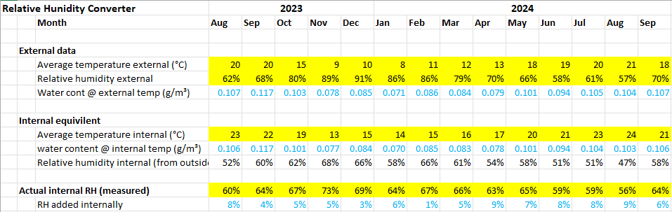

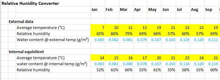

marshian Posted October 7, 2024 Posted October 7, 2024 As I said earlier I've been logging for a while My External Sensor (Tempo and Humidity) is actually in a well ventilated loft My Internal Sensor (Temp and Humidity is in one of the bedroom) Hopefully this table will work OK Month Avg External Temp Avg External Humidity Avg Internal Temp Avg Internal Humidity Aug-23 20 62% 23 60% Sep-23 20 68% 22 64% Oct-23 15 80% 19 67% Nov-23 9 89% 13 73% Dec-23 10 91% 15 69% Jan-24 8 86% 14 64% Feb-24 11 86% 15 67% Mar-24 12 79% 16 66% Apr-24 13 70% 17 63% May-24 18 66% 20 65% Jun-24 19 58% 21 59% Jul-24 20 61% 23 59% Aug-24 21 57% 24 56% Sep-24 18 70% 21 64% Interested in Mike's xls sheet I plugged this years data into it 1
Mike Posted October 7, 2024 Author Posted October 7, 2024 Thanks @marshian - great to see some real data :)

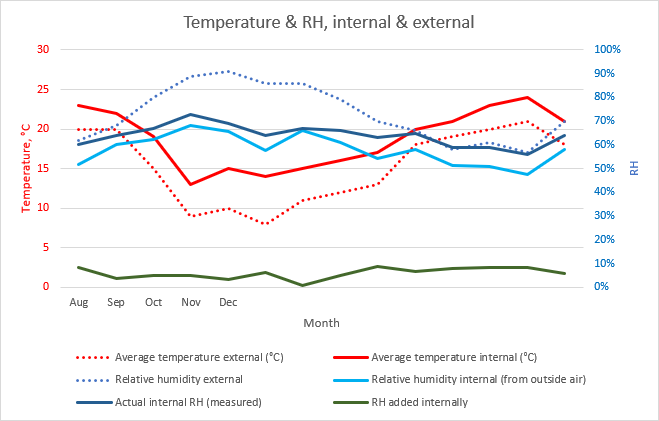

Mike Posted October 7, 2024 Author Posted October 7, 2024 39 minutes ago, marshian said: Interested in Mike's xls sheet I plugged this years data into it I've added the rest, plus an extra line to separate out how much additional humidity is being added internally (as opposed to due to the humidity of the external air): And turned it into a graph: Very helpful - thanks again! 1

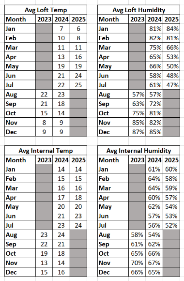

marshian Posted July 27, 2025 Posted July 27, 2025 On 07/10/2024 at 22:56, marshian said: On the run time - it's basically set to when we aren't home or are asleep Power consumption is 9W when running so from memory I must have set it on either 3 or maybe 4 out of the 6 settings - It's been a long time since I changed the speed Claimed air volume on each of the power settings is Setting Litres/sec Litres/min Litres/Hr Hrs for 1 AC 1 10 600 36000 8.08 2 20 1200 72000 4.04 3 30 1800 108000 2.69 4 40 2400 144000 2.02 5 50 3000 180000 1.62 6 60 3600 216000 1.35 The Hrs for 1 AC (OK I know it's not going to drive all the air out there is going to be some mixing) are what I calculated based on volume of the house. Just to add Setting 2 has been my winter setting but Setting 4 has become my go to setting for spring summer and autumn Reason is adding insulation to my loft has resulted in an increase in loft temps - the PIV cuts out if loft temps get over 27 deg C So it's running half the time it would during winter so I've increased the flow rate and it seems to work nicely - especially at night when the loft temp rapidly falls and it's helping to cool the bedrooms during the night. The silver fan of doom hasn't been deployed yet this year (Mrs Alien doesn't like it hot in a bedroom in the summer so despite the fact she's a light sleeper the fan gets deployed and as it's a constant noise she copes with it - I can't stand the noise it makes although I can sleep thro a hurricane I can't get to sleep in one so dislike the fan being deployed) In spring / autumn during the day it does a reasonable job in transferring warm loft air to a cooler house
Mike Posted July 27, 2025 Author Posted July 27, 2025 As a brief update to my initial post, with the information provided here - thanks again - and some data donated from elsewhere, I did come up with a 'best-guess' internal climate to use in WUFI. The results suggested that biggest risk of moisture build-up was caused by adding any sort of VCL, so there isn't one - but that's with MVHR, in a French climate, and with low external moisture penetration. I did rig up some sensors before fitting the insulation and will be monitoring the internal environment too, so hope to have some real data to share at some point. That will take at least 18 months though, as neither the sensors nor the MVHR are switched on yet, apart from to run spot-checks.
marshian Posted July 28, 2025 Posted July 28, 2025 12 hours ago, Mike said: I did rig up some sensors before fitting the insulation and will be monitoring the internal environment too, so hope to have some real data to share at some point. That will take at least 18 months though, as neither the sensors nor the MVHR are switched on yet, apart from to run spot-checks. Data is always good - I'm seeing an improvement in both internal humidity levels as well as loft humidity levels Changes have been driven by Improvements to loft insulation (from 75mm to 300 mm) and ventilation (eaves trays and gable end vents) (Loft temps are rising, humidity levels are falling) Changing the speed of the PIV unit for the shoulder and summer months (Increased Air changes and air supplied from the loft is drier) I was tempted to move my internal temp and humidity monitor as it's in a relatively cold room compared to the rest of the house but because it's always been there I'm reluctant to have a change in data. Add to that the insulation levels above the room have been improved I'm hoping I can heat 24/7 without setbacks 2
