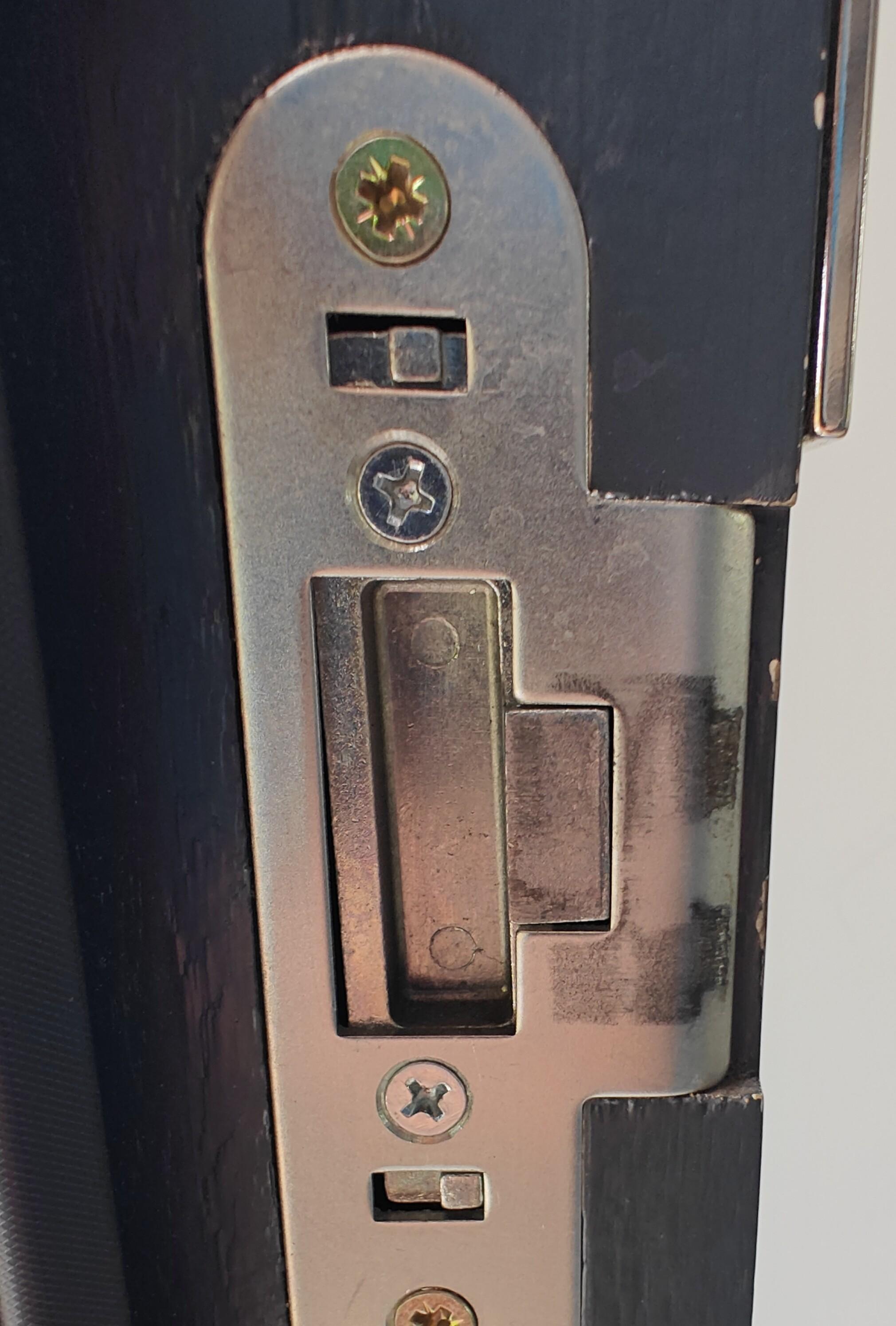

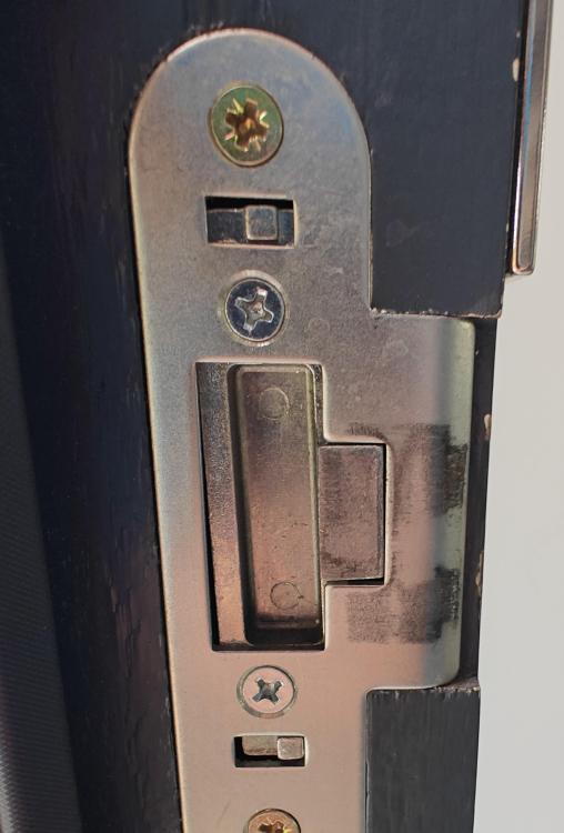

JohnMo Posted June 9, 2024 Posted June 9, 2024 10 minutes ago, Iceverge said: Whatever you pick, make sure you have good compression seals, joined properly at the corners (not just loosely butt jointed). Preferably 3 layers of sealing and multiple locking points to ensure they squeeze tightly to all sides. Another thing I found useful this winter as an adjustable door catch. The door sealed well when locked, but was drafty when not. A quick adjust of the catch airtight again. Loosen the two silver screws and the stepped piece can be moved in or out. Adjusting the door to seal compression. 1
