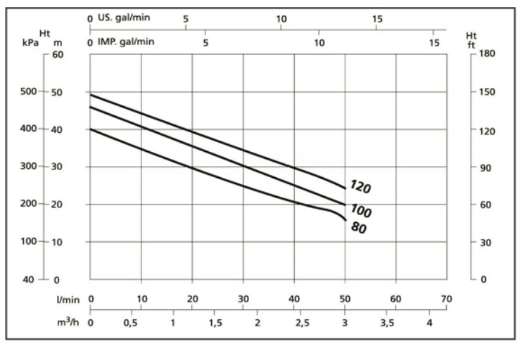

6 minutes ago, sharpener said:
pump is pretty noisy (?cavitation?)
Possibly caused by your longish uphill suction line. The pump is starting to pull a vacuum and this causes cavitation. You need to look at on the data sheet, at the NPSH(r) or net pressure suction head (required). This is amount of upstream pressure the pump needs to stop cavitation. Ideally a neg value would be good, then the pump can pull the water in uphill and with pipe/strainer pressure losses be away from cavitation.
Maybe, I had thought it might be, certainly doesn't sound very nice. But there is no info on the data sheet about this, it is pretty sketchy. No signs of erosion though when I had it apart after several years' use to discover the cracked shroud.
The info about the reduction in flow vs suction head copied above is actually taken from the  data sheet for an earlier ST jet pump, now discontinued, but I imagine they are all pretty similar. That model was supposed to cope with a suction lift of 7m (presumably without cavitation), and at low flows the pressure drop we need to add to take a/c of flow resistance will not be much (certainly compared with 20m of underground delivery pipe).

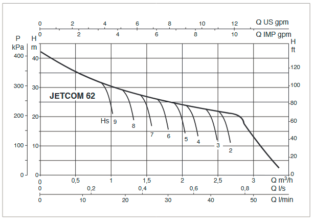

The DAB Jetcom 62 is a bit better and will cope with a 9m suction head but has a somewhat higher max power consumption, 850W. The small Clarke is 800W, so the ST Jet 55-45 at 650W is the best of the three if max power consumption is the chief criterion.

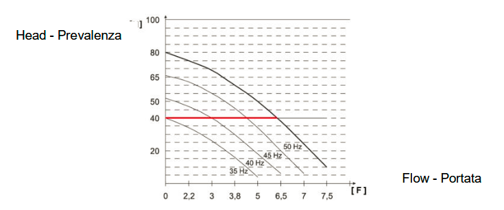

I see the inverter instructions say
"For having correct behaviours it is essential to choose a
pump with slope characteristic curve (see fig.), usually
multiimpeller pumps; this kind of pump permits the
Epower to pilots pump at variables speed.
The head and capacity of the pump must correct for
request of the plant."
So if it has to be a convex characteristic and the pump has a straight line as upthread maybe the inverter s/w can't find a proper working point on the curve. N.b. this is not a multi-impeller/multistage pump. (The English "three-stage pump" on p.9 is a mistranslation of "pompa trifase").
The inverter drive has a lot of programmable functions. Maybe one of the limits (?voltage ?frequency ?pressure) is set inappropriately. There is a factory reset that can be applied to go back to the default settings, p.33 code 76.

Looks OK and is suggested for this application. But the 1200W version would probably be too big for the Victron inverter if you did not have a soft start. Inductive loads such as motors are not in themselves a limitation, the inverter is specified for a power factor of 0.8 anyway. I would guess the 800W single phase version would be OK. Maybe you could keep the pump but replace the motor with the 800W single phase one?
Should be capable of a reasonable suction lift, they don't show the figures but DAB and ST will do 9 and IIRC 7 m respectively. The effect from the graphs seems to be to restrict the max flow, but not to reduce the delivery pressure at lower flows.
What do Steelpumps technical say about using it with such a long suction line?
Is there a pinhole air leak in the suction line somewhere? If you leave it overnight is the foot valve or NRV sufficient to prevent any drop in level?
As a sanity check this online calculator says 25m of 28mm plastic pipe will require 105mbar of head for a flow of 20 l/min. So will add 1.05m to the suction lift which is reasonable. Velocity of 0.8 m/s is also reasonable. For the fittings assume 1m extra length per elbow, but it will not make much difference.
