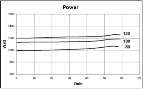

    We run one of these:   https://www.electroil.it/en/p-23-inverter-archimede-immp11w.html   Approx €350 on fleabay   With a VS2/14 GRĘŽINIO SIURBLYS FRANKLIN VS 2_14 0.75

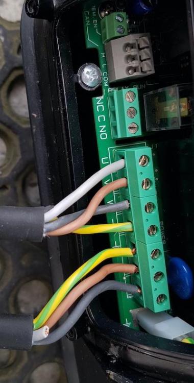

With a VS2/14 GRĘŽINIO SIURBLYS FRANKLIN VS 2_14 0.75kW 230V.pdf borehole pump ~ 40 metres down and providing 3 bar head at ground level for domestic use. Deffo doesn't run at 100% most of the time.
It doesn't however provide a residual 3 bar head if you're using a 32 mm pipe to fill a bucket. The pressure drop of the pipework between the pressure sensor and the bucket isn't enough. It will then run at 100%. (and most of the water will bounce off the bottom of the bucket and hit you in the face)
Note that a "2 bar" pump might only deliver 2 bar at zero flow; or full flow at zero bar; and half flow at half the rated pressure would be expected. All about the pump curve but marketers can be misleading...

I've studied both your units on their web pages but am not entirely clear... Your combo is a single phase fixed speed pump converted to variable speed (constant pressure) by the Archimede sensor/control unit?
Seems more advanced than simple ON/OFF control, according to pressure, like the £20 https://www.ebay.co.uk/itm/272751286212 that @JSHarris describes in his system.
@SteamyTea Thanks. Using that calc it looks like a 400W submersible should be more than enough for me (confirming @JohnMo's advice).

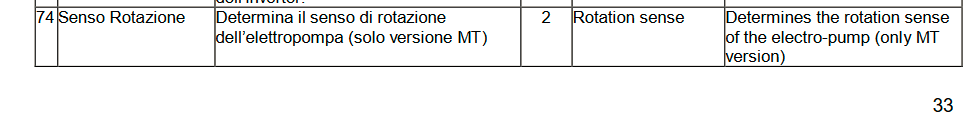

@markocosic Sorry, just found more info on that inverter and that answers my question. It does control motor speed, even single phase motors. Also has dry run protection.
Yes.
If I had our time again I'd use a three phase pump to reduce any potential for reverse rotation; but the wide head ashtray bought a single phase pump before this and intended to use it equity a basic pressure switch.
Just install a check valve on the discharge side of the pump, no reverse flow, no reverse rotation!
Check valve present. Still technically possible to reverse rotate a single phase pump even with this if you catch it at the right moment. Impossible to reverse rotate three phase pumps though; easier on wiring/currents/harmonic noise/capacitors in the inverter, no need for starting cap etc. Why wouldn't you?
Forced cooling doesn't appear to be neccessary on that inverter in a northern climate for what it's worth. Accidentally tripped on overheat - once - when testing with it laid horizontally on the floor and filling the sewage treatment tank. Else fine doesn't get warm enough to need fans that can make noise and fill with dust.

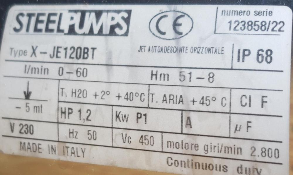

We have a similar setup, with a 5 cu m rainwater tank just below ground level, with a Stuart Turner jet pump and pressure-sensitive control switch, conceptually the setup works fine for a two-story house even with a longish suction line. The response to a tap being turned on is pretty instantaneous as I think the elasticity of 25+ m of 20mm underground delivery pipe provides something of a buffer. It only runs when water is being drawn off so its consumption is not a problem even when we are running off our battery after dark.
The pump stopped achieving adequate pressure and after fruitlessly replacing the controller with one from Clark it took a lot of further effort to discover the reason was a hairline crack in the plastic impeller shroud which was I think causing a sufficient internal leak to negate the jet pump action. This was the second time it had failed, previously I had had to replace it because of a leaking shaft gland but at least I had enough bits left to make one working pump again.
They are only warranted for 1 year and no spares are available, Stuart Turner buy them in from the Far East and regard them as non-repairable (and their customer service was rubbish) so if it fails again I will replace it with a similar jet pump from DAB as it has a 2-yr warranty and you can get spares for it.
So I would think this DAB pump would suit your application pretty well, and installed above ground is more accessible than a submersible.

@sharpener Thank you, that's extremely helpful info.
I didn't know about jet type pumps and it sounds ideal. Steelpumps who make the pump I already have (and isn't working well as an above ground suction pump) don't seem to do them, or the UK agent doesn't import them.
I'm understanding now that submersibles use less power than pumps that have to suck water from below them, so that's probably the way I will go because of my winter power scarcity.
