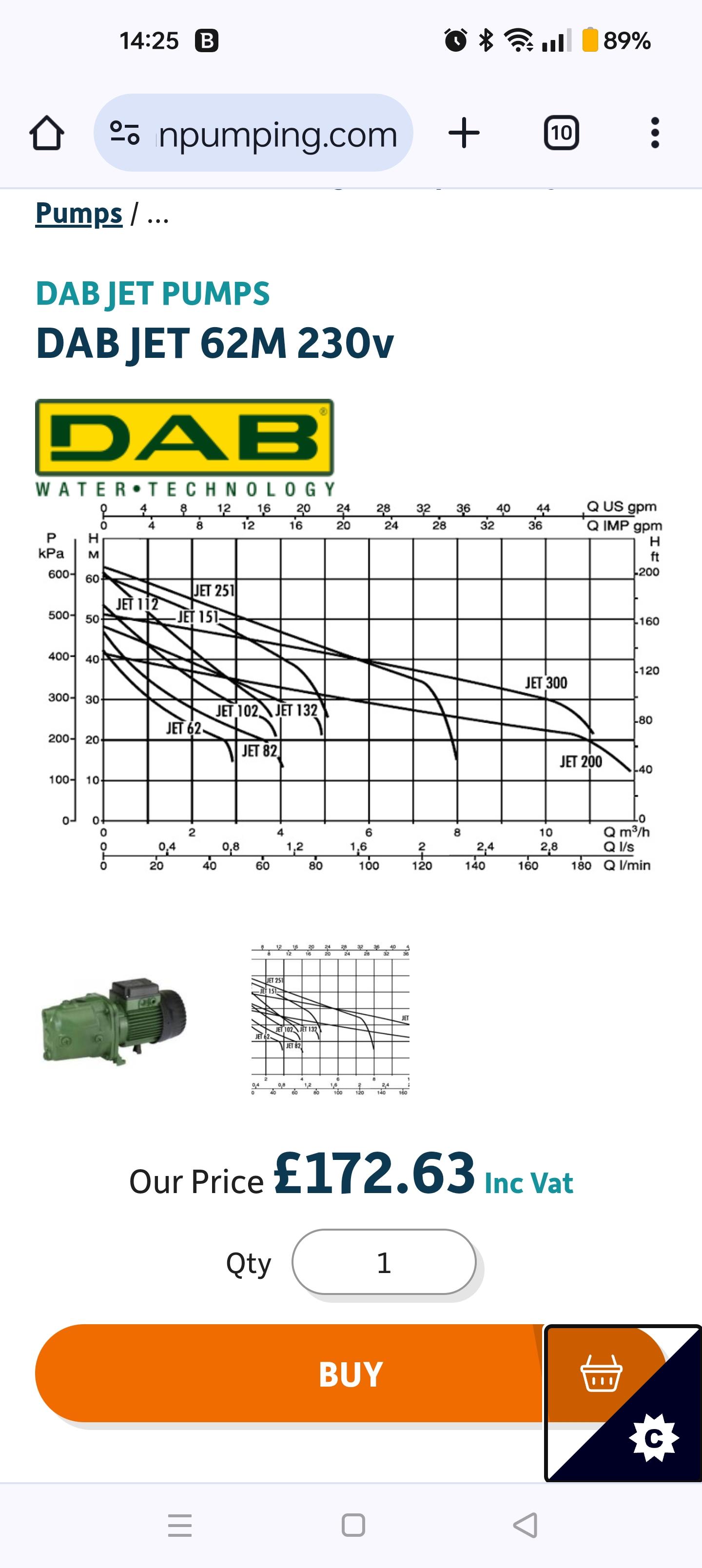

The DAB Jetcom 62 is a bit better and will cope with a 9m suction head but has a somewhat higher max power consumption, 850W. The small Clarke is 800W, so the ST Jet 55-45 at 650W is the best of the three if max power consumption is the chief criterion.
so it all depends on whether you want to stick with Steelpumps, go for something that also has spare parts availability and the best suction lift (DAB), for the lowest power consumption but not repairable (ST) or for the really cheap and cheerful option (small Clarke). Given the price of the Steelpumps option and that the rest are quite close I think my favourite would be the DAB62 e.g. from here, I see they also stock the Clarke controller which I have found works fine.

Pump run on pressure and volumetric flow curve. The more flow the lower the head developed. If you are running out of an unrestricted pipe it will never develop much head.
So for example the Jet 62, produces around 16m head (approx 1.6 bar) at full flow and 40m head or 4 bar against a closed discharge.

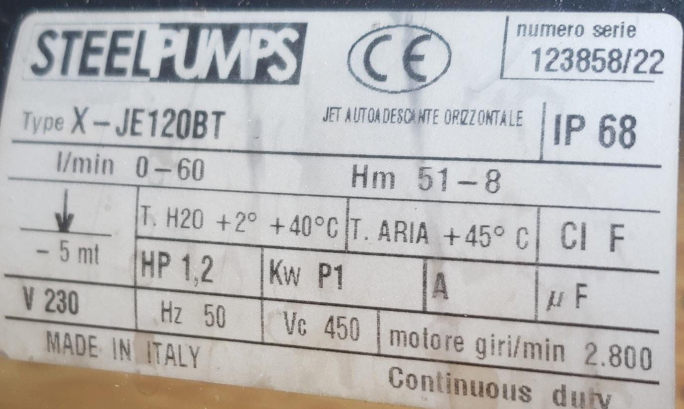

Can anyone please confirm from the label that my pump is indeed the 3-phase version of the pump (and not the single phase version)?
I am guessing that the "Vc 450" means it is?
Hi again @Hastings. The X-JE120BT does have a three-phase motor according to the FAQs here and this catalogue page, I think the T is the Italian for Trifasi. The fact that the space on the rating plate for capacitor size is blank is consistent with that bc it will not have a capacitor (but not conclusive, the Amps space is blank too). I am not sure what the Vc is, perhaps the voltage rating of the capacitor when one is fitted (single phase models only).
What colour wires does it have? I would expect a 3-phase motor to have 4 cores, viz 3 phases and one earth. If you have a multimeter and it is not damaged you should get the same resistance reading between any two of its phase wires (three identical readings in all).
I think the "230" on the rating plate confirms it is the T230 model which has the correct windings for a continental delta-connected 3-phase supply suitable for the VFD (see my queston upthread). So do not connect it to a UK star-connected 415V 3-phase supply or you will burn it out.

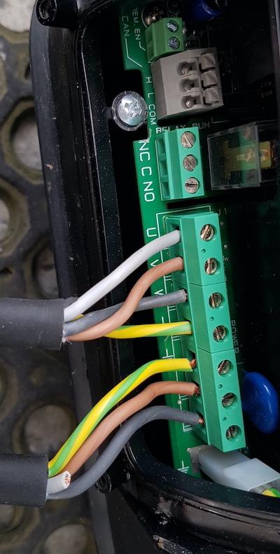

I had forgotten that the pump does indeed have 4 wires which are for 3-phase connection.
Is it possible that I wired it up wrong? I assume that if I had wired it wrongly then it would not run at all or run in reverse or something else other than pumping poorly.
Doubtful, you do not say the colours but I would certainly expect the earth to be green/yellow. Phase wires might be all brown (possibly numbered 1,2,3) or brown, grey, black, or something else.
Have you disconnected the motor from the VFD and reconnected it? It is possible you have got two wires swapped and the motor is running backwards, it might still pump after a fashion even so.
IIRC there is something about this in the VFD instructions, failing which swap any two of the phase wires with each other leaving the third as it is, see if it goes any better.

Ah, you are correct, thank you. My pump is a speed controlled version - has a separate box/inverter with it to control speed and  set the switching pressure - the graph I posted above must be for the pump alone.

It has been disconnected for shipping back to the supplier (the pump and controller units in separate boxes) and then back to me. Maybe they wired it differently for their tests. The wiring I have used is according to a colour diagram label on the pump body but the electrician gave me a different mapping over the phone (he didn't sound too sure and so I chose the former).
I don't recall if I checked this with Tom at 3PTechnik. Perhaps the one on the pump is for Italy 3-phase and different to UK 3-phase .
Wiring for my pump (Output:grey, brown, black green/yellow. Input 240V) within the controller:
Edited by Hastings
Can't see any colour code for the connections mentioned in the VFD instructions, sounds as though it may be arbitrary. Is there a direction arrow on the body of the motor or pump? (I appreciate it is a packaged unit so may not be possible to see which way it is rotating.)
Try swapping e.g. the brown and black at the terminal strip and see if it is any better. It is not likely to cause any harm for a short test run.
I see you can also do this in the VFD software settings but personally I would swap the wires to be more confident that the test has actually been performed.

The installation manual for the controller says:
"Connect the output cable (ground, triple-phase, screen) to the 3-phase pump using triangle configuration 230Vac."
I have been studying online resources on "triangle configuration 230Vac" but am unable to interpret it.
Controller manual also says to contact the manufacturer MAC3 if using with a generator and/or UPS.

@sharpener Just to be certain, I need to swap brown-black on the 3-phase output, not the input terminal?
Yes swap the wires going to terminals marked V and W. Good luck!

Try delta.
As it's a matched VFD I'd expect the colours codes to be a match but it's but a moment's work to swap any two phases over and re-try.
