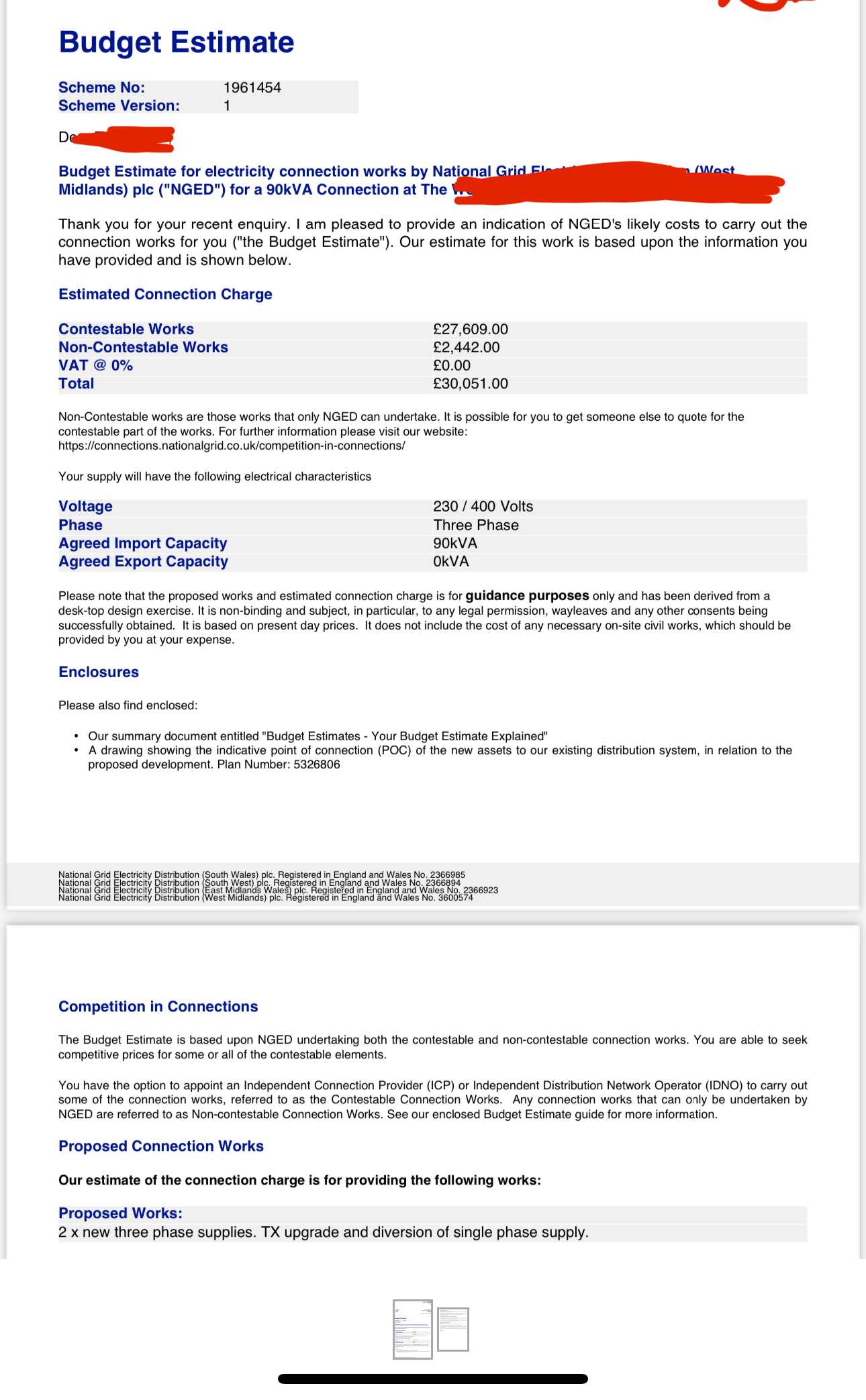

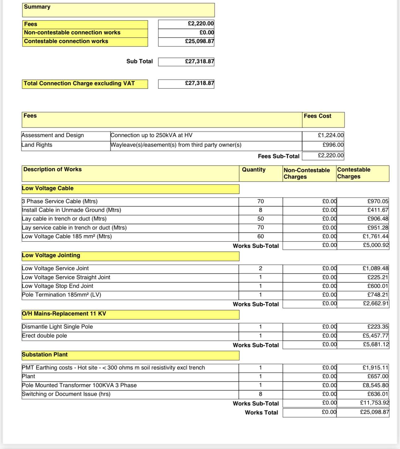

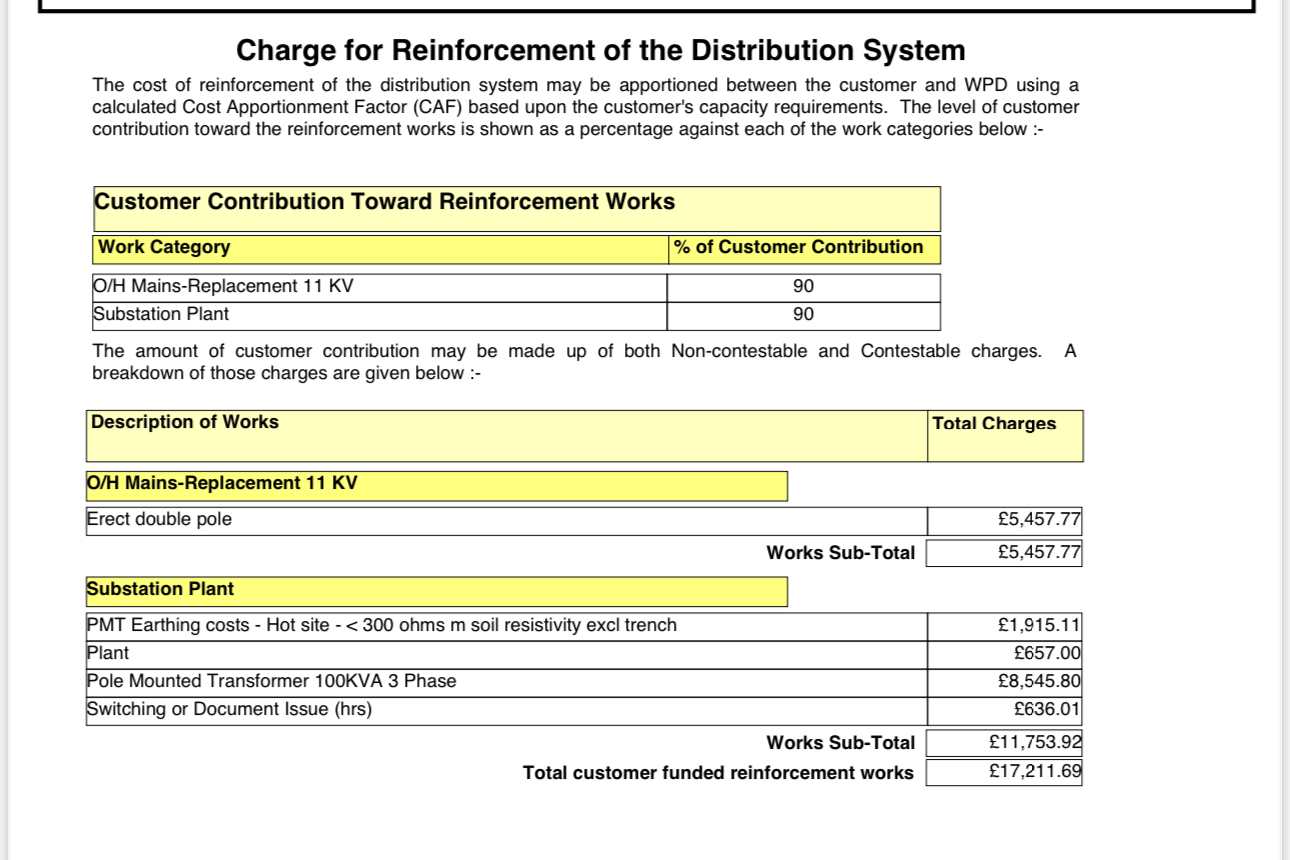

Trw144 Posted November 16, 2024 Share Posted November 16, 2024 Rather than a new thread I thought I may as well tac onto this one.... I have just had a budget cost for a new electrical connection. It's two new build houses, and then potentially changing the house already connected from single phase to three phase. I originally had it quoted prior to April 2023 (budgeted then was £23k), I held out at the time thinking the changes to how network upgrades were costed would benefit me but have just had a quote for £30k. I've attached the budget quote and breakdown, and also how much of the upgrade I appear to be contributing to (90%!). I must admit I don't fully understand how the whole costings work and if I have any case to argue this is for "re-inforcement assets" as mentioned in the thread. Link to comment Share on other sites More sharing options...
