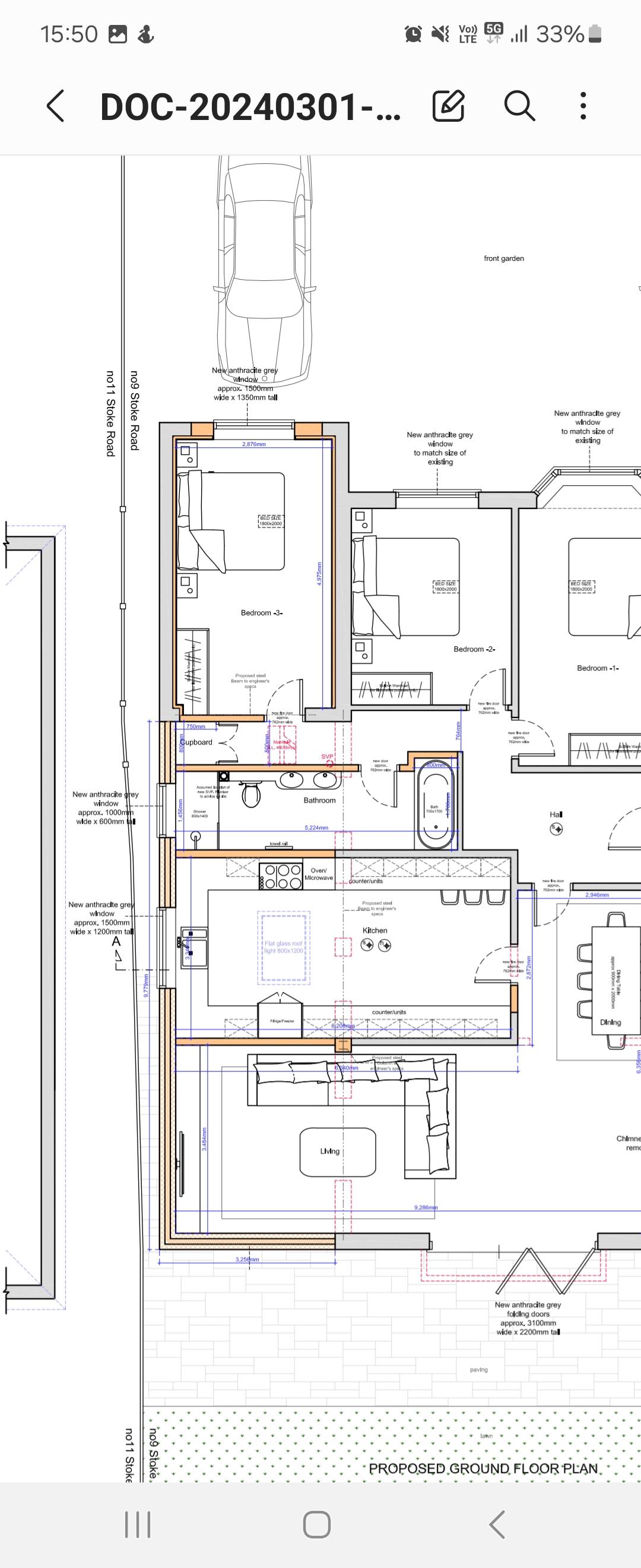

vik2001 Posted June 1, 2024 Author Share Posted June 1, 2024 No I don't have any drawings this is why I'm in such a mess. The original private drain has had its manhole taken apart and dismantled. Just unsure of how to proceed. The previous builder made a right mess of things and left me in a pickle... Link to comment Share on other sites More sharing options...
saveasteading Posted June 1, 2024 Share Posted June 1, 2024 10 minutes ago, vik2001 said: No I don't have any drawings Do a sketch then. It does not have to be skilled or smart. And / or photo. Link to comment Share on other sites More sharing options...

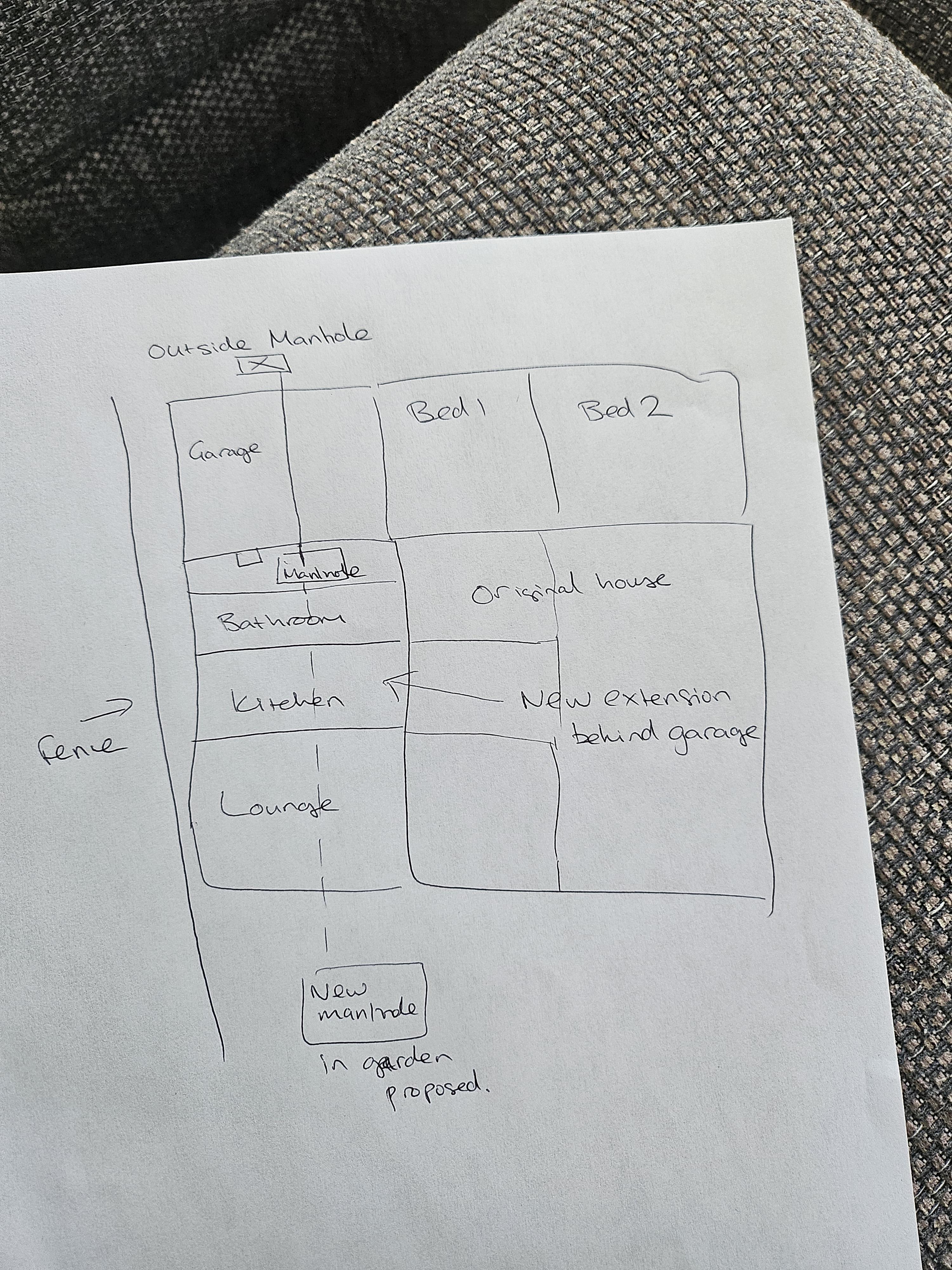

vik2001 Posted June 1, 2024 Author Share Posted June 1, 2024 Sorry for bad drawing. It's a side extension which butt's up to neighbous fence. I don't have much room to fit a soil stack on side for toilet where bathroom is. I have a flat roof going on to. Plan was to extend the private drain by 10m to back of garden for a new chamber/manhole for rodding. I try and get some height levels Link to comment Share on other sites More sharing options...
vik2001 Posted June 5, 2024 Author Share Posted June 5, 2024 On 30/05/2024 at 10:01, joe90 said: All this info is available on the internet The minimum depth of any drain is 600mm.Once all the underground drains are laid, Building Control will need to see them and may ask for an air test to be carried out. Once the drain installation is approved the trenches can be backfilled, but first more granular fill is required at least up to the top of the pipes. From the invert to ground level I got 390mm, and the drain needs to run a 10m distance. I take it this can't be done? Link to comment Share on other sites More sharing options...
