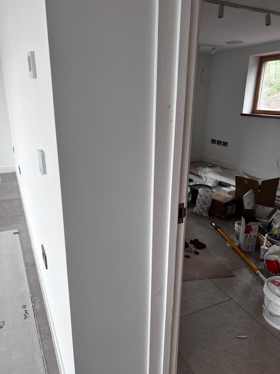

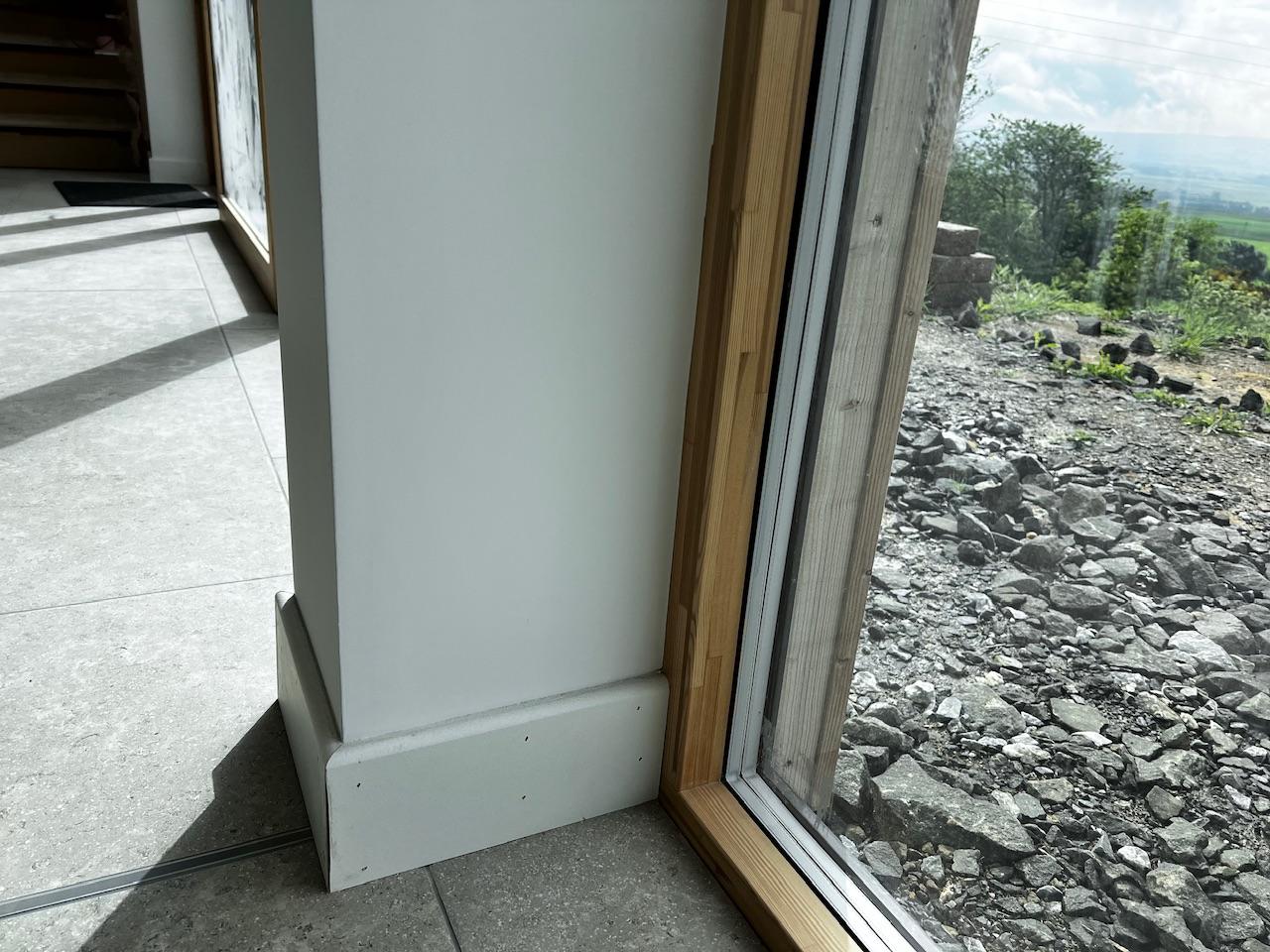

Just worked out my front clad walls, 520mm thick in total.

I’ve just measured ours and they are 510mm thick as I forgot to add the 3G windows in.

Over half a metre.  Oh my word.  That would shrink our rooms quite a bit. The site is only 24’ wide.
Actually it’s slightly worse than that as we also have an internal wall that runs the full length of the house constructed the same way as the external walls minus the window and cladding obviously. It’s 430mm thick. Our rooms could have been a lot wider had we gone with SIP walls. However they are more than wide enough as the open plan area  is 5.5m wide.

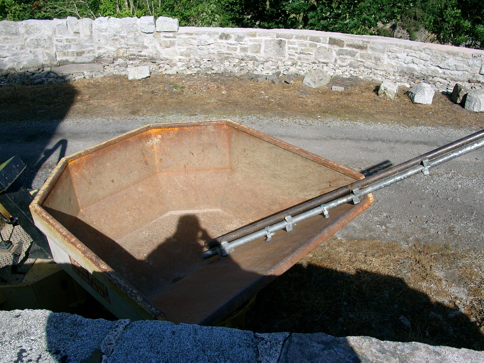

a telehanlder must go under your overhead cable --so you could stil use one to lift heavy things -ask sips panel suppiiers about wieghts of their panels
iwould use my swing dumper with my lifting attachment and screw 4x2 to each panel and lift with that with a chain around the scaffolding pole on the dumper
If you look through my posting you will see iwas lifting up to 500kgs with that no problem , so a sips panel would be no problem
