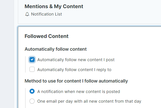

Annker Posted May 11, 2024 Author Posted May 11, 2024 Thanks for the response, I dont seem to get any notification of responses, not even the bell icon above. Anyway I provided my local merchant with my timber list for the project. I'm not sure should I call them a TM who also stocks building materials or a BM who specialises in timber. Their online trade price for 18mm b/bb CE2+ hardwood ply is an eye watering £52/sheet, hence me starting this thread. However, when presented with my timber list (value ~£4k of timber) they can supply the ply at £36/sheet. I need ~40 sheets of ply, They are a good yard and competitive with sawn timber so I'm happy at that price.
BotusBuild Posted May 14, 2024 Posted May 14, 2024 On 11/05/2024 at 22:54, Annker said: I dont seem to get any notification of responses A subtle (or crazy) feature of the forum - you have to "follow" you're own posts Admins - is there a way to setup "auto follow own posts"? 1
BotusBuild Posted May 14, 2024 Posted May 14, 2024 (edited) 2 minutes ago, BotusBuild said: A subtle (or crazy) feature of the forum - you have to "follow" you're own posts Admins - is there a way to setup "auto follow own posts"? At the top of the page click on your forum name - choose Manage Followed Content - click the appropriate button 🙂 Edited May 14, 2024 by BotusBuild
Annker Posted May 20, 2024 Author Posted May 20, 2024 On 14/05/2024 at 09:41, BotusBuild said: At the top of the page click on your forum name - choose Manage Followed Content - click the appropriate button 🙂 Great, thanks for the tip!
garrymartin Posted May 20, 2024 Posted May 20, 2024 On 14/05/2024 at 09:41, BotusBuild said: At the top of the page click on your forum name - choose Manage Followed Content - click the appropriate button 🙂 I don't know whether it appears differently on other devices or platforms, but for me on a Mac, it's in Account Settings. Try https://forum.buildhub.org.uk/notifications/options/ and you'll find the settings there in the "Followed Content" section. 1
