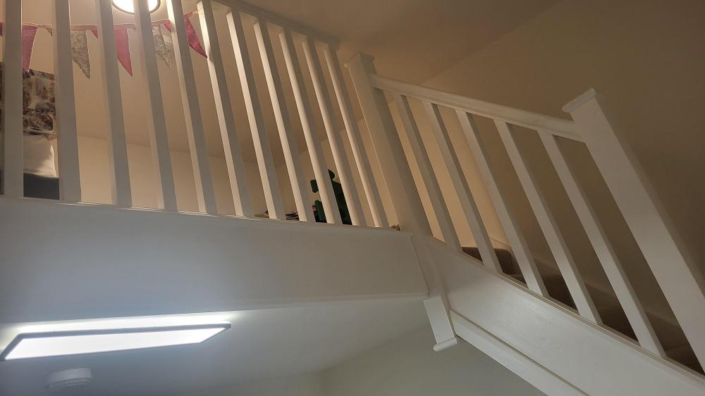

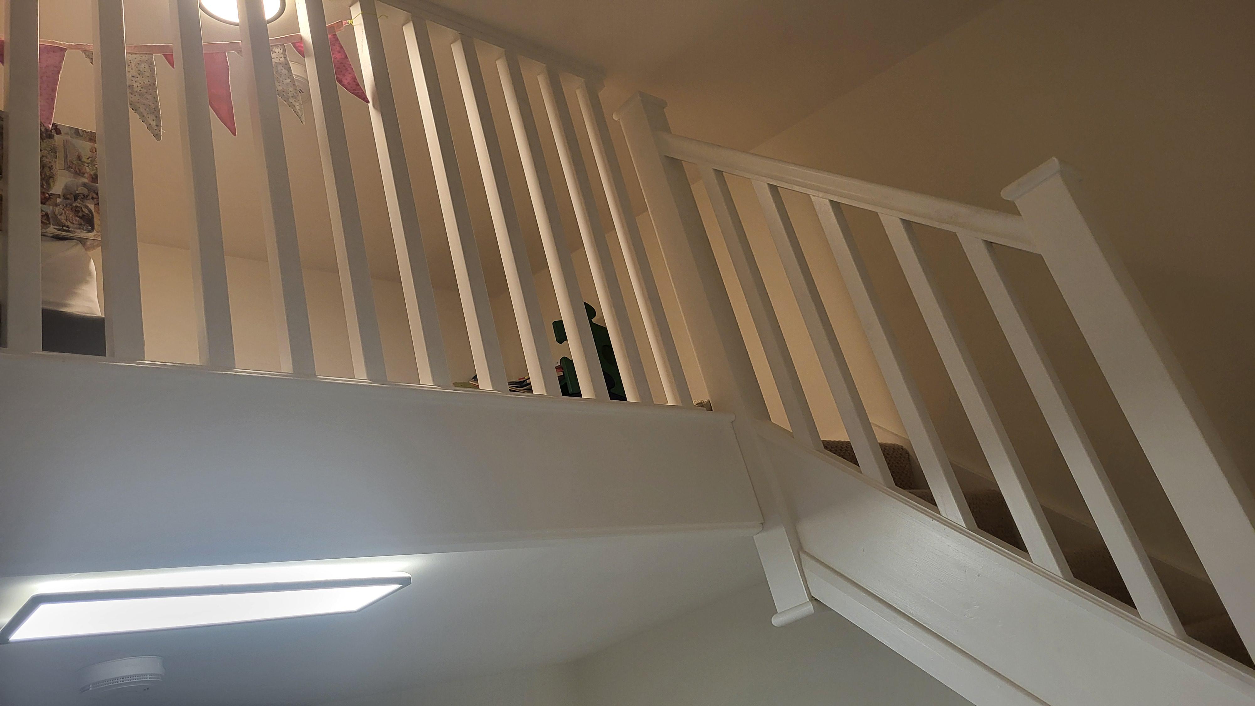

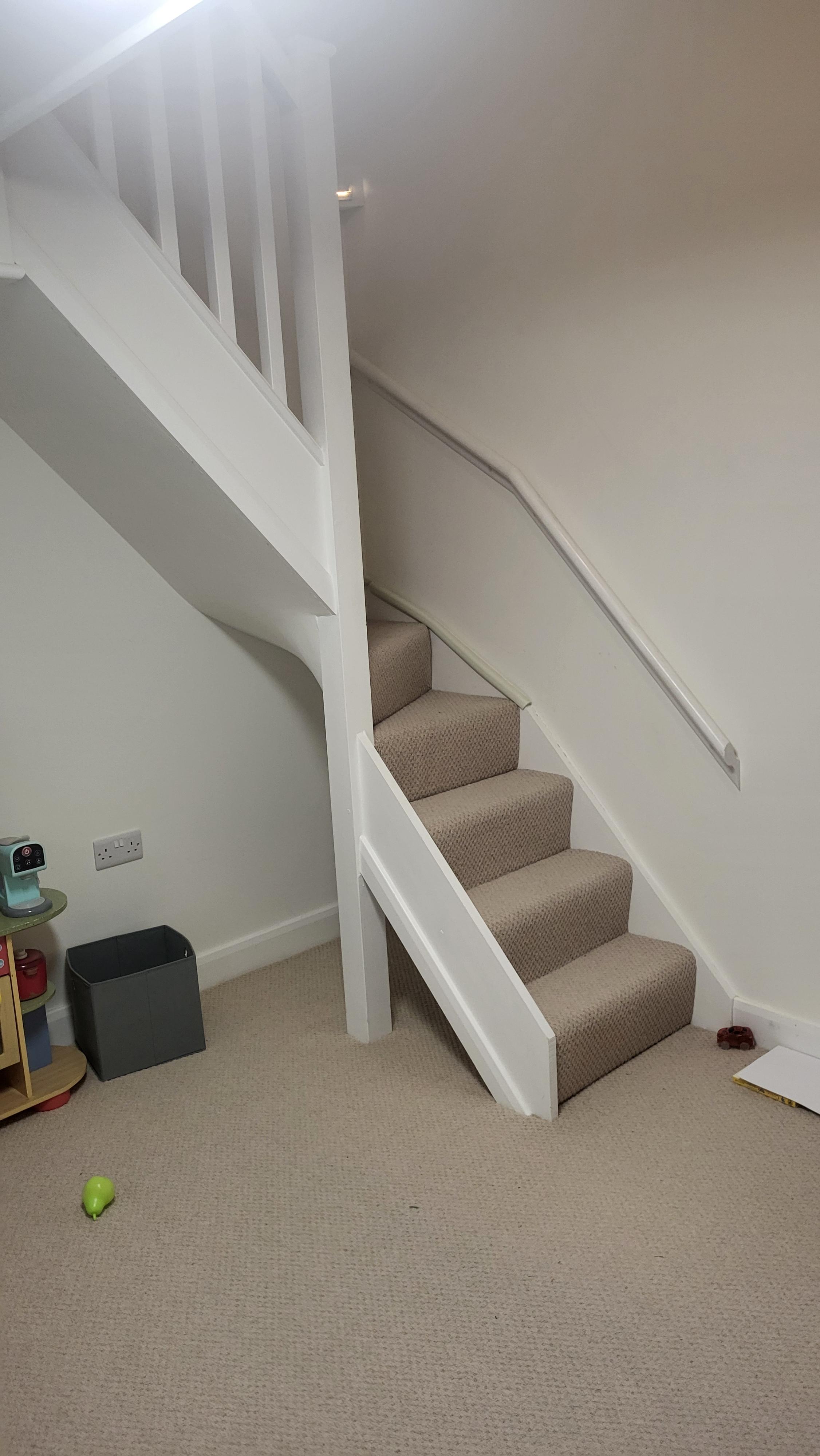

Andehh Posted April 28, 2024 Posted April 28, 2024 (edited) We have, in theory, got it in writing from our BC for the below. Incidental use I think they've called it, so storage only, and us arguing the mini staircase is safer then a ladder/paddle stairs for accessing, which they agreed with. Lots of photos and designs shared with BC, and emails confirming OK, awaiting final inspections in next few weeks. We did need fire alarms top and bottom though. Edited April 28, 2024 by Andehh
