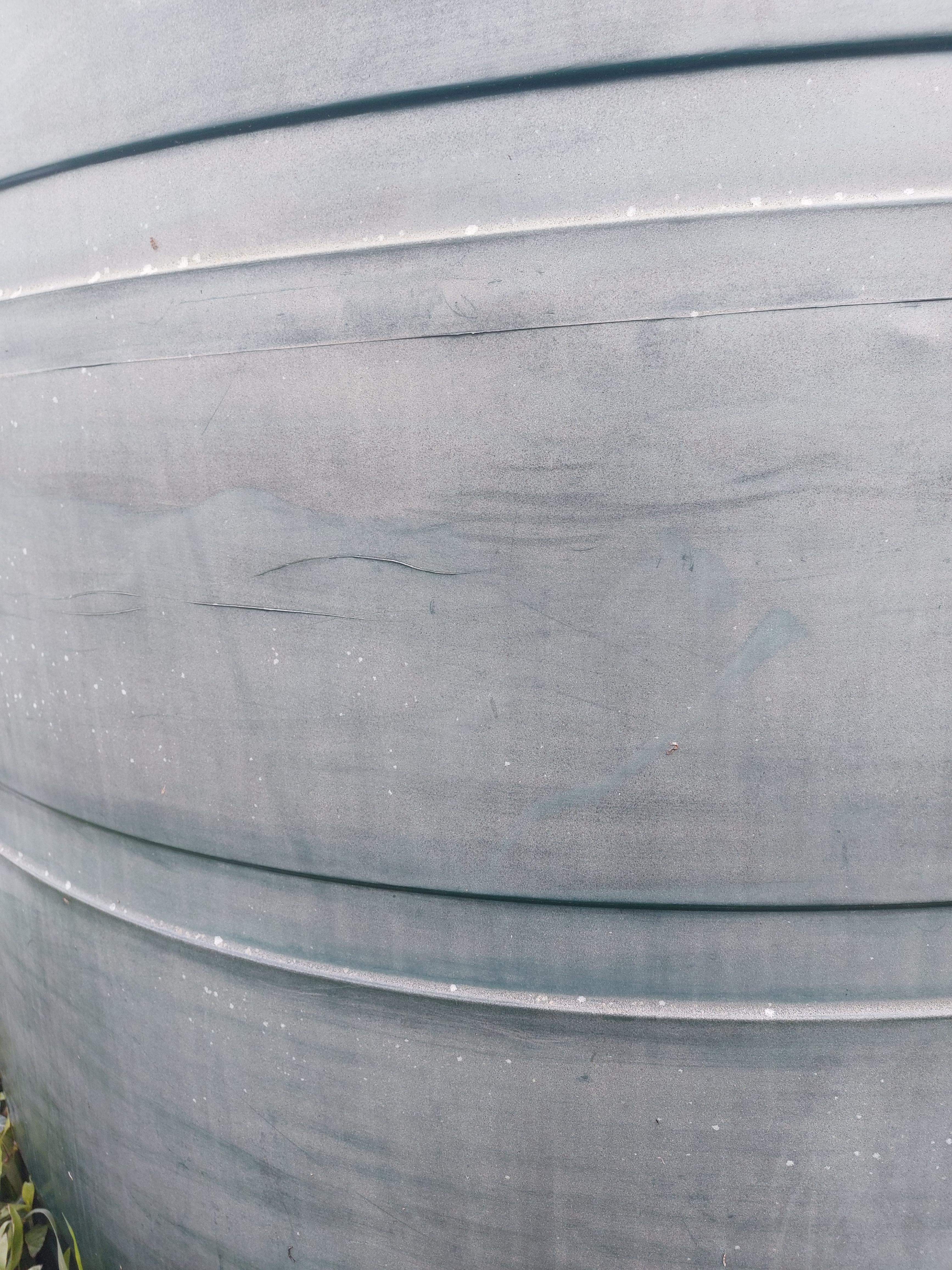

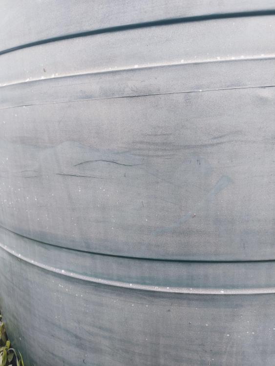

Meanwhile he gas given me a warning notice that the oil tank has to be changed. I thought these were scratches but he says it is uv failure in the plastic.
An expensive day.
Isn't there some repair and treat system? It seems not.
Is it bundied? (Double skin) which I believe is mandatory now
surely the plumber is working backwards? If boiler and burner are running for now, just throw a pump in it.  *then* look at the other stuff. Seems he's got his OFTEC profit head on...
And if no-one is likely to take a hammer to the oil tank, leave well alone. Whilst it may be a little more brittle than it used to be, that's more likely just the surface drying out, like grey car bumpers do.
