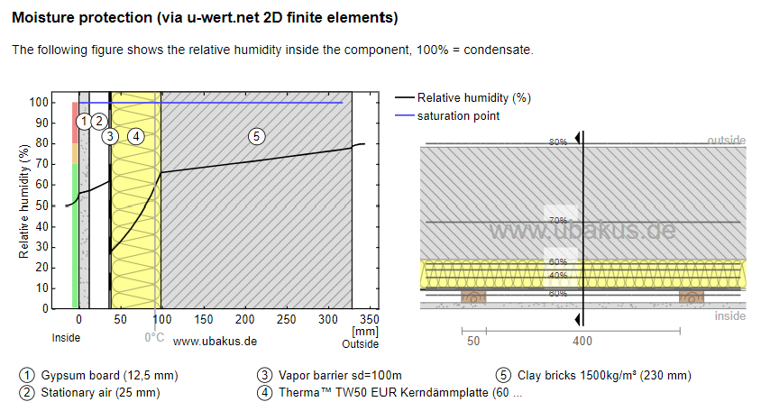

Surely given where the PB and skim layers are located in the build up condensation should not be an issue.
Modelling shows the Dewpoint within the insulation albeit it is towards the warmside; perhaps you saying the concern is if the Intello membrane allows vapour to travel outsode to inside should relative conditions drive it so?

I have modelled the PIR solution on Ubakus, and to me it looks ok.
Humidity doesn't approach saturation point which I imagine is the most important thing.

Ubakus uses the Glaser modelling technique which, unfortunately, is too simplistic. The gold standard is dynamic modelling (WUFI being the main software used), which takes into account multiple factors - like those you mention (location, orientation, aspect) as well as climate data - and models the element over the course of several years. However if you're not going too low with the U-value then that's normally not necessary. Wall U-values down to 0.5 W/m²K are normally 'safe', while research in Scotland suggest that values down to 0.35 are likely safe too.

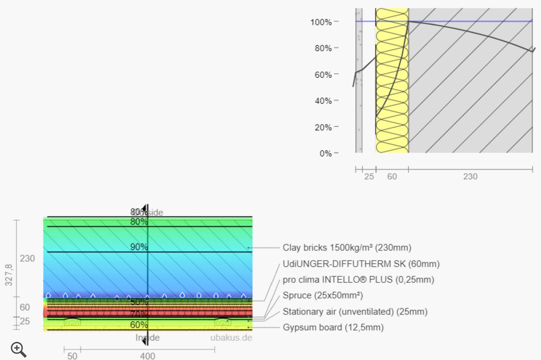

It was interesting to see that with the outside temp set to -10 degrees the model with 60mm PIR remined condensate free.
However condensation was indicated in the model with 60mm wood fibre (screen grab below)
Not sure if that observation has any validity/relevance.

The Glaser method that Ubakus uses just isn't up to predicting problems with internal wall insulation.
Expand
None at all - the results aren't valid for the purpose. There are many factors it fails to take into account.
