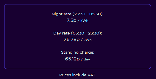

Originaltwist Posted April 14 Share Posted April 14 Off-peak energy storage for cheaper heating Off-peak energy plus heat pump equals unbelievably cheap heat. But how to store it? High temperature heat pumps might make all the difference (wider Dt) so here’s a shot of my model which shows that a 1,000 litre buffer tank along with, say 300l, DHW and a bit of slab heating might work. 60kW.hrs a day for £300 a year – worth a look! Conclusions are a bit disturbing and contra intuitive as inefficiencies are overcome by economy. Buffer tanks should be huge Blending down is necessary Zoning is easy and a good thing HP running all day is not a good idea A much bigger heat pump is needed A mini-split addition is even more desirable I’ve sketched out how such a system might look on Off-peak energy storage for cheaper heating https://wordpress.com/post/originaltwist.com/7618 So, team, is this worth a look or a step too far? N.B. I'm aware this contradicts all the wise words seen so far on this topic and I apologise for that but I genuinly can't see what will no doubt emerge as the big flaw. Link to comment Share on other sites More sharing options...
sharpener Posted April 14 Share Posted April 14 Yes, thermal storage is defo much cheaper than batteries and I agree in principle, but as you demonstrate @Originaltwist you have to do it on a heroic scale for it to be truly worthwhile. We only have room for a 260 litre thermal store, the economics are analysed here but in brief you have to assume 20% inflation in electricity tariffs to get a 10 yr payback. I am planning on doing it as much as an interesting experiment as for its economic value. The other issue is that MCS installers are not used to thinking like this and in a sellers' market mostly want to throw in standard systems at maximum profit rip-off. Link to comment Share on other sites More sharing options...
SteamyTea Posted April 14 Share Posted April 14 You may be able to get away with less storage, and a smaller ASHP by playing more with the tariff prices. So rather than try and generate and store a full days worth of energy, look at the CoP and price differentials and see if you can get similar savings by say heating 500lt to 55⁰C during the cheap period, say 5 hours, the run for another 5 hours at a higher CoP, but lower temperature direct into your heating system, while also drawing from your higher temperature thermal store. The main thing is that most of the time you may only need a few kWh as the weather is warmer and the house will naturally heat up during daylight hours. It would be a shame to always have a large store topped up and then only use a few percent of the capacity. Link to comment Share on other sites More sharing options...

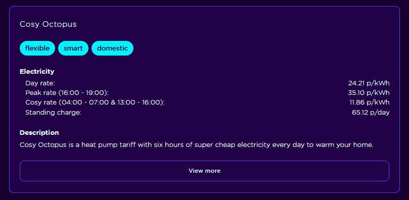

sharpener Posted April 14 Share Posted April 14 4 hours ago, SteamyTea said: You may be able to get away with less storage, and a smaller ASHP by playing more with the tariff prices. Octopus Cosy is well suited to this, you get 3 hrs overnight and another 3 hrs 1300-1600 which is ideal for a recharge before the evening peak. It will need some more modelling before I know if this is a better bet than Intelligent Octopus Go. Link to comment Share on other sites More sharing options...
