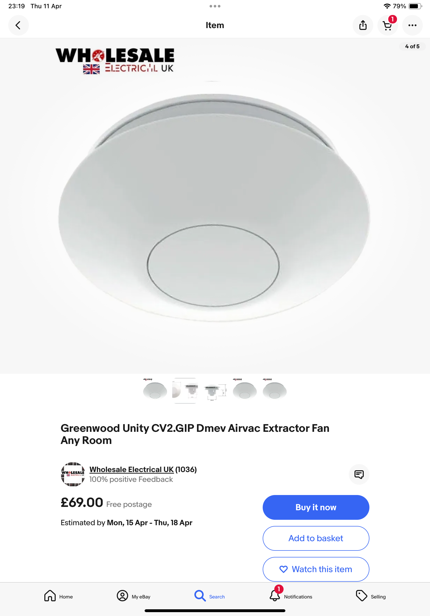

torre Posted April 10, 2024 Share Posted April 10, 2024 I'd go dmev, not PIV. PIV pulls fresh air in, which is good, but it's pushing the humid air out via gaps and holes in brickwork, around frames etc. Forcing damp air through the building fabric doesn't sound a great idea 1 1 Link to comment Share on other sites More sharing options...

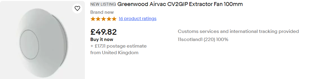

minty Posted April 11, 2024 Author Share Posted April 11, 2024 15 hours ago, Iceverge said: Probably not enough, You need 2x windows open to get a decent cross flow. The trouble is then that the house gets cold and they get closed. This needs to be on 24/7 a max power. Take this out and replace with one of these. As mentioned above, it runs continuously and ramps up when the humidity does. and sucks out all the damp air. Costs about 1/20th of what a dehumidifier does to run. Hi If I run a dehumidifier constantly until the percentage is reduced to 50 , then get my mum and her dog to move out for a few days and the humidity remains the same then does that prove the high air vapour content is caused by the dog and one person? Link to comment Share on other sites More sharing options...

Iceverge Posted April 11, 2024 Share Posted April 11, 2024 @minty Sorry I think I(we) might have git a bit bogged down here in an effort to assist. Shortest answer I have to solve your problem. 1. Stop any water leaks from outside or inside. ( Roofs, windows, doors, pipes, shower trays, washing machines etc etc) 2. Replace the bathroom fan with this. You can DIY it or pay an electrician. 3. Make the house hotter by leaving the rads on. 4. Give it time. 2 Link to comment Share on other sites More sharing options...

minty Posted April 12, 2024 Author Share Posted April 12, 2024 7 hours ago, Iceverge said: @minty Sorry I think I(we) might have git a bit bogged down here in an effort to assist. Shortest answer I have to solve your problem. 1. Stop any water leaks from outside or inside. ( Roofs, windows, doors, pipes, shower trays, washing machines etc etc) 2. Replace the bathroom fan with this. You can DIY it or pay an electrician. 3. Make the house hotter by leaving the rads on. 4. Give it time. This is perfect, thank you for your post. the info on the fan is particularly useful. I'm more focused now. Link to comment Share on other sites More sharing options...
