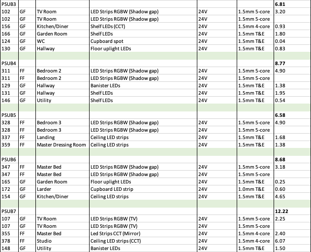

Thorfun Posted April 7 Share Posted April 7 greetings. looking for batteries for backup to my 24V Loxone stuff via the power supply and backup. I need 3 x 12V batteries and I'm thinking AGM batteries are the way to go as this website seems to suggest they're more efficient and according to the Loxone knowledge base they say Quote The charging electronics of the power supply is designed for lead-acid batteries in standby application. Sealed (VRLA/SLA) Gel or AGM batteries are recommended, which are suitable for this application. All my 24V lights running at the same time would be around 40A or 960W. so let's assume that I have 3 x 15Ah batteries that would mean I could only run the 24V lights for only 2hrs max! doesn't seem like a long time. so, therefore, I need bigger capacity batteries, right? but then the cost starts increasing dramatically! if I look at Tanya.co.uk a 45Ah battery is about £175. so 3 of those is just over £500. but that would give me 135Ah of backup which would run the lights for 5hrs. which doesn't seem a lot either! has anyone out there who has a power supply & backup connected 36V batteries and, if so, which did you go for? (note. if my maths above is wrong please feel free to correct me! I think you know by now that maths/physics/electrics are not my strong point) Link to comment Share on other sites More sharing options...
MikeSharp01 Posted April 7 Share Posted April 7 21 minutes ago, Thorfun said: running at the same time would be around 40A or 960W Are you sure - that is an awful lot of Watts for a LED illuminated house these days. Even if all your LED lamps were 5W you would be lighting 192 of them. LED strips can be quite power Hungry I suppose - whats the mix? Link to comment Share on other sites More sharing options...
Thorfun Posted April 7 Author Share Posted April 7 28 minutes ago, MikeSharp01 said: Are you sure - that is an awful lot of Watts for a LED illuminated house these days. Even if all your LED lamps were 5W you would be lighting 192 of them. LED strips can be quite power Hungry I suppose - whats the mix? lots of RGBW LED strips tbh. probably won't have all of them on at the same time but I've calculated the max current to ensure that I stay within the max of the power supply. Also have quite a few normal LED strips around the place as accent lights. in a power cut our mains lights won't be working so the LED strips will be the main lighting. although I am thinking about asking the electrician to see if we can get the mains lights (3 x Loxone relays and 1 x WW mains dimmer) powered off the batteries but that will mean 2 x feeds in to the Loxone cabinet from different consumer units and it'll start getting really complicated! Link to comment Share on other sites More sharing options...

Thorfun Posted April 7 Author Share Posted April 7 here's my spreadsheet of all my 24V LEDs/LED Strips. the last column is the current each will draw at full power and the total in bold on each output of the PSUB. Link to comment Share on other sites More sharing options...
Alan Ambrose Posted April 7 Share Posted April 7 Do you need every channel of every LED strip turned to full brightness in a power cut? A LED takes about 9 times less power than an old fashioned filament bulb. So your 960W of backup LED power is equivalent to about 190 old fashioned 60W bulbs. That’s a lot of lighting to use in a power cut . Maybe just pick a few essential lights for that not very common ‘use case’? Link to comment Share on other sites More sharing options...
Thorfun Posted April 8 Author Share Posted April 8 7 hours ago, Alan Ambrose said: Do you need every channel of every LED strip turned to full brightness in a power cut? A LED takes about 9 times less power than an old fashioned filament bulb. So your 960W of backup LED power is equivalent to about 190 old fashioned 60W bulbs. That’s a lot of lighting to use in a power cut . Maybe just pick a few essential lights for that not very common ‘use case’? That is definitely the sensible thing to do. I was just thinking of a worse case scenario and planning for it. But maybe 45Ah will be enough for emergency battery backup for the 24V lights. It’s definitely a cheaper option to try to start with! Although even with only 1/3 of the lights running that’s only 6hrs illumination. Enough to get us to bedtime in the winter though I guess. Link to comment Share on other sites More sharing options...
Alan Ambrose Posted April 8 Share Posted April 8 Will this work? One evening, adjust your lighting to your preferred minimum as though you were having a power cut. Measure the current / power draw. You can get a similar figure during daylight too if you need any lights on then. That’ll give you the max realistic power draw you need to cope. Then you can make a little table for run time vs. battery capacity. Check the number of hours between sunset to bedtime on the shortest day and the longest. Those few numbers should allow you to make the trade off you need. Link to comment Share on other sites More sharing options...
Thorfun Posted April 8 Author Share Posted April 8 6 hours ago, Alan Ambrose said: Will this work? One evening, adjust your lighting to your preferred minimum as though you were having a power cut. Measure the current / power draw. You can get a similar figure during daylight too if you need any lights on then. That’ll give you the max realistic power draw you need to cope. Then you can make a little table for run time vs. battery capacity. Check the number of hours between sunset to bedtime on the shortest day and the longest. Those few numbers should allow you to make the trade off you need. that would definitely work and is a great idea but with the one slight snag that i haven't fitted any of those LED strips yet! 😉 i was hoping to start fitting those this weekend if i get time after doing some plumbing work. but it is a great idea and i can put off buying these batteries until after i have that data. Link to comment Share on other sites More sharing options...

Alan Ambrose Posted April 9 Share Posted April 9 >>> i haven't fitted any of those LED strips yet! You can jury-rig a strip to measure it or just estimate: I suggest the equivalent of 10 x 60W old-style bulbs would allow you 'to illuminate 'luxuriously' during a power cut'. That's about 60W equivalent total of LED lighting. 10 hours of that would be 0.6 kWh, which at 12V is 50Ah - so one typical LA battery. Plus whatever the Loxone rig takes when it's idle, which could be a non-trivial bit. Plan to use one battery and add more if you really need it later? Link to comment Share on other sites More sharing options...

Thorfun Posted April 9 Author Share Posted April 9 23 minutes ago, Alan Ambrose said: >>> i haven't fitted any of those LED strips yet! You can jury-rig a strip to measure it or just estimate: I suggest the equivalent of 10 x 60W old-style bulbs would allow you 'to illuminate 'luxuriously' during a power cut'. That's about 60W equivalent total of LED lighting. 10 hours of that would be 0.6 kWh, which at 12V is 50Ah - so one typical LA battery. Plus whatever the Loxone rig takes when it's idle, which could be a non-trivial bit. Plan to use one battery and add more if you really need it later? Loxone miniserver and extensions are minimal so i'm not even going to factor those in. for the PSUB you need 3 x 12V batteries as it's a 36V battery backup system. so it's all or nothing on that front. i'm sure i can reduce the power draw for each LED strip in certain circumstances within Loxone config but i haven't got that far in to my learnings yet. maybe i do simply start with a low cost 45Ah setup and can then reasses if/when i ever need to! i'm in no rush for the batteries as we're not even living there yet but i like to start my research early so i can forget what i've researched a few months down the line when i'm ready to purchase so i have to research it all over again. 🤦♂️ so plenty of time to fit the LEDs and see how they perform dimmed at night. i can then measure the power draw through Loxone as the PSUB should give those readings. Link to comment Share on other sites More sharing options...
