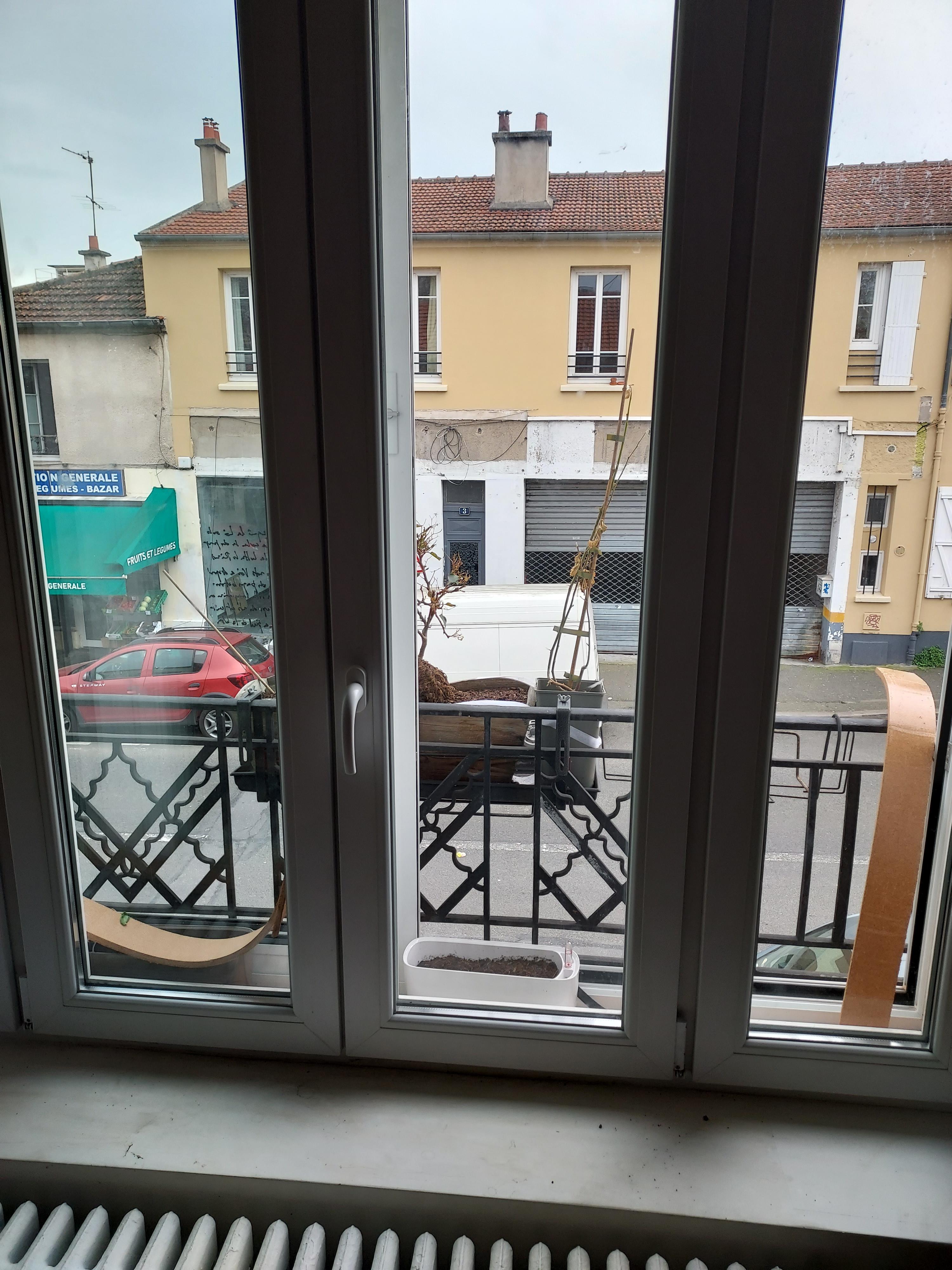

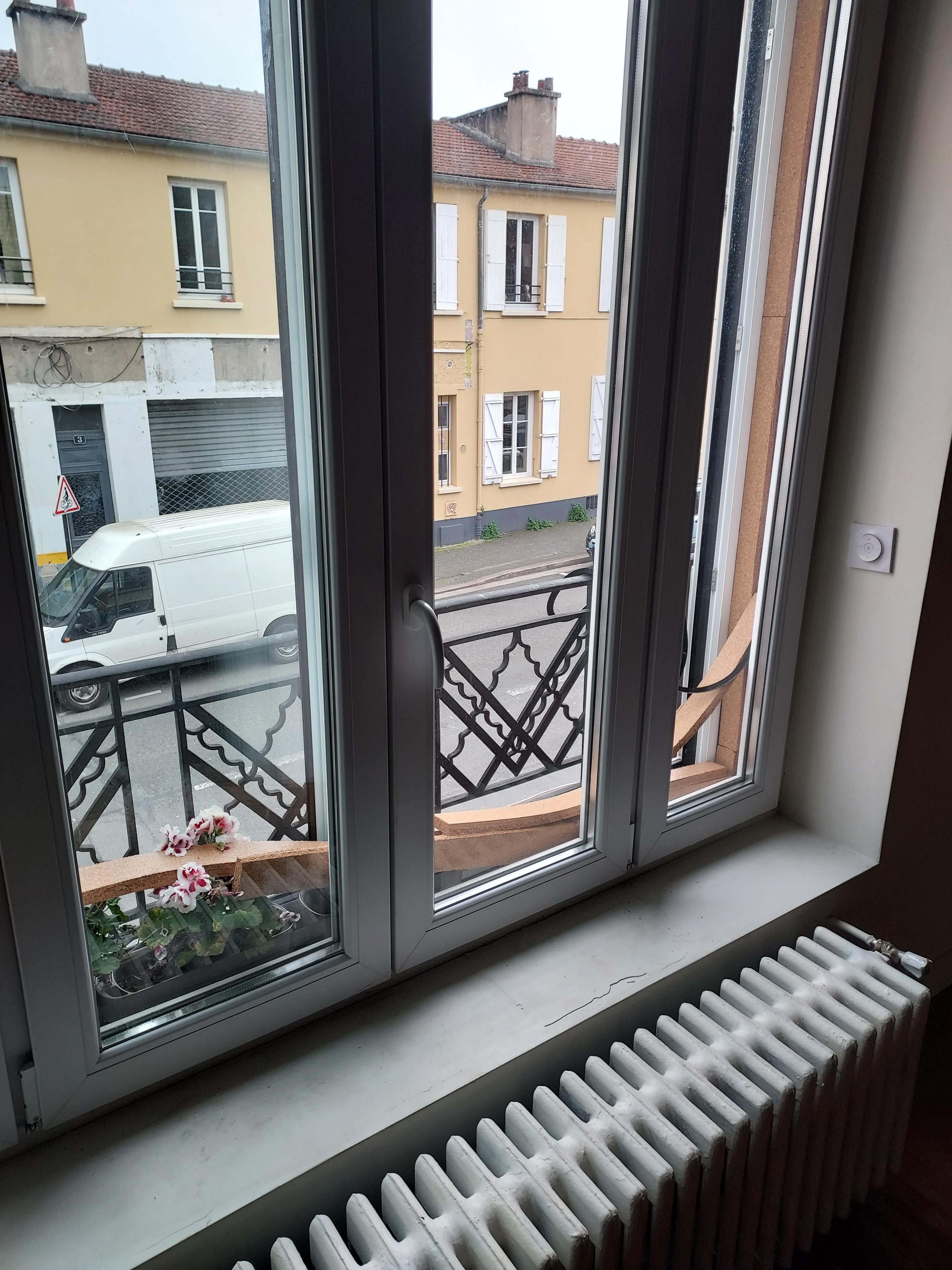

Garald Posted April 7, 2024 Posted April 7, 2024 The cork I glued to the sides of the space between my windows mostly fell of while I was away. What is the best glue for attaching cork to brick and other masonry? Or is gluing the wrong approach?
Andehh Posted April 7, 2024 Posted April 7, 2024 Something like CT1 would do the trick I think! That stuff sticks everything.
Garald Posted April 7, 2024 Author Posted April 7, 2024 15 minutes ago, MikeSharp01 said: What is the Cork doing? Sound absorption. Well, the cork stuck on the sides of the external frame should also help with (sound-insulation) weak points in the frame without coupling it much (I think), but those cork strips haven't fallen out.
Garald Posted April 7, 2024 Author Posted April 7, 2024 15 minutes ago, Andehh said: Something like CT1 would do the trick I think! That stuff sticks everything. How harnful is CT1? Is it enough to air it well?
Andehh Posted April 7, 2024 Posted April 7, 2024 Very benign, just a couple of lines down the middle of the Cork and press fit it well. Use it in an applicator gun like you would bathroom silicone. Make sure both surfaces are clean and dry.
Garald Posted April 7, 2024 Author Posted April 7, 2024 (edited) 38 minutes ago, Andehh said: Very benign, just a couple of lines down the middle of the Cork and press fit it well. Use it in an applicator gun like you would bathroom silicone. Make sure both surfaces are clean and dry. All right. What about gluing cork to the top part? Will I need to hold it for long before the glue acts? I haven't mastered antigravity. Edited April 7, 2024 by Garald
Andehh Posted April 7, 2024 Posted April 7, 2024 Not really, it's pretty sticky stuff. Glue top bit on first, then glue side bits so they help hold top bit up, and maybe stick a Broom/brush/curtain pole wedging the middle bit up. 1
