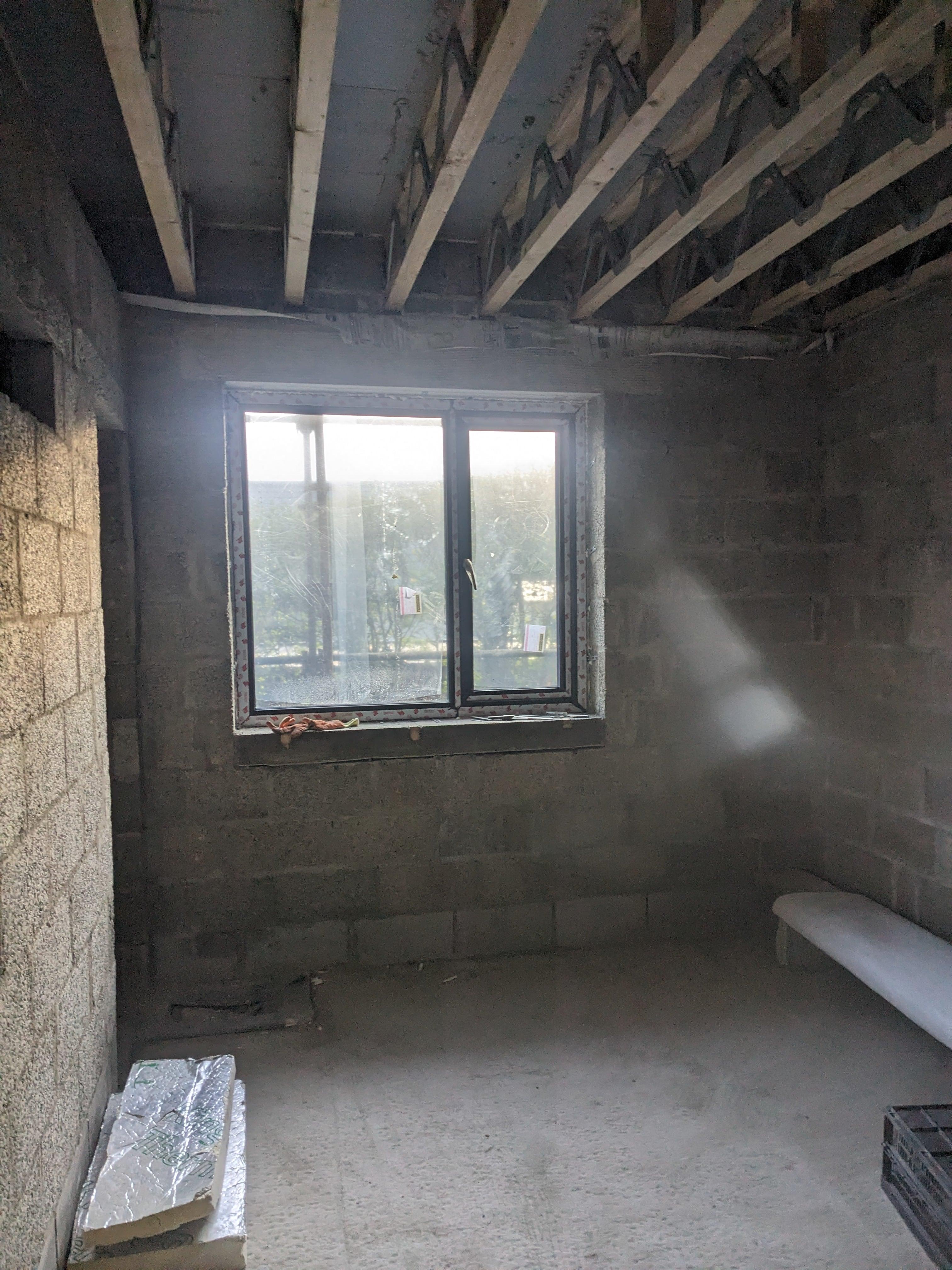

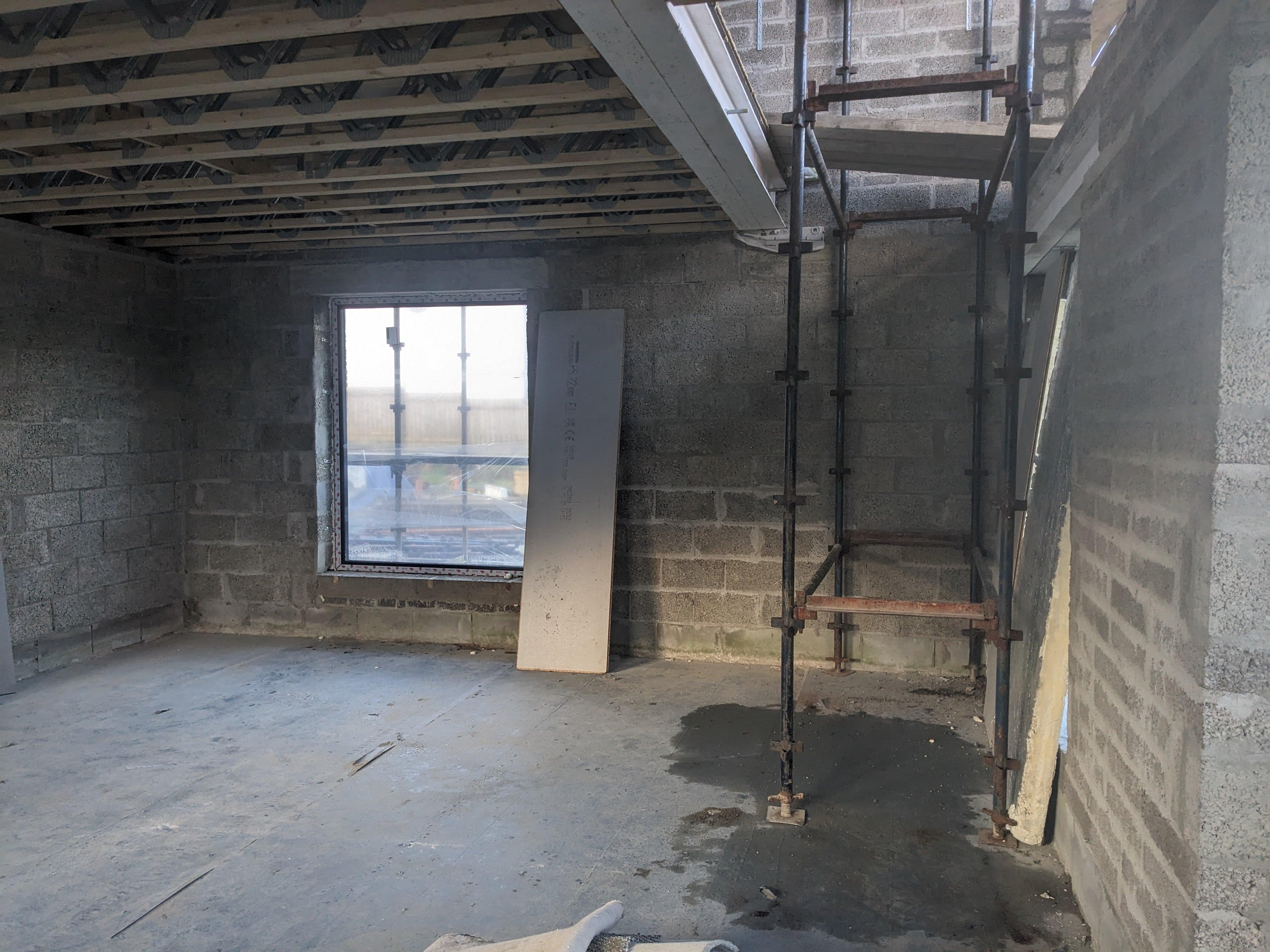

CalvinHobbes Posted April 9, 2024 Author Share Posted April 9, 2024 (edited) Baskill started putting in the windows,the builder was using some foam taday, now worried after seeing other thread it's ok. A screengrab shows Soudall. Red can. The pdf below I think is it's details... foam.pdf Edited April 9, 2024 by CalvinHobbes Link to comment Share on other sites More sharing options...
CalvinHobbes Posted April 9, 2024 Author Share Posted April 9, 2024 (edited) So comparing them it seems the same???? Edited April 9, 2024 by CalvinHobbes Link to comment Share on other sites More sharing options...

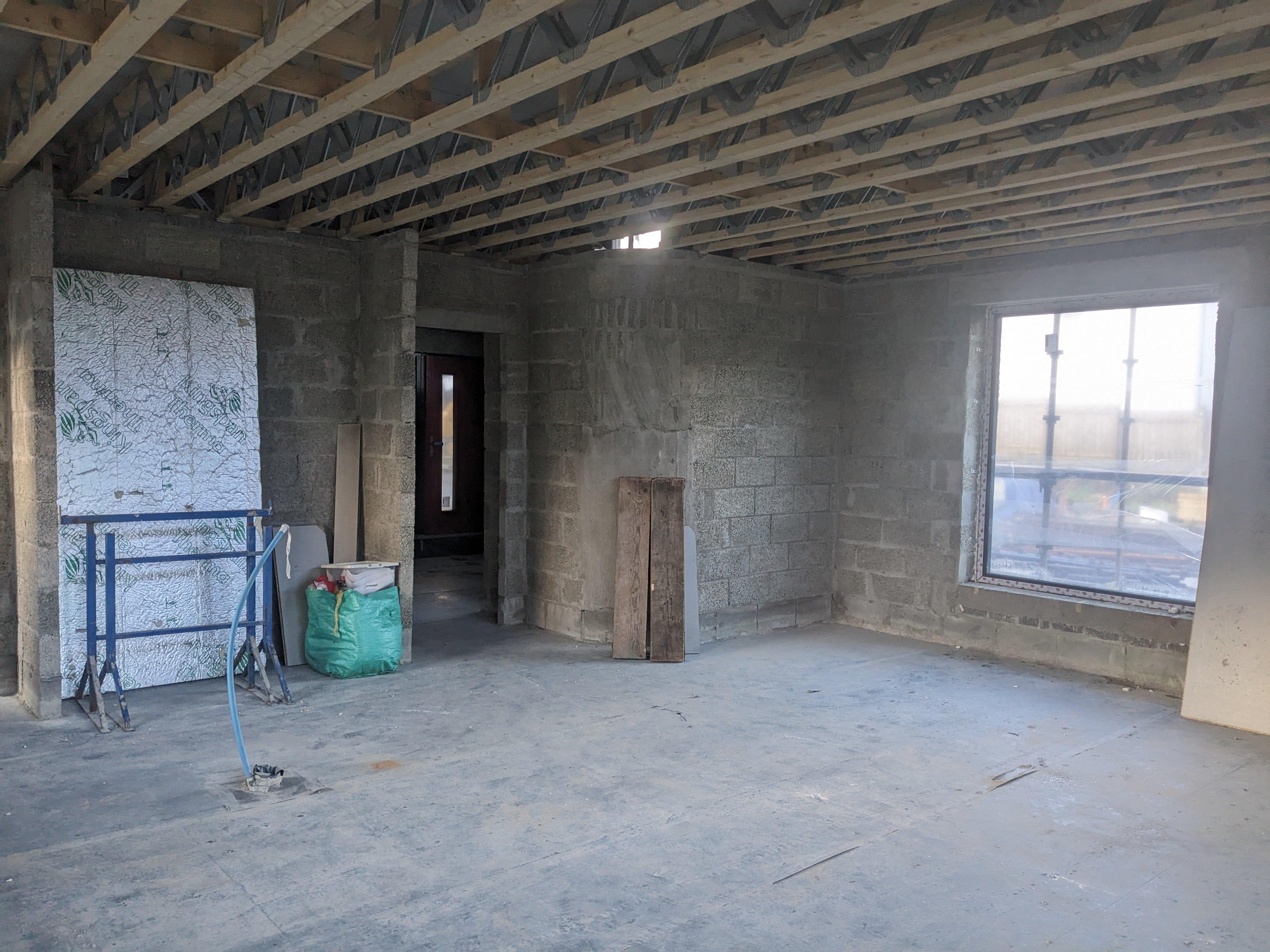

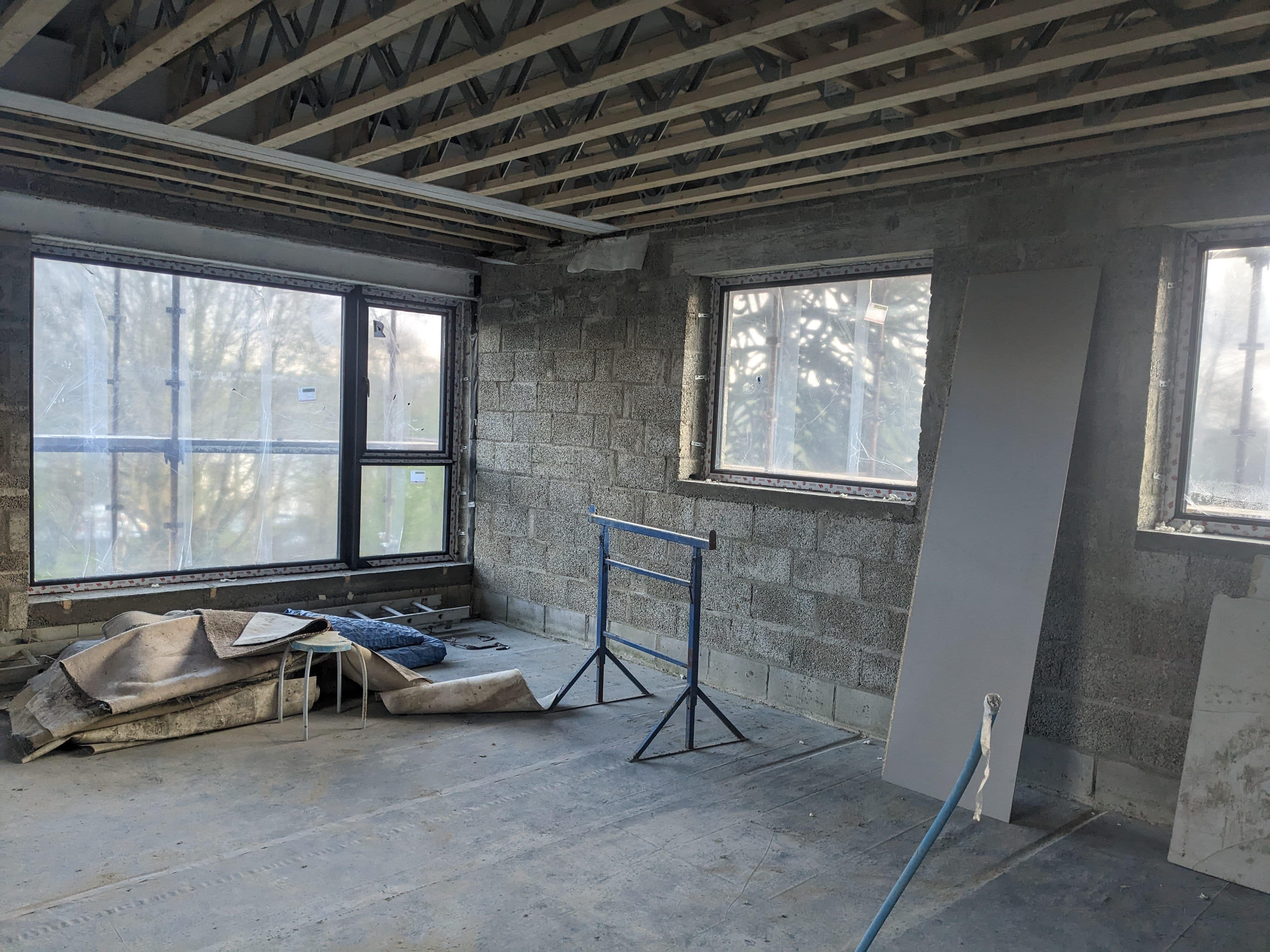

CalvinHobbes Posted April 9, 2024 Author Share Posted April 9, 2024 Almost scared to post these but what do you think? Link to comment Share on other sites More sharing options...
CalvinHobbes Posted April 9, 2024 Author Share Posted April 9, 2024 Link to comment Share on other sites More sharing options...

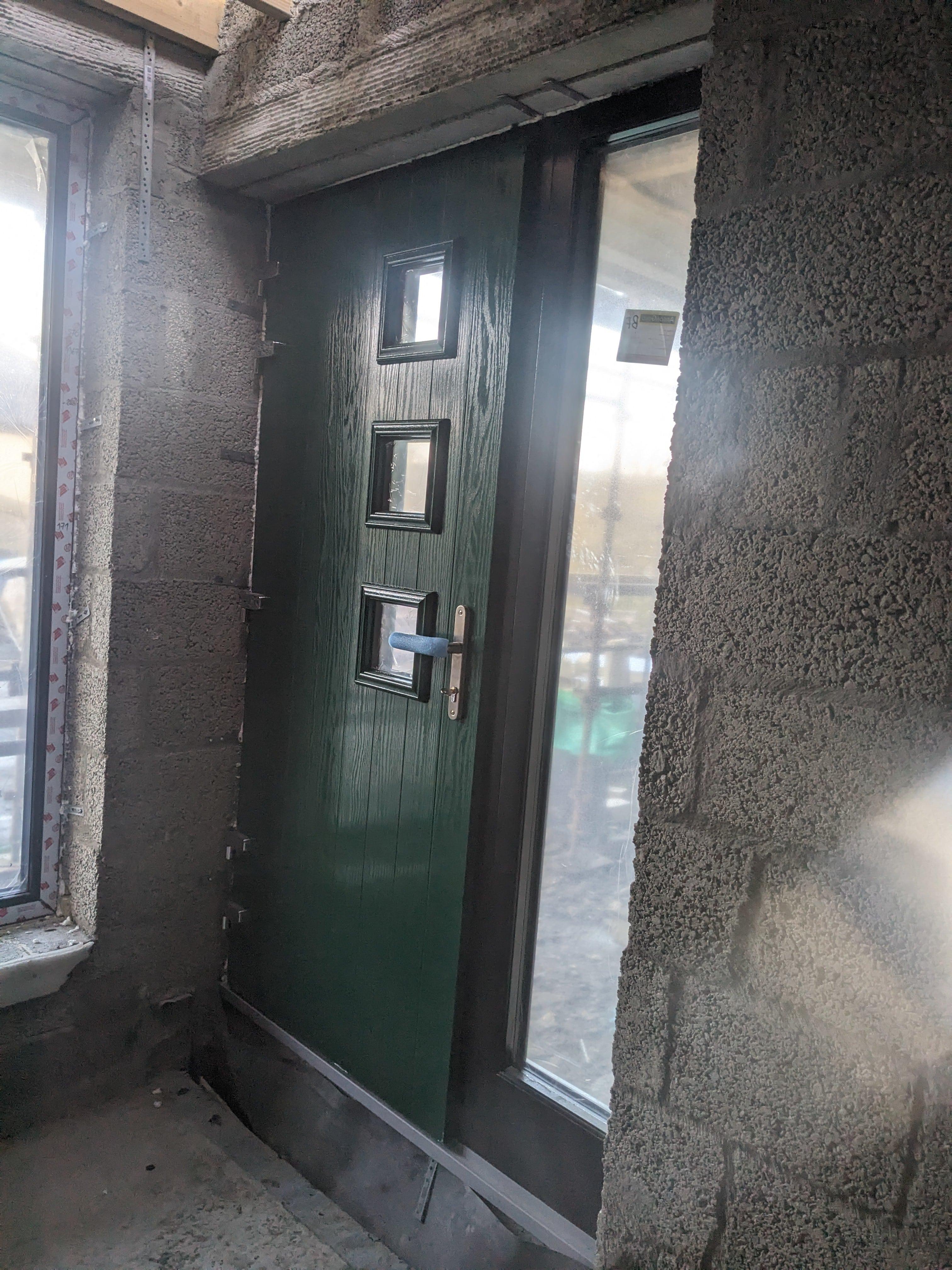

Russell griffiths Posted April 10, 2024 Share Posted April 10, 2024 My personal opinion obviously your front door needs redesigning the location is too close to the side wall, you will have problems once that wall is plastered, the door will never open properly and will always be a PITA. A 100mm stub wall should have been built to allow the door to open 120 degrees, you will struggle to get that to open to 90. Link to comment Share on other sites More sharing options...
