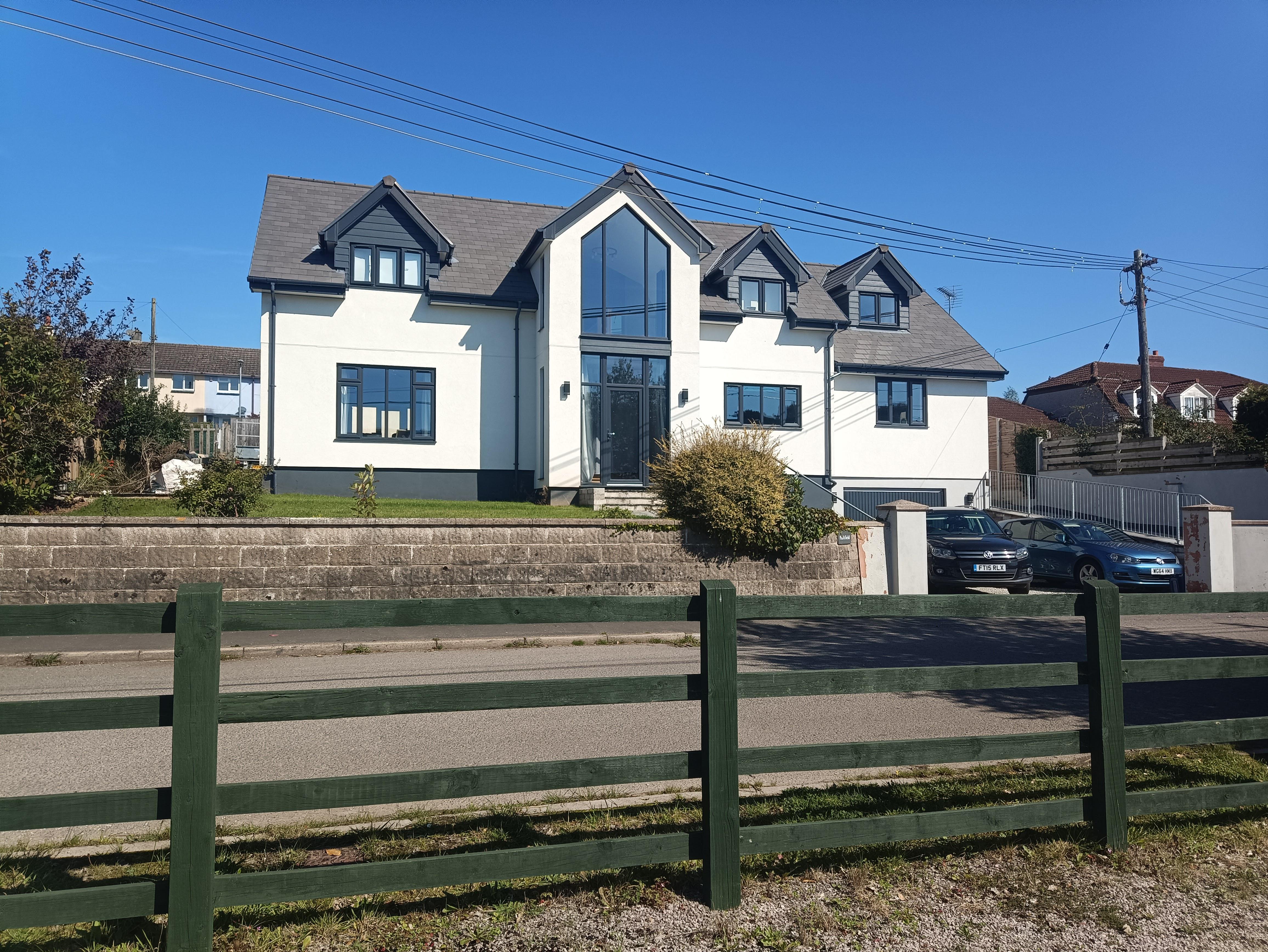

MPH243 Posted April 3 Share Posted April 3 I used DJP Finishes based in Tiverton/Exeter area. They made a very good job of our house. 1 1 Link to comment Share on other sites More sharing options...
Nic Posted April 3 Author Share Posted April 3 3 minutes ago, MPH243 said: I used DJP Finishes based in Tiverton/Exeter area. They made a very good job of our house. That looks great what render was it please? Link to comment Share on other sites More sharing options...

MPH243 Posted April 3 Share Posted April 3 I used SAS pro rend, they are based in Cheriton Bishop, but supplied through RGB. 1 Link to comment Share on other sites More sharing options...
