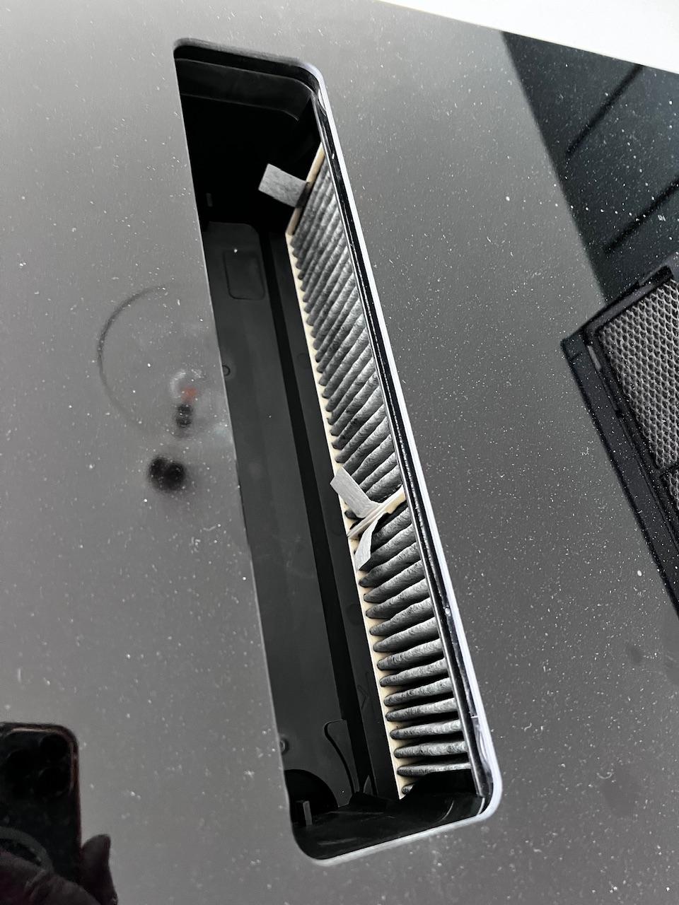

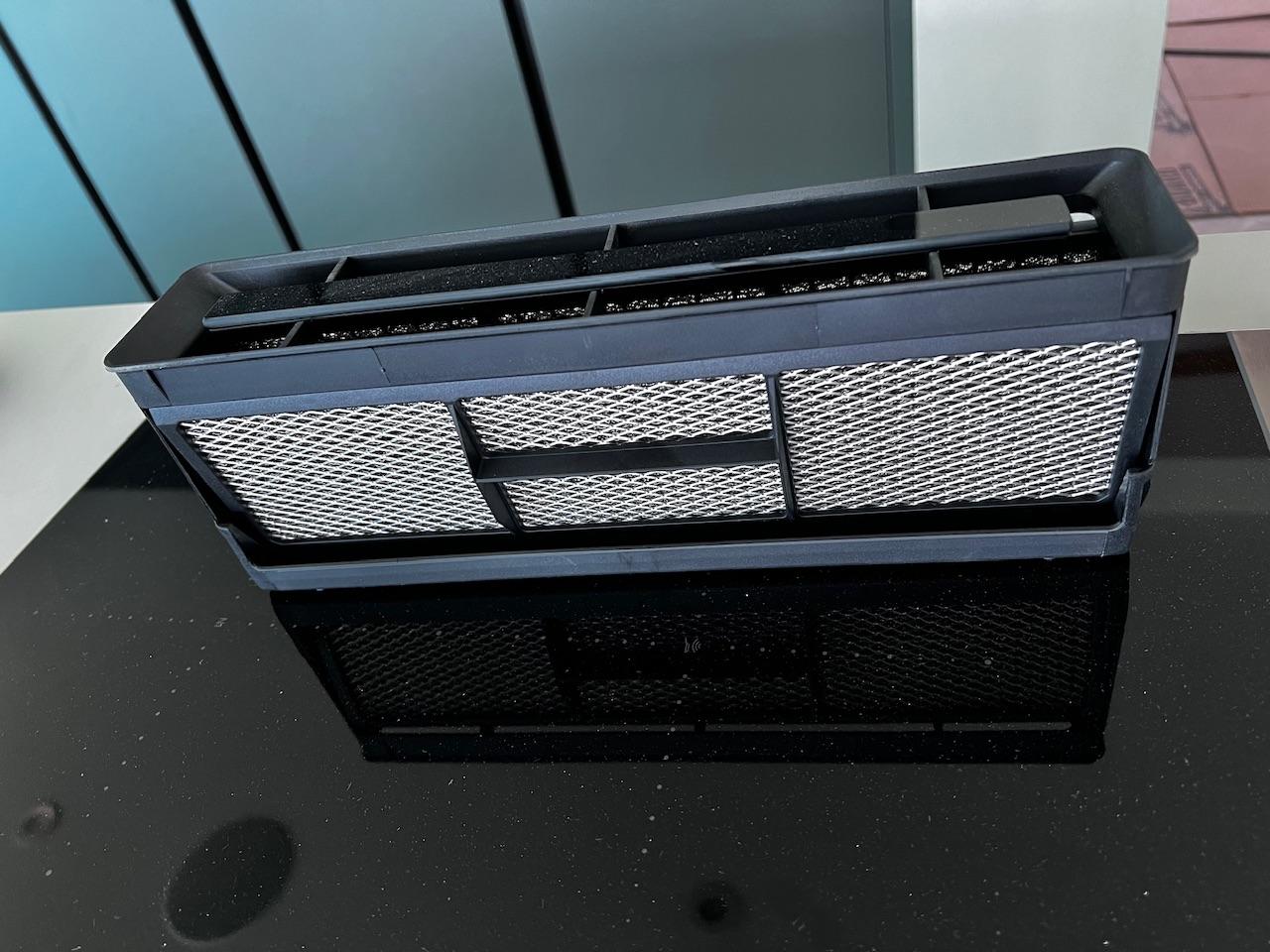

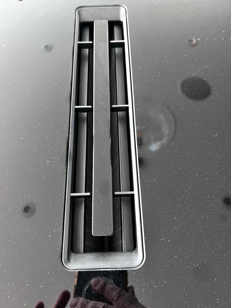

Kelvin Posted April 15, 2024 Posted April 15, 2024 On 13/04/2024 at 14:39, Kelvin said: They are individual but yes easy to get out. There’s also a container underneath the hob to catch any spills. @saveasteading the two removable grease filters are in this caddy. The four replaceable carbon filters are in the second picture with two either side. The third picture shows the grease filter caddy/holder in place. Excuse the dust. 2 1
saveasteading Posted April 15, 2024 Posted April 15, 2024 18 minutes ago, Kelvin said: Excuse the dust. Not a speckle finish option instead of black? Useful pics, thanks. That must be quite noisy fan to attract the air over there when it wants to rise. 1
Kelvin Posted April 15, 2024 Posted April 15, 2024 😂 yes, it’s a speckled finish. It is very effective with steam even at a low speed which is quiet. At full pelt it’s noisy but much the same as a cooker hood. You can configure it to come on automatically or manually. It also runs for a variable period of time after you’ve finished cooking. In the installation manual it mentioned that you can replace the carbon filters with acoustic filters. 1
LnP Posted April 16, 2024 Author Posted April 16, 2024 15 hours ago, Kelvin said: 😂 yes, it’s a speckled finish. It is very effective with steam even at a low speed which is quiet. At full pelt it’s noisy but much the same as a cooker hood. You can configure it to come on automatically or manually. It also runs for a variable period of time after you’ve finished cooking. In the installation manual it mentioned that you can replace the carbon filters with acoustic filters. Very helpful thanks!
Kelvin Posted April 16, 2024 Posted April 16, 2024 6 minutes ago, LnP said: Very helpful thanks! For completeness it extracts to a duct that attaches to the back of the hob and runs down behind and underneath the cabinet. This was a fiddly thing to put together. A bit like the scene from Apollo 13 where they have to make a CO2 filter out of bits that don’t quite fit. The duct doesn’t come with the hob though so you need to buy that separately and they do different types to suit different installations. 3

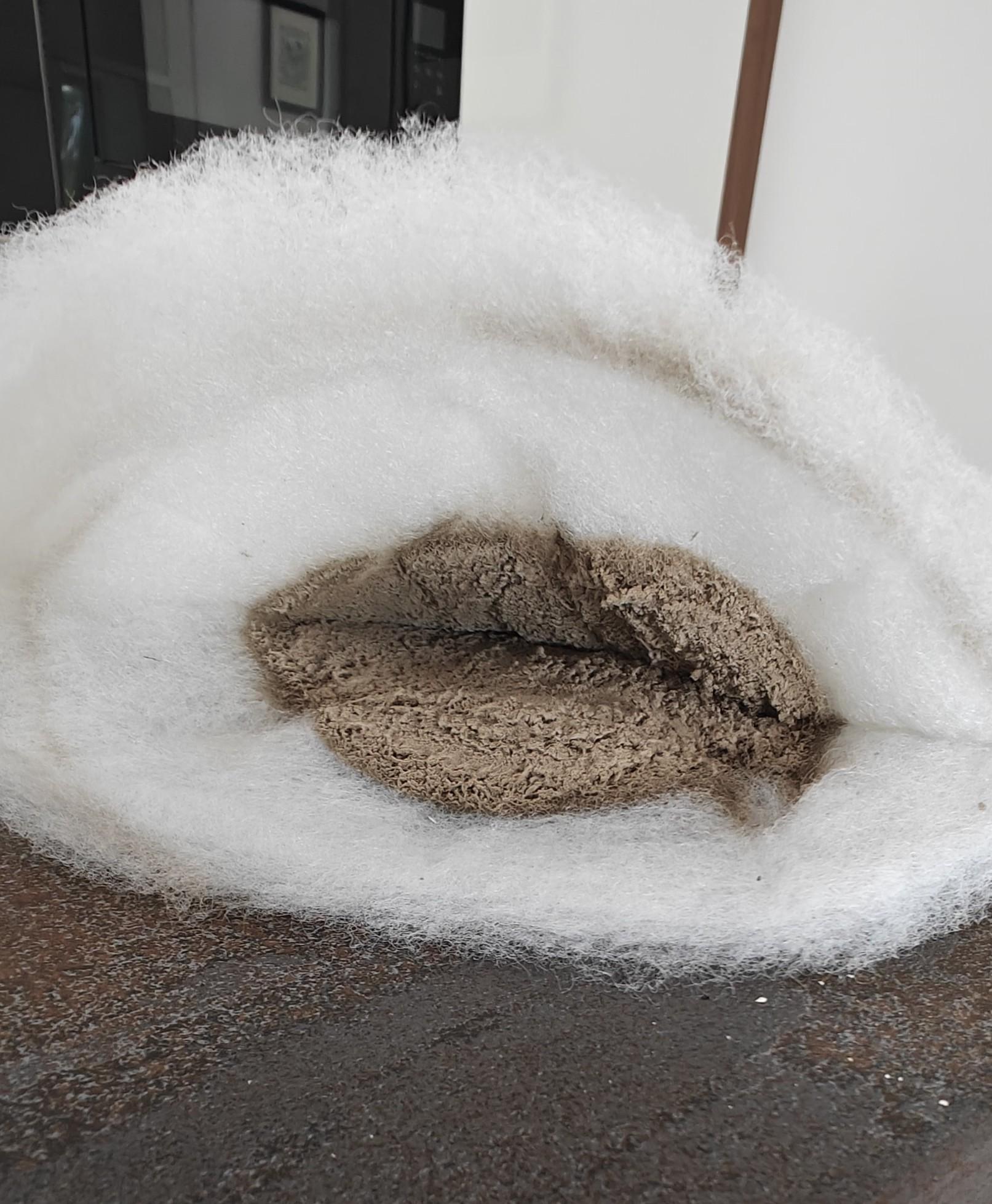

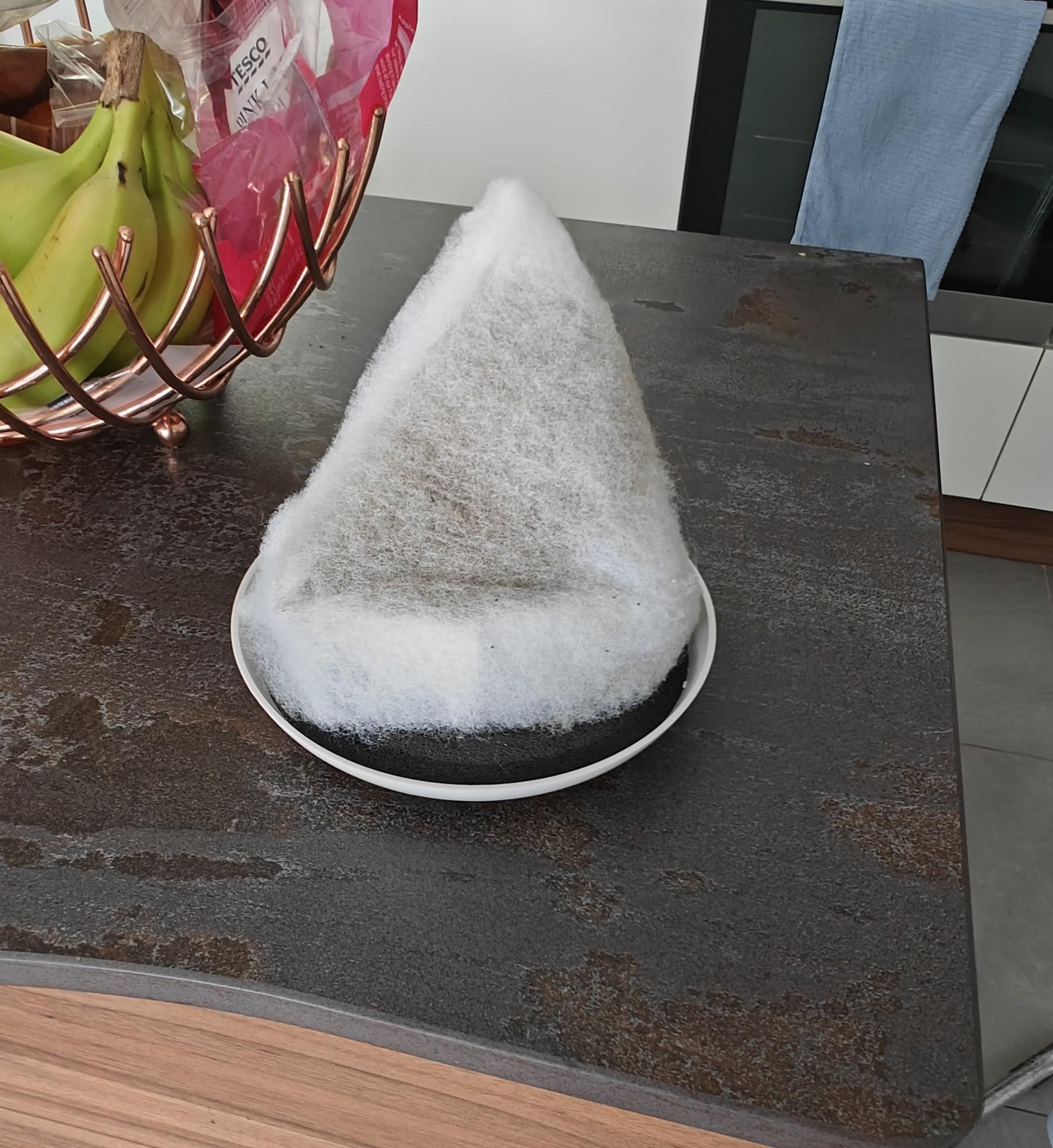

JohnMo Posted July 27, 2024 Posted July 27, 2024 1 hour ago, Renegade105 said: filter lifetime are 1-3 months..so what happens at the end of 1-3 months? Are filters 100% blocked? How would you know if you need to change 1 or 3 months? Would you be happy buying a car with a fuel gauge that says refill at 1-3 months Grease filter goes in dishwasher. Carbon filter goes in the oven to be regenerated. As said before we hardly use the extractor at all and we find zero need except for really smelly stuff. Our kitchen MVHR filter sock (after 6 months installed - top is the outside the duct side, bottom is inside, showing dust ect from the room. 1 hour ago, Renegade105 said: we need to start questioning the norm guys..it all stinks Why do we need to question the norm? Where is your evidence that a normal house (with MVHR or other suitable ventilation system) suffers from poor IAQ. Most houses don't even ventilate correctly and suffer mould, which I suspect is way more hazardous to health - than an extract on recirculation with decent grease and carbon filter, positioned at the correct height for effective performance, so you don't need to run the fan at full speed. Everyone is free to do what ever they feel is correct for them. Personally think everything is getting OOT, I have said my view, so will leave it there.
