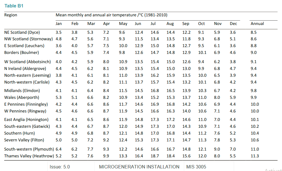

Nick Laslett Posted March 27, 2024 Share Posted March 27, 2024 (edited) 10 hours ago, markocosic said: In a UK climate in a house that's regularly occupied I probably wouldn't even both with an antifreeze valve. Just let it thermosyphon in the event of a power cut, and rely on the house being warm enough to avoid it freezing up. In all other scenarios the circulator pump is running or the internal trace heating is active. If it ever gets cold enough to freeze! @markocosic, thank you for posting this. I have my ASHP on the wall and the pipe going down vertical 1m into the ground and coming up vertical into the house and through the insulated slab. When I looked at Intatec’s instructions for installing their anti-freeze valve, I could not see how it would work, as it wanted the valve to be at the lowest point in the circuit. I wasn’t going to bother with putting glycol in the system. I feel a lot better about my setup after reading your post. The average lowest temp according to Met Office where I live is -2°. Edited March 27, 2024 by Nick Laslett Link to comment Share on other sites More sharing options...

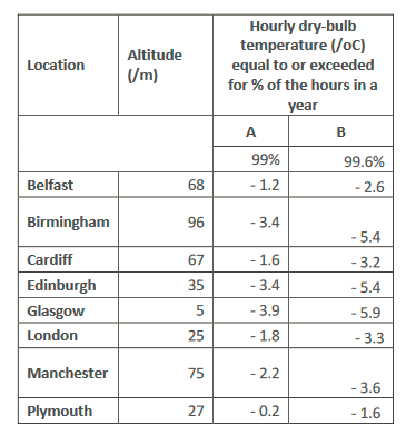

sharpener Posted March 27, 2024 Share Posted March 27, 2024 2 hours ago, Nick Laslett said: The average lowest temp according to Met Office where I live is -2°. It's not the average you need to worry about. For example the mean February figure for Plymouth is +6.2C However to guarantee adequate HP performance the figure I need to use (from CIBSE Guide A) is -0.2C But for frost protection purposes the lowest temp in Plymouth in the last 10 years is -4.9C. And here on a tidal estuary just 20 miles away there was lying snow for a week in ?2009 and the river was iced over. Hence I would want to have protection down to -5C, and the Fernox HP-05 (or forthcoming Hydratech equivalent) seems well suited to this. Link to comment Share on other sites More sharing options...
